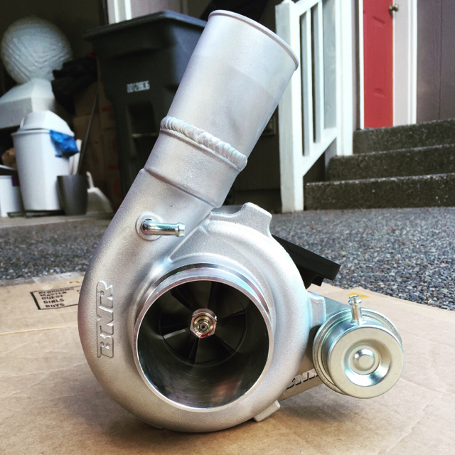

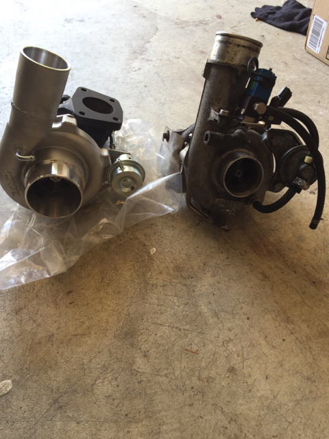

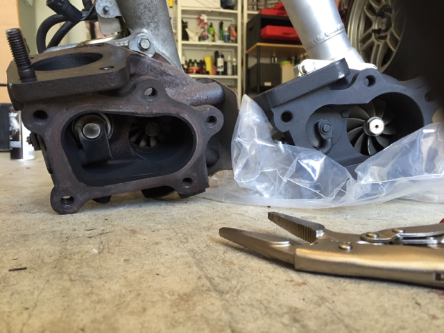

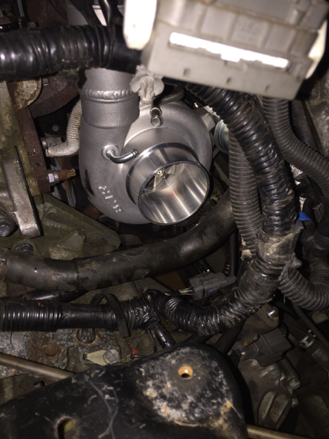

Got my bnr s4 on monday and started removing stuff that night. Tuesday morning i got into removing the dp and mani studs and removing the egr and all the wonderful stuff that keeps the turbo in place and all the oil and coolant lines.
I must say the overall process is pretty straight forward but it is time consuming. I had did this install solo for 99% of it, i had my gf hold the turbo which i connected the support bracket to it. Once i got that done i started to put all the studs back in place. I had to loosing some of the ex. Mani studs to get the dp studs all lined up but after that i worked on all the coolant lines and oil drain and oil feed. One thing i would like to point out is that you should probably tighten the coolant line bolts b4 installing the turbo as without the right tools u may have to remove it just to tighten those down. Lucky for me i have flex head and other kool little toys. I also extended the heater hose as its a must for clearance even with my 3" intake.

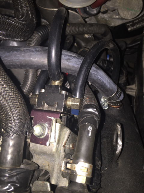

I took the time once the turbo stuff was done to find and mount a new home for my cobb ebcs. Ill post a picture of its location as i think it worked out well. Also had to put the ecu on the fuse cover for now. Croksport has a nice solution but its pricey at $170.
First start up went well with no leaks at all. So its deff worth it to take ur time and make sure everything is done right. I wanna say this install took me a good 7 hours but again i was doing it solo in my garage and i like to be detailed about my work.
For those wondering rob finkle is tuning this beast as he has been my good friend and tuner for the past 2+ years @rfinkle2;
Any other questions feel free to ask. I will post results as they happen.

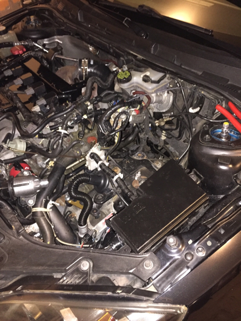

Have you considered getting smaller battery like a 51R battery so the ECU can fit inside the stock battery box.
sent from my Nexus 6P
I dont like the 51r set up. I like c.s battery box but idk about paying $170 for it. I can make the ecu fit into the front of the battery box by cutting off the 4 tabs on the sides but then i would never be able to mount it again which i feel would be a bad move.
I also see i can fit it right in front of the battery box but it puts it so damn close to my maf wires i feel over time i may have some tub issue there. Any thoughts?
I also see i can fit it right in front of the battery box but it puts it so damn close to my maf wires i feel over time i may have some rub issue there. Any thoughts?
What concerns do you have with the 51R setup?
As i have around same CCA as my stock battery.
You could try to fit in the front, but make sure to protect your wires with electrical tape or something to protect it from rubbing
I have seen people on fb complain about reliability issues with it. And my battery is maybe a year old or so and is in good shape. I see no need to replace atm. Maybe when its time to replace it i may look at the 51r but then for another $50 i could get the c.s battery box so right back in the same boat.

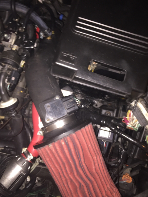

I have a 3" ID silicone intake plus an air box, everything else is in the stock location.

Here they are:

I think bc you have the jbr intake which is silicone, that is way you have the extra wiggle room. also didn't see what turbo u are running. as you see in my pics its a really tight fit. I could maybe trim the coupler to the turbo down a inch but mehh.
Exactly,... that is why I suggested a silicone 3" ID intake.
