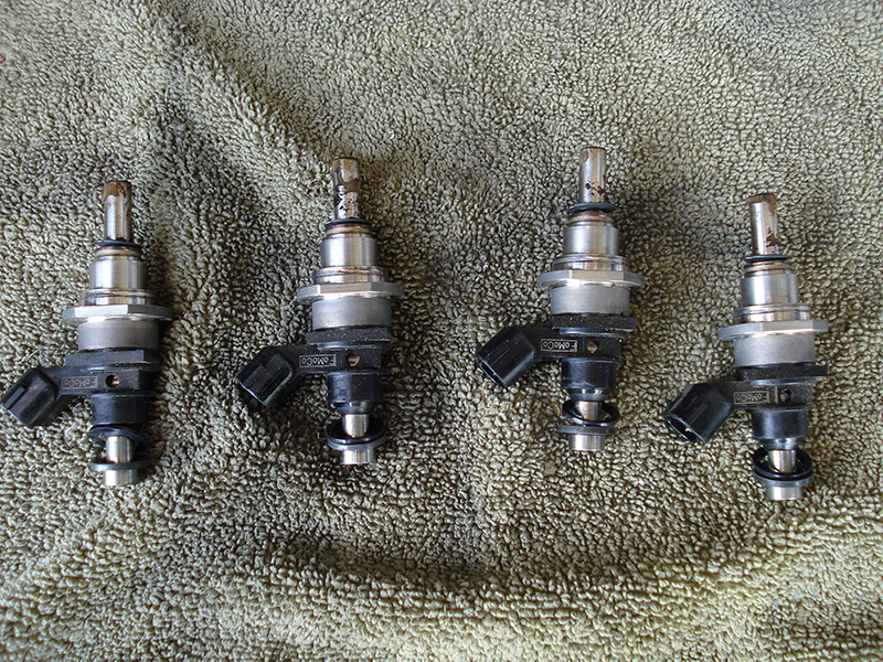

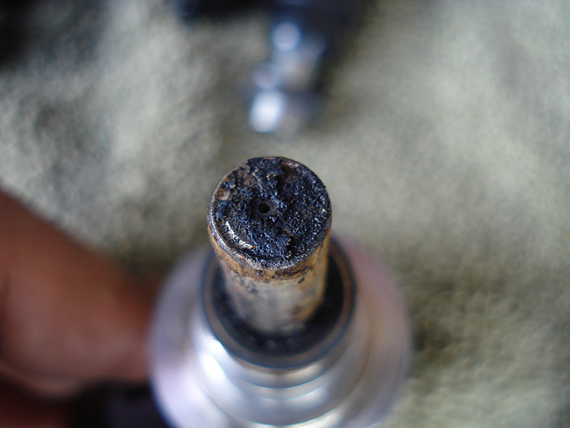

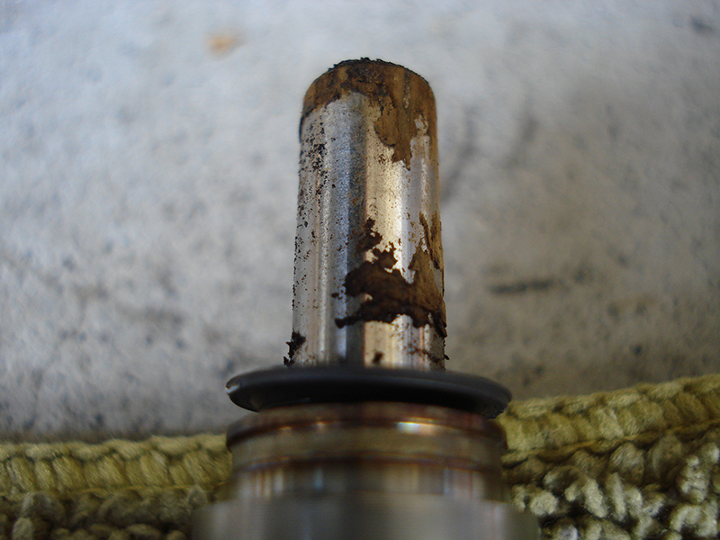

Interesting. I just replaced my injector seals yesterday and had the same observations. I had previously seen consistent counts of knock above 5500 RPM, as well. I had wondered if the stock seals were leaking because I was hearing a louder ticking noise than usual in the past few weeks. I logged a few pulls today and the most knock I saw above 5500 was 2 rows of 0.47 KR.
Here's what my injectors looked like when I pulled them...

No evidence of leaking there either. You have more buildup on the tips than I did, and the shaft stuff looks a little brown which is odd. I didn't have any buildup on the ends, but had some carbon buildup on the sides of the nozzle that easily wiped clean.
Yeah, the injectors cleaned up pretty easily with some gasoline and a rag. I'm not really sure what that brown stuff is either. When cleaning out the injector ports in the head, I didn't really see any of that. It was all black carbon.
