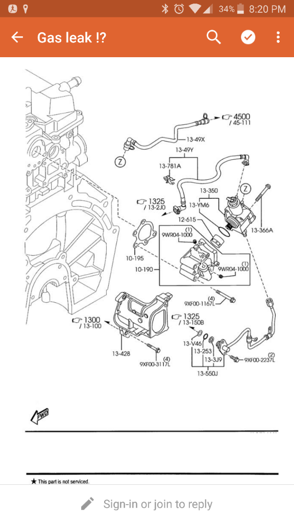

Engine is in. I'm almost complete but I can't find the green plastic piece that the blue fuel line attaches to on the fuel pump. Anyone know a part number?

Does this help?
