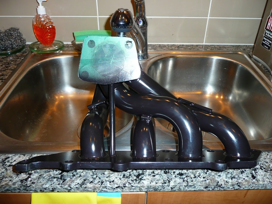

If you have a bar of some sort welded from the turbo flange to the head flange, that would provide a lot of support. Take a look at the Race Roots manifold.
this is what my mani looks like

 Old 03-26-2011, 12:40 PM   #5
bmylez's Avatar
Location: TX
Posts: 3,197   (View Stats)
Thanks: 159
Groans: 31
Oh, dude, that's super reinforced. I couldn't see that thing cracking from weight unless the welds were the shittiest on the planet. If you want to support the turbo a tiny bit more, have a bar welded from the left part of the head flange to the turbo flange. That thing has more bracing than I've seen on a lot of other manifolds I've seen and they don't crack.
