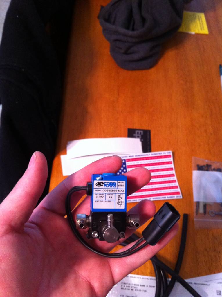

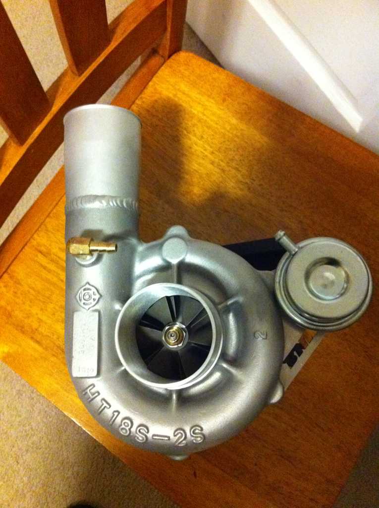

At 105,000 miles on a turbo I have pushed hard it's entire life, The oil seals took a massive dump after tracking at VIR. I have been reluctant to go BT because of tracking the vehicle. I decided to put the BNR3 in and through tuning get more HP and push back the TQ a little.
Anyway here she is... The install is tomorrow so more picks coming. Also purchased a Cobb 3port Boost solenoid

good luck mounting that boost solenoid, I caved in and put it in the stock location because of the short wire, however cant do that with the BNR

So just under six hours and shes in... Very light drive after and smoked like a banshee at first. Clearing the massive amounts of oil out. I need some plugs in her now and @rfinkle2; is sending me a base map. Here are some pics.
Did take the exhaust manifold off and it was a little bitch. Also mounted my Cobb three port which is a nice little piece.

everyone said the S3 is a k04 with 2871 internals, this clearly isnt a k04's housing - whatsthe same, the exhaust side b/c the compressor side is clearly bigger...
That's what I was just trying to figure out.
 Old 01-27-2013, 04:18 PM   #20
@Todd98SE; has spoken with Bryan of BNR and knows the details.
I believe he mentioned that he switches the housing to a Mitsu. model
@mzr0818;, you have mail.
I believe he mentioned that he switches the housing to a Mitsu. model.
Yes it's new internals and a hatachi housing.
AHHH.. Yes Hitachi, not Mitsubishi. Thanks Jeff. I'm getting old and can't remember these things like I used to. LOL
Yes the S3 uses a machined K04 turbine housing and a GT2871 compressor in a larger Hitachi housing. I'm not sure what turbine wheel it uses but it is larger and flows more than the K04 turbine wheel. I believe it also uses a Garrett CHRA but not 100% on that.

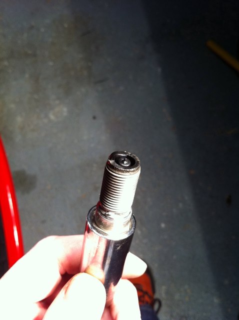

Well I'm done for the day. I was going to drive her to work to do compression/leak down test but it's smoking so bad now it will not make the trip. Plug fouled with in 10 miles.
FML
Here's what the plug looks like.

 Old 01-28-2013, 11:42 AM   #35
kritz's Avatar
Location: Lido Beach,NY
Posts: 7,290   (View Stats)
Rep Power: 8624
Thanks: 17,845
Groans: 95
When and what injector seals do you have Jeff.
Nator is what it does.

I feel your pain. I have the P0304 code. My gas mileage and power took a hug crap on me. With my luck one of my valves is stuck or burned. :-(
