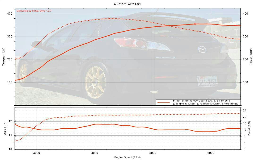

GTX3071R, 100% stock block/head/IM/EM
Tiny whiny Cobb SRI intake, SU TMIC
gas: OMV Super 100 (similar with 94OCT)
24PSI and about 12.5 degrees of timing at redline
Afr around 10.5:1, with IDCs around 100% (99-102%) from about 6100rpm up;
350whp (VD CF1.01.) around 5850rpm, above 340whp from 5500rpm to rev limit (6700 on that map).
Now with the latest map @Lex put together for me I should be above 340whp from 5200 to 6700rpm and peak to about 355whp at 5900-6100rpm (maybe 360, I don't really care now with this long ass flat power curve above 5k), still making 330whp at 6950rpm which still makes me think revving to 7krpm makes some sense when I want to ride the 3rd or 4th gear a bit more (running slightly more load, 0.7AFR leaner AFRs, about one more degree of timing above 6000rpm).
However, because I'm on pump gas with no aux fueling the ambient temp needs to be below like 10C/50F to be able to benefit from all the timing with no interference from the "high BAT no knock" table.
2008 Cosmic Blue Mazda 3MPS
self-Versatuned to 22PSI
