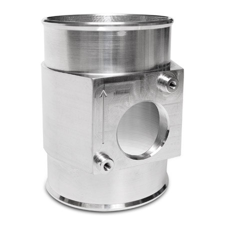

Is this the 3" Subie DENSO MAF housing from ATP that we can use to build our intake?
3" MAF Housing - Billet Aluminum-for DENSO Element : atpturbo.com

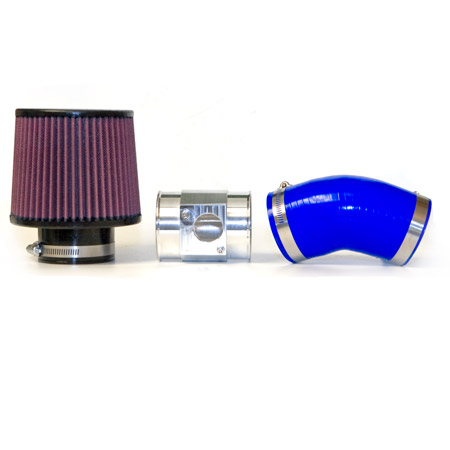

All you really need is a long 45 degree coupler a short length of 3.5" or 4" piping and your MAF housing. Any decent welder should be able to weld on a small fitting so you can reconnect the valve cover port.
any need for an air straightener/velocity stack when going big?
As long as there are no bends immediately before or after the MAF housing you shouldn't have any issues..
