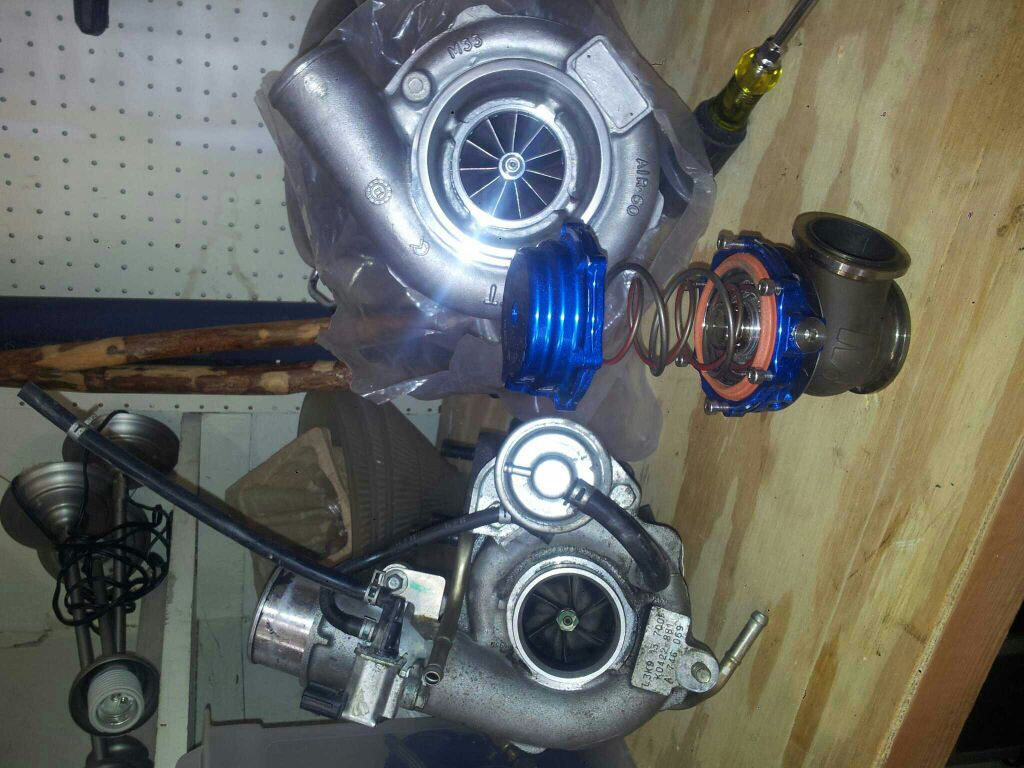

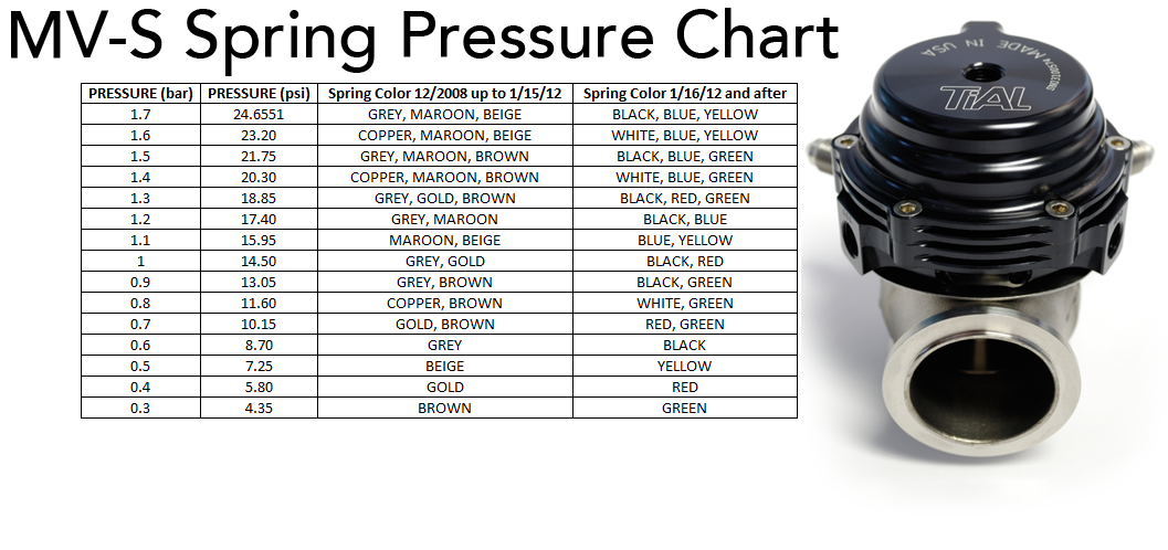

Drove to o'reilly's and just realized I'm still on ethanol. I need to burn it off and switch back to 93 for base tune.
Grabbed some heat wrap, and 3/4'' coolant line because I might have to extend the line that runs near the inlet pipe. Just need a 3/4''-3/4'' barbed nipple.
Also just looked up how to assemble my tial mv-s.
https://youtu.be/qjfJ0P632pc
Freek wants 15psi, so I believe I'm going to use the blue and yellow spring which is 15.9psi according to their website. The only other colors in the package are green and white.

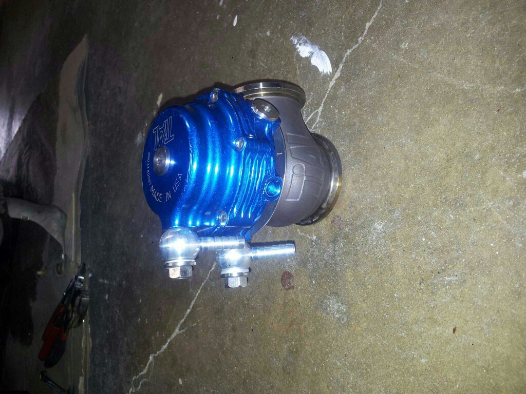

@Justin@Freektune; I just cracked open the wastegate and there was already a black and red spring which is 14.50psi.
You said 15psi in your e-mail, so I was going to put the blue and yellow in for 15.9psi. Your call.

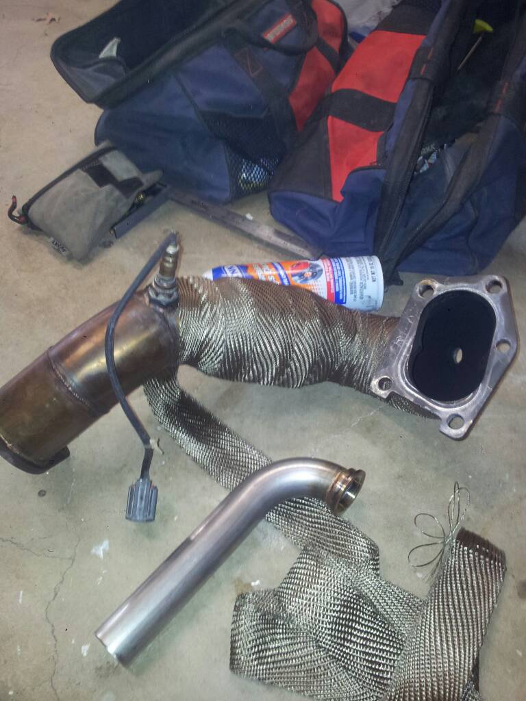

Here's another. Just enough in the 15' roll to cover the CAT and the dump tube but not the whole DP. Fuck it, it's better than it was.

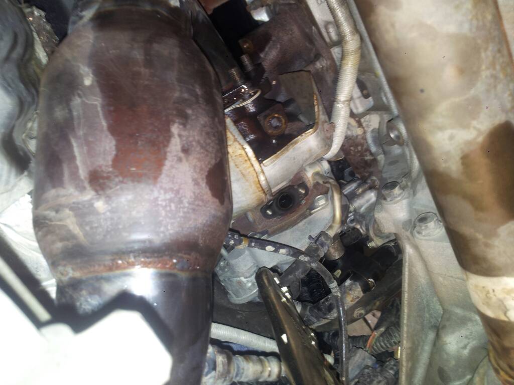

Alright so I'm calling it quits, I'm mentally exhausted. Redline said he'd stop to help, then that he wouldn't be able to until around 5pm.
All I really got done today was removing the k04, and moving the old studs to the new turbo and disconnecting and starting the wrap on the DP. I probably wasted 2.5 hours trying to pull the k04 out the bottom.
Thought about trying to wrap the DP in place, but figured that wouldn't go well so I spent quite a bit of time removing those bolts to get it out.

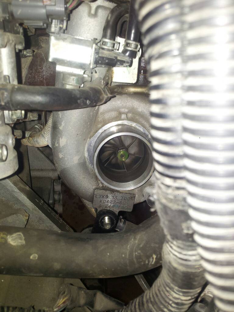

I never get tired of the comparisons.
Thanks @kevdog; for letting me know the EM needs to come out.
In other news I don't see a single stud in the box. Going to try and take out the old ones. Not sure how I missed that.
Looking at the k04, did you pull the coolant feed hard line out with it?
gtx3076 and shit

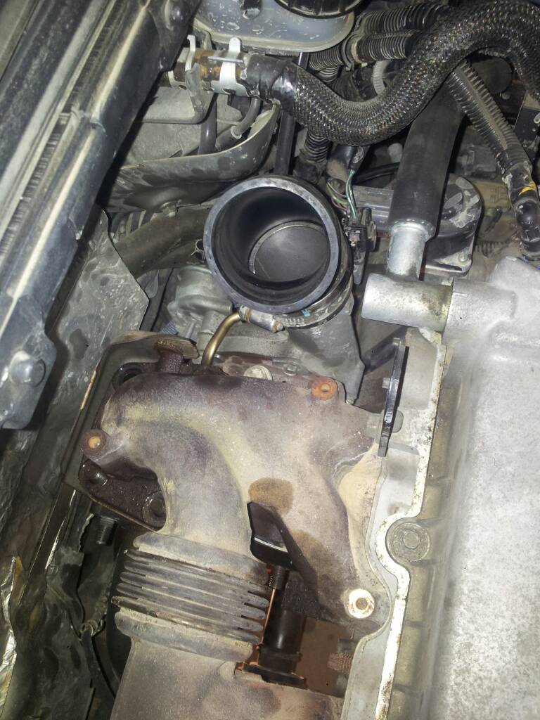

Yeah, probably. No big deal, I'll get it tomorrow. I was just trying to get it out as easily as possible.
I honestly would love input putting this thing back in. I don't find working by myself as enjoyable on a big project like this, but that's what I get for starting it on a Sunday night.
Didn't we have like 7 guys for @jbmazda6; 's downpipe? Even if it takes as long those were some good times.

@Ziggo; can I run the ewg like this? Using the top side air port instead if the top center air port to go to port 2 on my ebcs?
The oil drain line cuts across the top and I think I'm going to abandon the 90* piping and install directly to the hotside.
 Old 04-22-2015, 11:56 AM   #32
NCspecV81's Avatar
Posts: 2,867   (View Stats)
Thanks: 1,221
Only hose I run to mine is on the bottom side port. You can cap the top side port and leave the top one completely open if you want. or whatever works.
I've read that but not sure what is best for reliability and tuneability. I have a couple diagrams cobbs recircs back to the ebcs others show venting to air. Just not sur is best for my setup.
 Old 04-22-2015, 12:05 PM   #35
NCspecV81's Avatar
Thanks: 1,221
I've had it setup both ways. I've had the ECBS going from port 1 to the top port of the EWG and I've had port 1 vta and the EWG vta. Both worked identically for me.

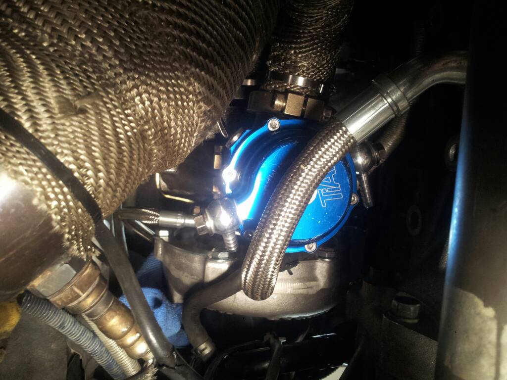

Progress is slow. Clocked top half of ewg so side port would clear. Had to remove oil drain from turbo to get vband on. DP is in place but not bolted. Have to tighten vband but it's in a tight spot and reattach oil drain. Otherwise, it'll clear without 90* elbow so that's nice. Then run all my vacuum lines. Need to go pick up a T fitting for 7/32" tubing.

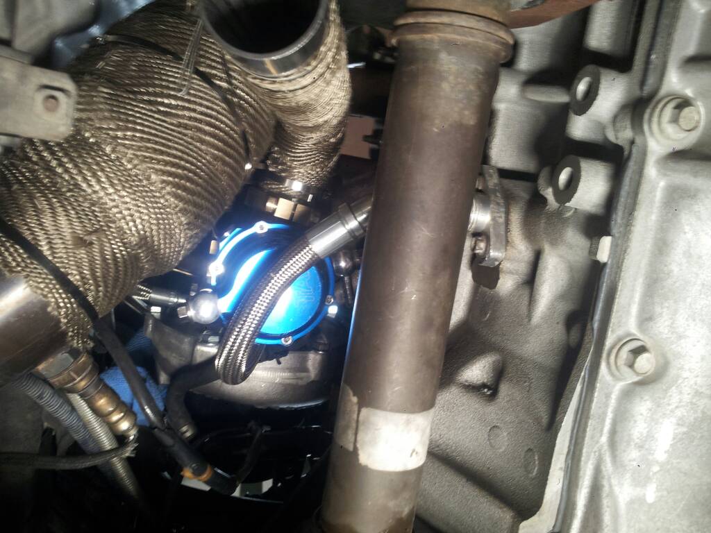

I hate life right now.
Apparently I ordered a 4''-3'' coupler, instead of a 4''-3.5''...I can't even put the intake on...

Call topspeedpro1 in carrollton tomorrow see if they have any
