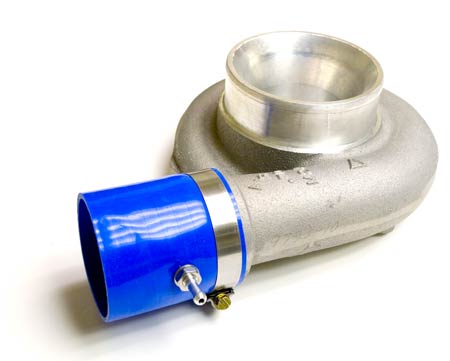

Since my turbo wasn't tapped for a boost source, I was going to buy a Quick Tap like this:

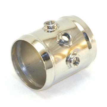

I also picked up one of these, that I was going to play with later on... My tuner liked it better and we decided to use it instead:

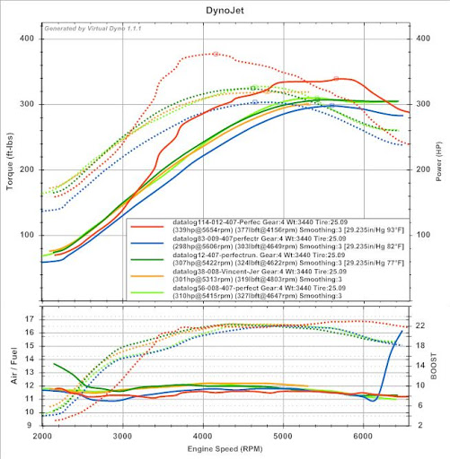

Dyno Sheet:
I dyno'd on a Dynapak. The numbers might appear low compared to other people, but it's consistent with the other MS3's in my area.
Yellow boxes: This number represents my last dyno in January of this year. The differences between then and now: Much colder weather (I'm in Canadia after all), stock exhaust manifold, stock turbo. Running a Christian tune @ 20 psi.
Green boxes: Same as above, except with 3071r @ 22 psi, Steedspeed exhaust manifold. Hot humid day.
I'm making crazy torque (My tuner is worried about my pistons), but I was secretly hoping for a bit more power. My tuner thinks my stock exhaust might be holding me back. So I definitely have some room for improvement. I also don't like my intake setup. 4" -> 3" -> 2.5 seems kinda power robbing. Although the exhaust is the more pressing matter.

who is tuning your car? Your making mad tq but you are quite low on hp kind sir. Not trying to rain on your parade, maybe the dyno there reads really low on hp??
most guys with 3071 18-22 psi are making 350+ whp...shit Driver311 made 300 whp @ 13 psi
Also before spending money of larger maf, keep in mind...guys making below 400 whp, but in the 350-390 range-Brian,Lenny,Driver311,others...are using a stock size maf via Cobb intake or SURE intake ect. I think stock size maf as long as its calibrated correctly and your car is tuned correctly should be fine, but if it helps with peace of mind, go for it.
I do agree however the stock cbe is holding you back....I dont know if its holding 30-50 more whp back lol...but it should open things up quite a bit by going with aftermarket 3" cbe.
Bottom line either the dyno reads really low on hp, or you need a different tune, i dont want to judge your tuner or say anything negative, but 324 whp on a 22 psi 3071, something is up.
You are making mad tq though.....and if your happy thats really all that matters..no need to impress anyone but yourself. I would suggest your tuner calling up Tim Bailey @Cobb Tuning Surgeline if you ever want to properly run a 3port. He has figured it out, and that is how Iam going to run my 3071. But mbc is simple and it works, enough said, just a FYI Nice build btw.
Rain welcome... Trust me, I was expecting at least 350 hp, so I was a little disappointed in the raw numbers. I'm happy with how the car performs, just to get that out of the way... I'd still like higher numbers though.
I'm not sure why my torque numbers are so insane... Maybe a byproduct of a restricted exhaust? I'm only guessing here. I do know that as I free up restriction and shift my power band over to the right a little, I should create a higher peak hp. But like you said, I don't see that buying me 50 hp...
The car was tuned by APH (Advance Powerhouse) in Toronto. The tuner is very knowledgable, but new to Mazdaspeed's. He was trained by Christian from Cobb and honestly, I'm very impressed with the power band he tuned. Very nice guy and very knowledgable.
You're probably right, but I think once I look at all other possible options, I can't ignore the obvious intake restrictions. Although, another shop that tunes hot rods (so I don't know how applicable their information is, but I'll repeat it anyway) said that on newer turbo applications, you want the restriction to be the intake side and not the exhaust side... In the older days, it was the opposite. So keeping that in mind, I might just keep it the way it is, or maybe simply get rid of that 2.5" intake and go 3" all the way up to the 4" inlet.
I actually ran to another dyno the day after to compare the dyno numbers. This dynapack that I ran at, had nearly the exact same numbers as a dynajet. After a 1 hour long drive of spirited driving in hot humid weather (def a bit more hot/humid than the dynapack day shown above), I only got about 10 minutes to cool the car before it went on. I hit 305hp! I waited 10 minutes with the car off this time and gained 10 hp and 20 tq, 315/347-ish. I couldn't break the 320 mark... But it was close enough to the dynapack that shows me that they were calibrated the same. The dynajet had poor air flow though.
I think I'm going to get my exhaust put in and take it from there... I'm going to contact Tim on my tuner's behalf and see what can be done.. I really want a 3-port setup...

- Added CP-E CBE w/ resonator. Tune needs to be tweaked a little, not holding 22 psi. I dyno'd again and gained about 4 hp on my best run (329whp) and torque is now at 404 wtq. Fobio's helping me out with an updated tune... He noticed a few areas we could tweak to get some more power. Plus I'm going back to 3-port mode on my EBC.
We had a dyno day with a bunch of local MS3's. I wanted to know how my car compared to other local guys on the same dyno... So basically:
Stock 2010 MS3: 215 whp / 244 wtq
2nd Gen w/ Corksport SRI w/ TIP: 232 whp, 251 wtq
Average 1st Gen w/ stage2 tune (DP or RP) ~270 whp

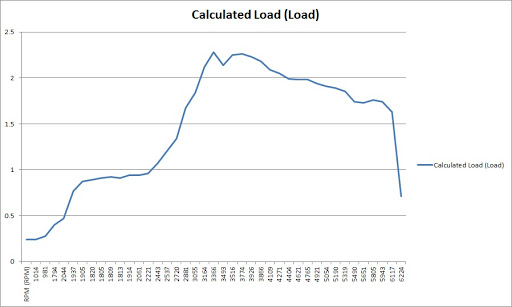

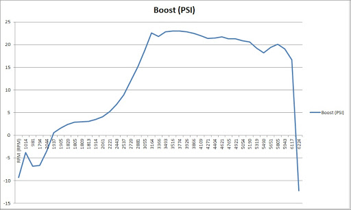

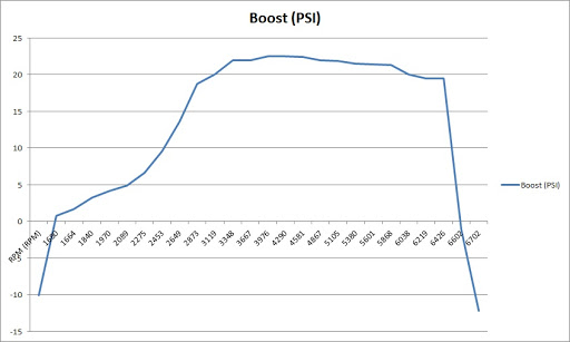

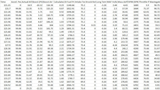

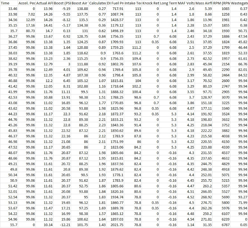

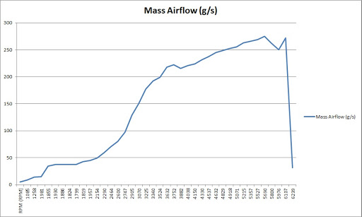

Some before and after logs from tuning. In the current tune, there's a lean spot of ~12AFR around 4800rpm, eventho 11.8 AFR is targetted and spot on in other parts of the rpm range.
This is the dyno log of the custom base map we started off with, but w/ 2-port EBCS:
Cliff's note: map from dyno tune [not by me], maxed out wastegate, slow CL/OL transition, safe AFR but not smooth, boost curve could use some work...274g/s.
I then made a base map to expose [at/just above] wastegate spring pressure and to smooth things out. After a couple days and about 6 sets of logs, this is where we are at. This is also with an EBCS in 3-port...we made it work, and you can see the low and steady WGDC logged. Street tuned, 292g/s.
We're currently still working to ramp up boost onset and smooth out AFR. Since a new intake is coming, we'll hold off on a fresh MAF calc until that's in. We're also looking to get meth in the along with an OCC. A cleaning of the FMIC is also in order. Meth is also going in this wknd...but I want to sort out the lean spot regardless.

We are both figuring that the lean spot is due to a leak after MAF but before turbo, as the turbo seems to be sucking in unmetered air and causing the lean out. Once we can confirm this thru logging, we'll move on to the intake and meth shortly.

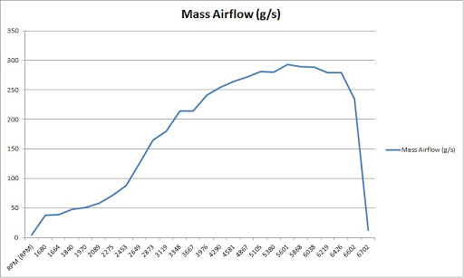

-cj- went on a rampage with the clamps and even lock-tited the bitches...found intake leak and hot-pipe leak...
then he went on to take on a BMW M6...not some Mazda6...hit 338g/s...can't wait to hit the dyno!

just a little update.
tuning, moving over to v102 and more boost based tuning, has yielded about +40whp/+70wtrq...the number itself isn't what we're basing this on, but more the difference...
-- Mario Andretti --
