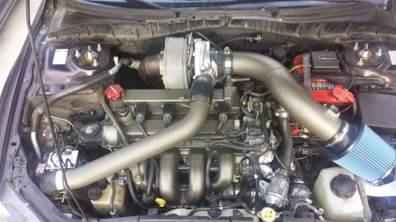

I bought
2 of these Banjo Fitting Kit, (1) Banjo fitting 14mm hole (for 14mm bolt) with -6 AN male flare : atpturbo.com
2 of these Steel braided Hose, -6 AN, for coolant or oil use, 6 inches long : atpturbo.com
and 2 of these Fitting, 3/8" pushlock barb to 6AN Flare, Male to Male, Straight Adapter : atpturbo.com
hope those work. The one on top of the turbo I would make 12 in with a 45 degree angle though aso the silicone doesnt sit on the hot turbo.
oh and ive used the high temp silicone yourtalking about. everything Ive tried has leaked and roasted eventually. I usually just cut the tip and reattach but I finally got fustrated enough to buy this stuff

Hmm. Sorry about that. My lines cost about $35 from ATP and then a few adapter fittings on the side. Probably have about $70 in mine. I used the normal metric to 6an nipples on the turbo then 45 degree swivel 6an fittings to short sections of 6an line one end being a 90 degree adapter and then a 6an to barb fitting. The less you have ATP do, the cheaper it is. I needed the extra 45 swivels because my new arrangement is clocked to clear the T4 housing.
You can see them in these two photos.

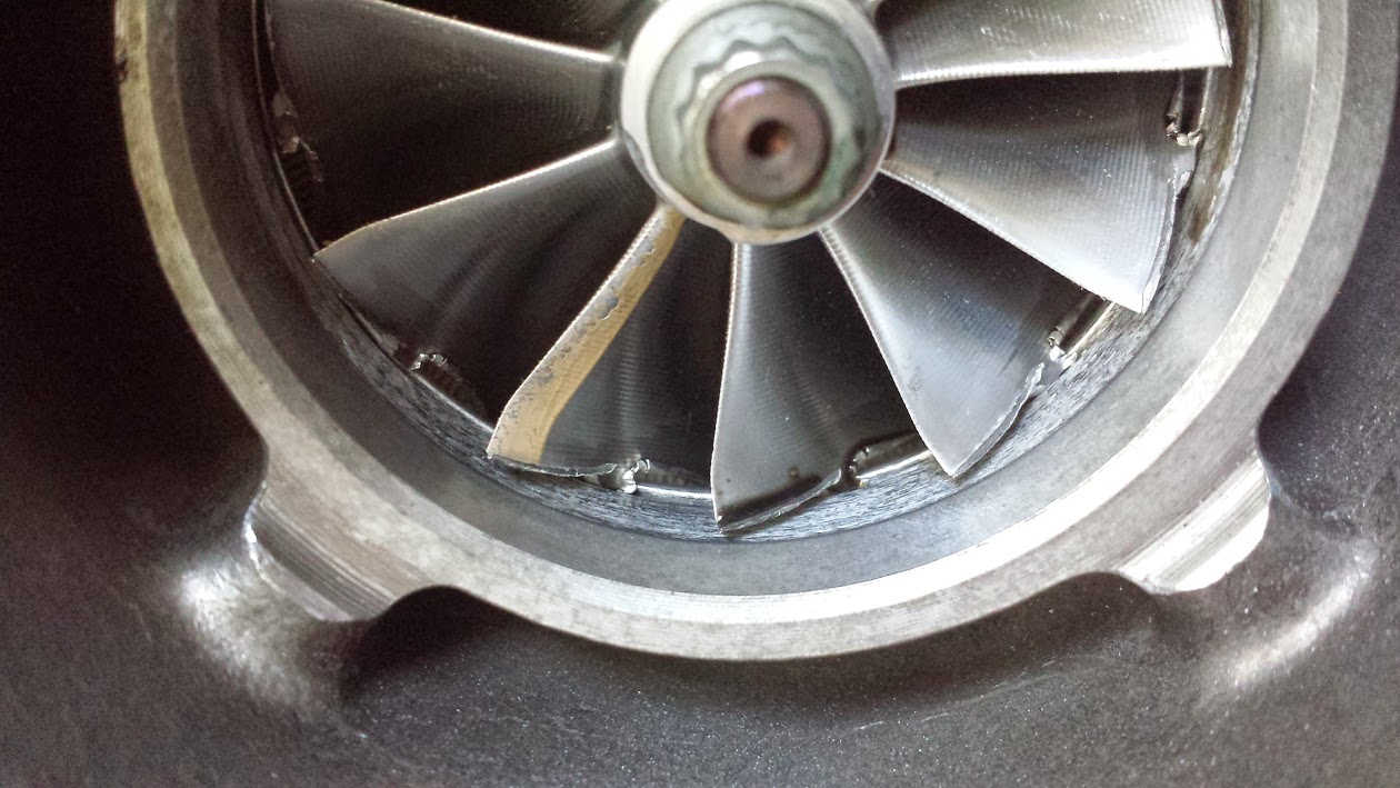

Turbo died, have another on order, oh well

why?
No freaking idea, was boosting fine saturday, sunday took off on the freeway, tried to pass someone and no boost. heard grinding, turned back around to go home, about 3 miles and heard blades scraping the whole way. took the intake off and supper amounts of play, like a half inch of play. so blades curled from contacting the housing. exhaust housing side did not contact. took it off and oil came out of the outlet to the intercooler.
So plan is, drain oil, take intercooler off for inspection and clean, clean all the piping, sigh take of intake manifold and inspect and clean. check oilfeed line to make sure its not clogged, and then install new turbo when it gets here.
going with a GTX 3071 or GXT3067 not sure yet, I havent officially bought it yet.

Originally Posted by unijabnx2000 View Post
Since this seems to be the second turbo to eat itself... think its time to investigate?
3 years apart, don't think they are related personally.
Now after tearing it all apart I have come to the conclusion thats it's my fault really, I drive this as a daily and for having fun and its been super reliable with minor issues.
So what did I find? All the lower exhaust manifold nuts were loose and one was only held in because the wastegate was in the way. Also my intake mani bolts were not as tight as they could have been. My intake filter has a small hole. So I think I overworked this turbo to death, it was spooling a little slow lol. 25PSI at 3900 rpm.
I also found 3 small cracks inside the turbine housing, 2 where the chra is inserted into it and one on the divider. ATP seems to think its ok, but once I get some more funding I'm going to switch it out. Anyways, new pics after sprucing THE CAR A LITTLE
Do you have a vacuum line from your valve cover to intake manifold?
No why?

nice pipe.
crazyp (06-12-2014)
Reading this post while not fully liquored is bumming me out. I've had some boost leaks for a couple years (cut me some slack, I had to tcob, cpa exams, etc), but lately the girl has been hurting. I've been going easy on her ever since the rebuild 2 years ago (despite only a 2% difference across all 4 post rebuild).
So, she almost died on the fucking highway the other day under moderate throttle, felt like limp mode. I pulled the codes yesterday... threw 2178, 2188, and our old friend 0335.
The leaks had me rich at idle, which I knew, and due to (enter bs excuse here), I just added fuel at idle as necessary to pass inspection. I had zeroed out the maf at early volts per Ziggy et al, and hadn't seen the P0335 in ages. But she almost went down the other day... and I have new plugs coming, and an oil change and fluid change on the way.
So I guess if I were you guys I'd say 'finish your long over-do tune up homo, fix all your boost leaks, recalibrate maf, and stfu.' I may be out of touch, but I get it. guh, nigga I don't have time for car problems. I'm just paranoid, and reading this, I'm like "my turbo is probably shot too."
EDIT: Have been getting on it a few times lately.. turbo lag is like a 35R with ADD... I think boost leaks would just be overpowered, unless some sniper has been putting 50 Cal sniper shots into my engine bay. But wtf do I know. @crazyp; @jmhinkle; @DeezNuts; HAHAHA I didn't know deeznuts was a user name. That was supposed to be a joke. Feel free to chime in, after watching the first 13 secs of my vid: https://www.youtube.com/watch?v=3VuEPH_6Lyk

@dougefresh_ how many miles have you put on your topmount? I know I've put about 40k, so not to bad I think
 Old 06-18-2014, 07:30 PM   #465
dougefresh_'s Avatar
Join Date: Jul 2009
Location: South Florida
Posts: 4,489   (View Stats)
Thanks: 9,578
That's a good question. I only have 45K miles on my car. I think maybe 10-15K? I just got some new plugs because I was thinking it was near 15K.
