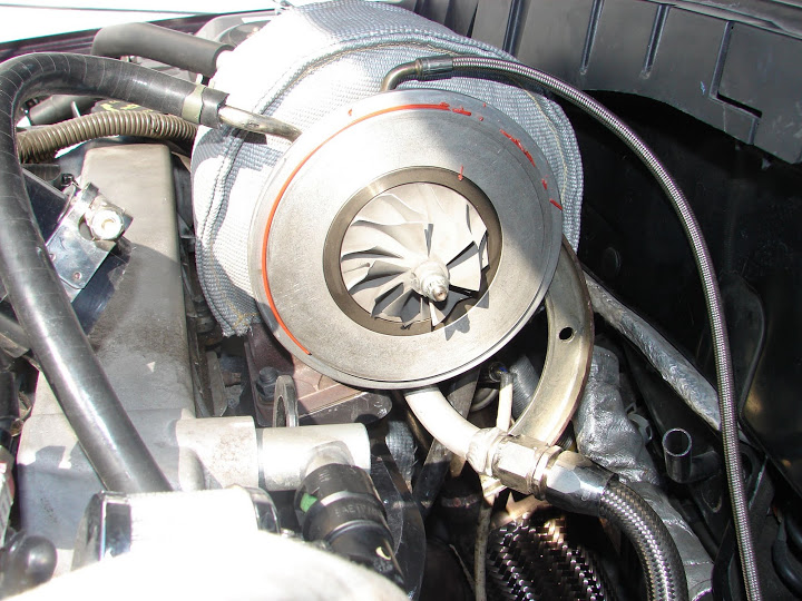

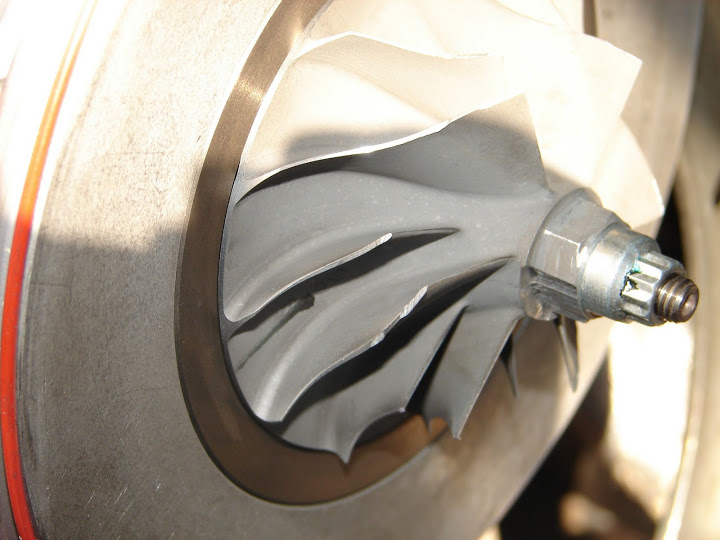

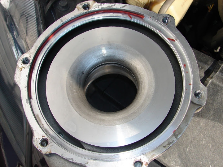

Just throwing this out there - was the compressor housing, the exhaust housing or the CHRA loose with respect to one another? With engine movement and all the tugging on the exhaust and intake side, if any of the housings were just a little loose they could have been pulled towards the spinning turbo and caused some damage.
For some reason this sounds the most reasonable to me.
Right before this happened like I said before I stopped at a gas station. While exiting I bottomed out really bad(really really bad) on my front bumper because the stupid angle was so steep. I wonder if the intercooler piping jostled the turbo enough to tweak it.
as far as metal being sucked in there is no way I dont think. None of the blades were chipped or broken just wore down.
Its ok though the wife is freaking out not me, she asked me how much a turbo cost I told here less than the driveway cost to get poured lol (2650)

Fine metal particles will probably pass through the motor without issue. It's the bigger chunks that can cause damage. Glad they're not chipped.
IC piping shouldn't jostle the turbo... cause there are silicone couplers that will eat up the slack. Not sure.... sucks nonetheless.
If the pipes butt against each other and there isn't enough "silicone" in there then it can happen. With the tolerances in the turbo being so tight even a small tweak can cause it to impact.
OP, try and brace the IC piping to the IM - kind of like in the COBB kits.

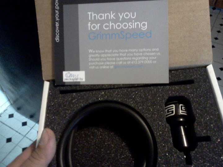

BTW I got a present in the mail today FML cant even use it

well damn something happened to my turbo. dont know when it happened but all of a sudden I couldnt get any boost and my turbo sounded like shit scraping. Took the chra off and this is what I found
Where would i order that crap and the blades worry me as well as the slight scarring.
damn
I was read though this thread its very interested in. sorry to hear about that but your not the first person who had that problem look at The next crazy all out build he had the same problem with the turbo blades look in like that..
