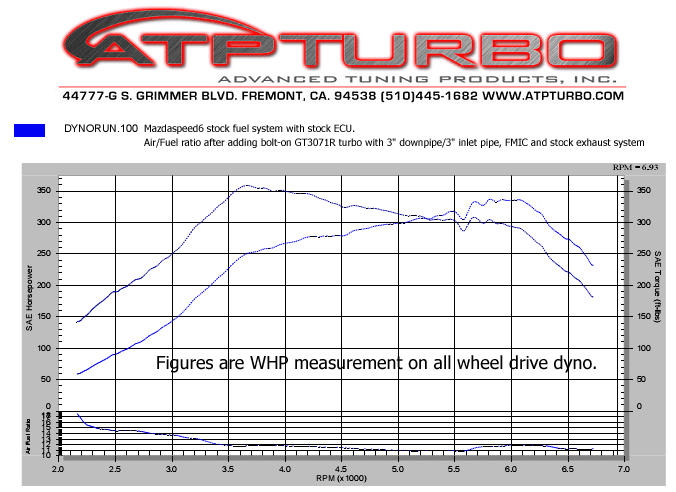

http://www.atpturbo.com/root/release...eed6_dyno1.gif
For those that posted good questions. I stuck with the stock MAF which should eliminate having to do the MAF scaling (didn't change diameter so shouldn't need to scale). I also stayed with the stock ecu based on the results from ATP (good or bad idea I don't know). So, what mods are needed as a minimal to fix my problems? Also, is the no boost issue a seperate issue from the A/F ratio?
Please try to keep this thread short (keeping it easy to search for others) by posting only relevant comments or questions.
By the way, I didn't think that forums were meant to be money making machines.

Smoogs12,
Looking at the data from ATP, the A/F ratio stays below 12:1 after 3500 (11:1 after 5000). I'm not too concerned about high rpms because my wife never takes it above 4000. If I need to do further mods I can drive it (to keep the rpms low) until I get the mods.

Originally Posted by 48-f1 View Post
Smoogs12,
So why did you come here, ask for help, get recommendations and warnings as to what will happen if you keep your current setup.... And then ignore them?
