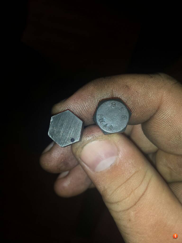

For anyone considering this, you may consider placing alignment marks on the turbo before disassemble.
Another note, with my ATP kit from edge, apparently one of the bolts that hold the bracket to the turbo has a flatter head than the rest. I didn't know this when I put it back together. This bolt goes on the top so the stock oil feed line has clearance. If you don't use this the bolt for the oil feed will be crooked and not fit.
