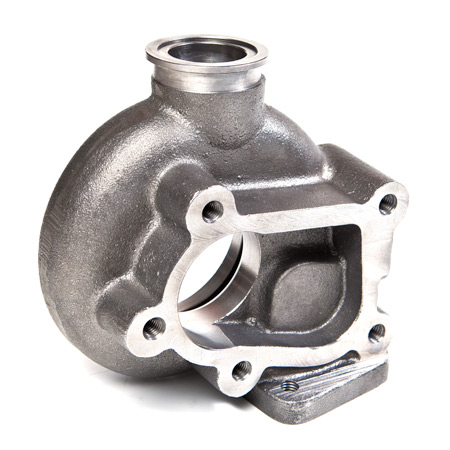

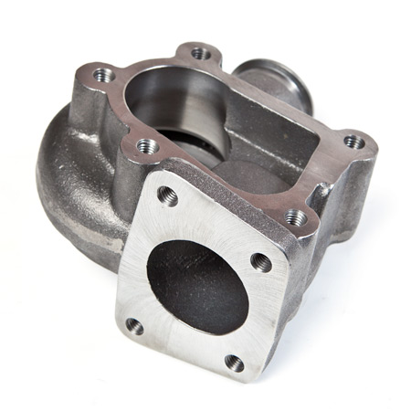

Or use this ewg housing:
Mazda inlet, mazda outlet.
It's all about having options IMO.
