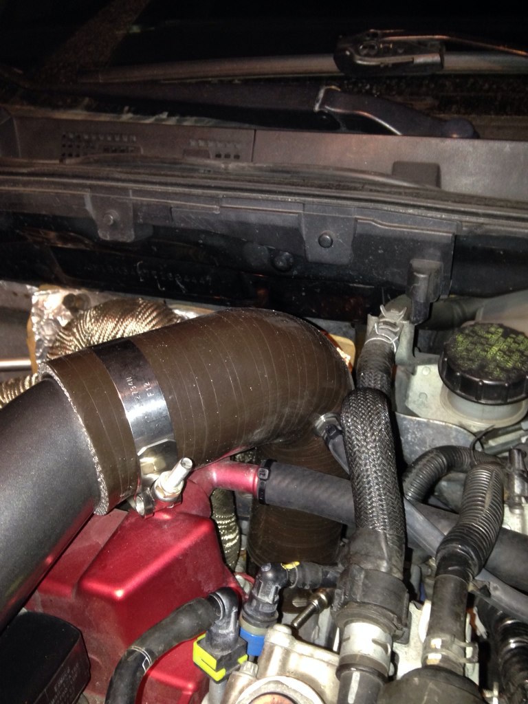

Removes the need to add an extension to reach the GT30 turbo's. Less clamps is better.

This will prevent having to piece together a joiner to reach the lower GT30 turbo's

Thats a good find man. Adding this to the list of things to get done for the spring. I got way too many clamps going on above the turbo.

I've been looking all over for something like this to prevent having so many clamps above the turbo. I'm new to the BT group or will be soon, didn't see rfinkle2's thread. Link?

Came in today. Will have to be trimmed to fit.

Side note, I just ordered one to go from my GTX3071 to the CPE FMIC kit. Hopefully the guy ships quickly.

Just installed mine over the weekend, had to cut 6" off. Should have only cut off 5.5" though.

Shipped quickly IIRC
This definitely they way to go if you going GT30, avoids having to use two additional clamps and an extension.

Worked great just trimmed it some, thanks 08cosmic3

Mine worked great also. I trimmed both ends (big end a little and small end a lot). If you're not fond of the brownish color you can get it from the seller directly in black for a little less than double the cost. Honestly the brown is not that noticable in person - I think I'll keep it.
