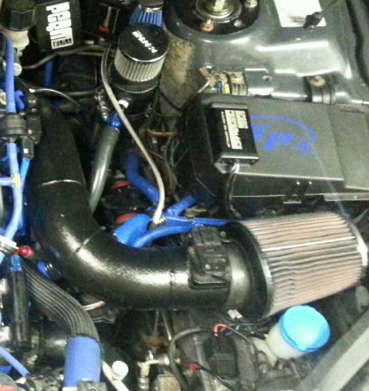

Turbo pics. Just replaced the turbine housing and preclocked the turbo. Probably not perfect but the bolts won't be stuck on like they were getting the t3 housing off so it shouldn't be too hard at all. Anyone know the proper torque for these bolts?
ATP line kit and stuff. Wrote what I'm pretty sure everything is haha. Not sure what the silicone hose is for there... Doesn't fit on my hotside. I measured it at just under 2.5" and the silicone is a 2" silicone bend. I assume the AN hose is the oil drain and the bolt in the bag is a oil restrictor bolt for the feed? Since it didn't come with a hose for that I assume I reuse the stock feed.
And finally my EWG and dumptube. I need to replace the springs but from what I've read it'll be much easier if I get a bar clamp to close it back up so I'll get one before I attempt that.

I've sourced a stock speed6 oil drain line and it's currently getting cut and a 10AN fitting welded on it. Similar to this: PTE 5858 - MS6 Its really happening
I was reaaaaally hoping to stick with what came in the ATP kit since I paid for it... will I be in trouble using stock oil feed plus the banjo bolt the kit came with?
I was planning on tackling the restrictor how I've read for the ATP. There are mixed answers, but the one I am comfortable with after reading them all is to see how things go with the banjo bolt in the kit, and if I'm burning oil, then I'll run a restrictor. I believe too much oil is better than too little. It's the same CHRA as a standard gt3076R so the ATP stuff SHOULD be fine.
I think the flanges are the same since both are supposedly 3" vband's but yeah I'm pretty certain I'll have to get it extended to mate up properly. I have a shop I'm working with now to get that sorted out.

I like that drain line. Looks pretty sweet.
The gt3076 does not require a restrictor. The stock oil like is definitely prone to failure when bending it around. Especially if you've already done it a few times.
I'd suggest just ditching the alternator while you get the drain line all hooked up and situated anyways. You won't believe how big the cpe mani is back there. Very little room to shove your hand down in there with the alternator in. 3 bolts and it's out. while you have it out, boom new oil feed line.

Attachment 192802
Cutting the fitting totally defeats the purpose of the push lock. I'd be weary of cutting the line also bc that edge will probably be pretty sharp and any leverage on that hose and it's going to tear over time. I like the push lock fittings but the AN fittings are a tad more secure IMO.
I wish someone made some smaller profile AN fittings but still remained -10.

Alright update time!
Trims were significantly off in the low range. 17, 12 then down to like 6 and 4 or something. Even threw a too lean at idle and a crankshaft sensor code. Did my maf cal and it's much much better now. +/- 6 or so now. And 0'd out up to .9V since someone suggests that.
I don't know why I said 18psi spring above.. I checked the springs I have left over and the valve must have black red and yellow which is 16psi.
Despite that... I'm overboosting. I was hitting 20psi when I went to go do a 4th gear log which actually triggered one of my cuts. So i went and upped my limits.
Went back out today and got a couple 4th gear logs done. Still no wgdc because I wanted to see where my bottom line is with 0 wgdc. It's more or less the lowest I can produce.
So logs and VD attached, but the highlights are.... 20psi by ~3750, with 0 wgdc on my supposed 16psi spring I'm hitting/holding 20-21psi, I'm running super conservative timing to make up for that... only 4* at 6200rpm, despite that.. still peaked at 340g/s. Couple blips of KR, but nothing at all to blink at so that's reassuring to me. Also should mention that AFRs may be off a bit since I am still spraying my D07 with 100% meth.
Car is slow as hell for now, but it's loud and I'm still just enjoying that I have a usable DD again. Power is a work in progress. I am going to see what 91 + my meth gets me then go to e85 if I have to. Remember that I'm stock block so I'm kinda hoping that the block stops me pushing things before octane does. It'd be nice to only be running 91 with my meth instead of needing e85 too.
I'll probably adjust timing a bit and go from there. I don't know how much boost I should run though so we'll see
