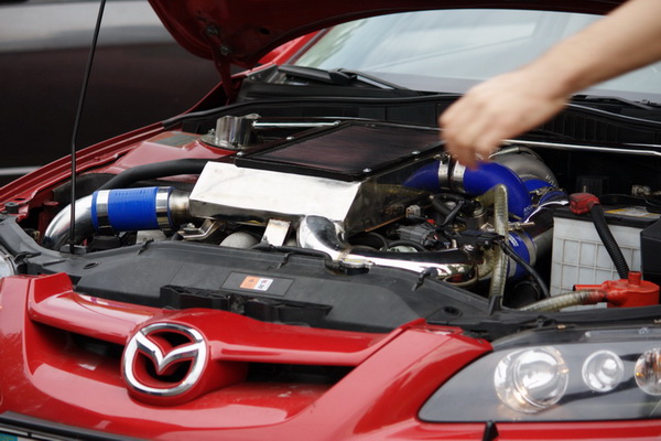

By September, 2010 I've built fully bolted stock turbo setup with the next mods:
3" cat-less downpipe
3" single flowing into dual 2.0"+2.0" cat-back (considering overall 2.75")
intake w 2.75" MAF housing w airflow straightener
custom fmic kit w cxracing 24x12x3" core and 2.0"-2.5" piping
front, passenger & rear engine mounts
front & rear diff mounts
dss rear left axle
act 4-puck solid clutch
eibach pro-kit & bilstein hd
cp-e fuelpump
hks ssqv vta'd
ngk LTR7EIX-11 plugs
wotbox
federal 595 rs-r 235/40 @ GramLights 57F 18x8.5
ECU tune (reflash) myself

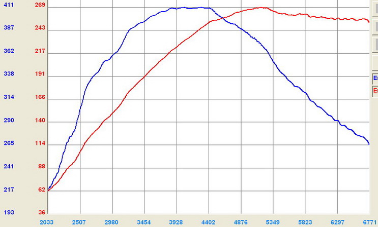

So I dyno'ed it at local Mustang Dyno. 269 whp / 303 ft-lbs (411 Nm) wtq, WCF.
Elevation +_500 ft.

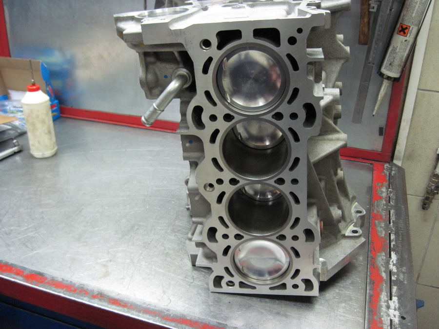

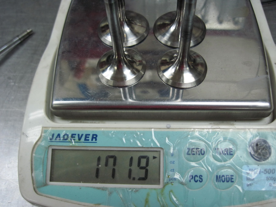

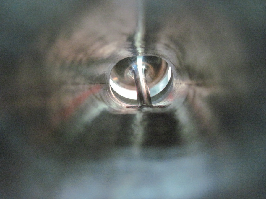

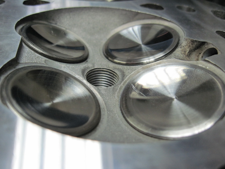

Next day I got back to workshop to install new turbo-kit with all supporting mods:
Garrett GT3076R 1.06 T3 divided
top mount twin-scroll manifold
custom downpipe
TiAL 38 mm wg vented to downpipe
TiAL 50 mm bov
Turbo Garage EBC
AEM 3-port solenoid

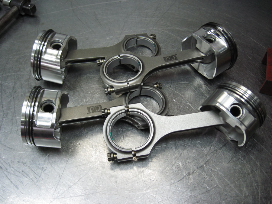

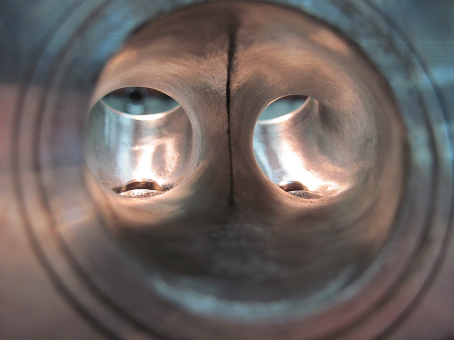

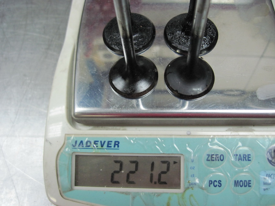

Truly, my spare forged engine has been built and installed two moths earlier with stock turbo, but it was useless cause k04 remained the bottle's neck of such combo.
ARP head studs
ARP main studs
Cometic head gasket 0.03"
OEM bearings
CP Pistons 87.5mm CR 9.5:1 and K1 rods
Custom dry/wet design sleeves
Lightened valves
Port and polish head works
October, 08.

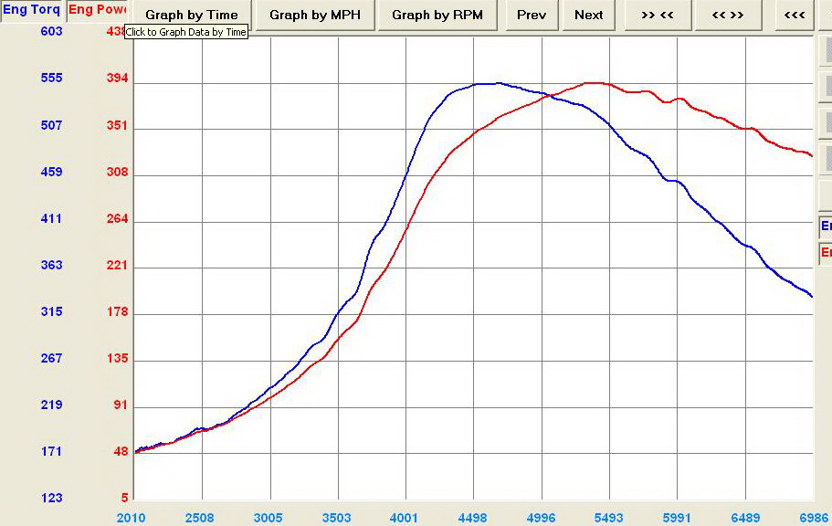

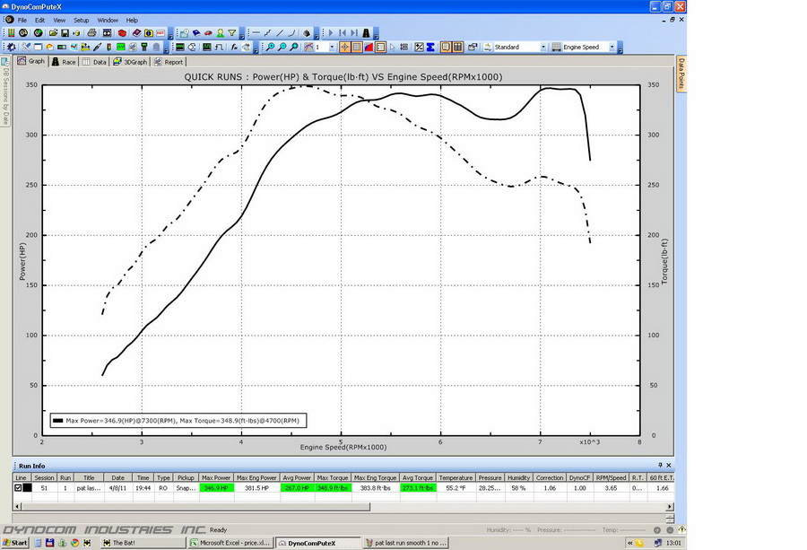

At winter I've changed maxed out 2.75" MAF housing to 3.0" one, still with air flow straightener.
Though I couldn't raise boost more cause of misfires due to 1.1mm gap of my NGKs.
So I've switched to Denso ITV22.
It was time to get some dyno runs, so on April 08 I've done the first ones since 3076 installed. As was told earlier
http://www.mazdaspeedforum.org/forum/foru...7-349-a-81356/
it showed 347 whp / 349 wtq with standart correction.
This roll run
http://www.mazdaspeedforum.org/forum/foru...ps-roll-80673/
was made 2 weeks after that dyno run.
So I'd got tired of running low spark advance with local 93 pump gas and have installed Snow Performance water-methanol injection kit at last.
It allowed significant ignition advance rise and leaner air/fuel ratios at once.
With air filter restriction issues being fixed I've decided to do another dyno run on May 16:

LinkBack to this Thread: http://www.mazdaspeedforum.org/forum/forum/f498/my-bt-way-11-s-82004/
