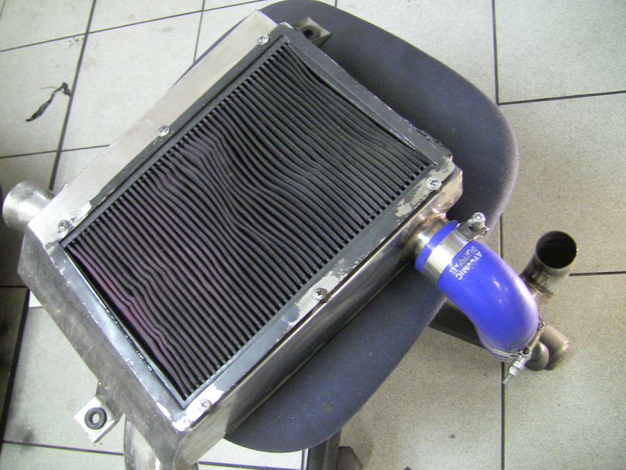

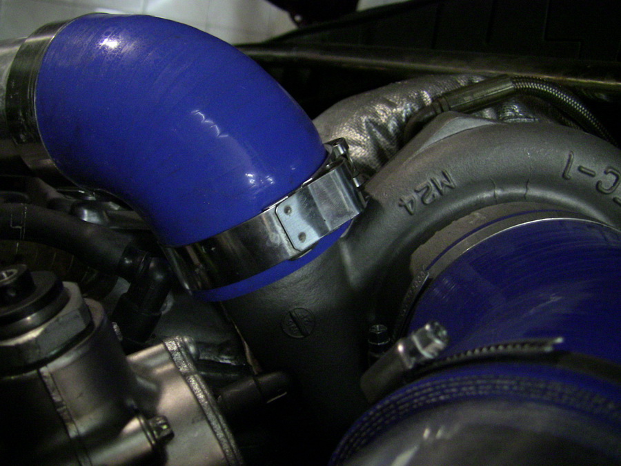

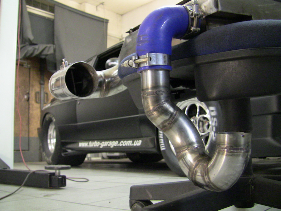

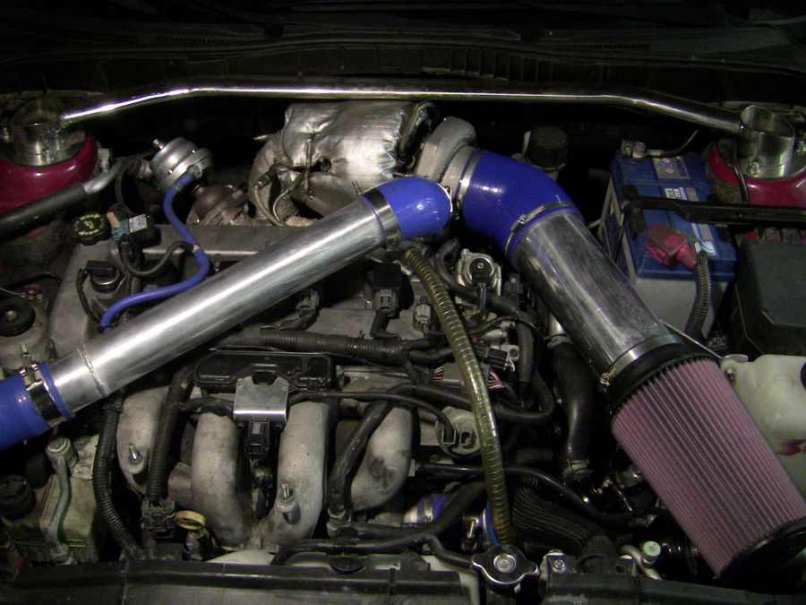

So I've changed my custom complicated stainless steel intake...
...with classic aluminum one utilizing 4" inlet to compressor and 2.5" outlet off compressor...
...and saved some 6 lbs with these mods.
To empty the space for 4" intake I've also installed the smaller battery, saving additional 12 lbs.

So I've saved additional 56 lbs by the way
In addition I've changed Denso ITV22 with Denso ITV24 (just in case), stock BPV with Turbosmart BPV, straightened and shortened vacuum hoses.
2" dual muffler pipes were changed with 3" ones (3" overall diameter estimated since main cat-back pipe was still 3").

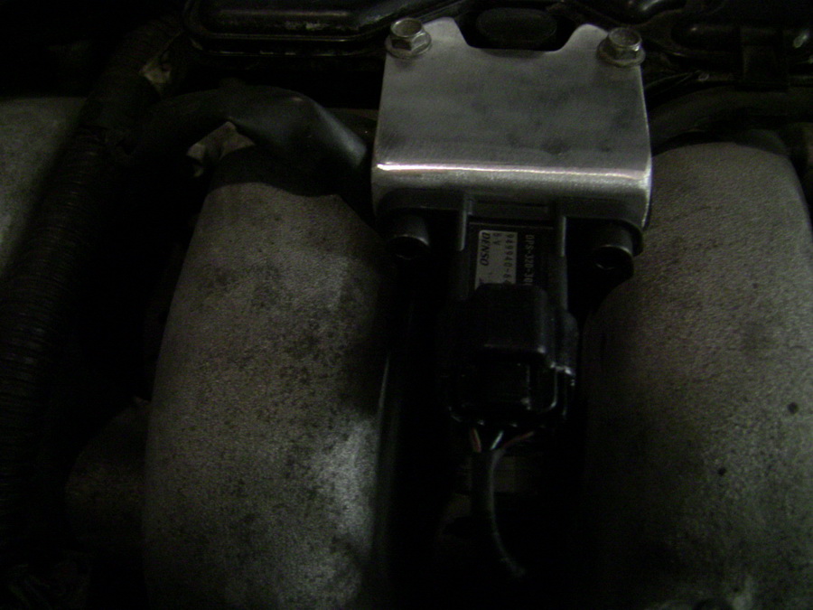

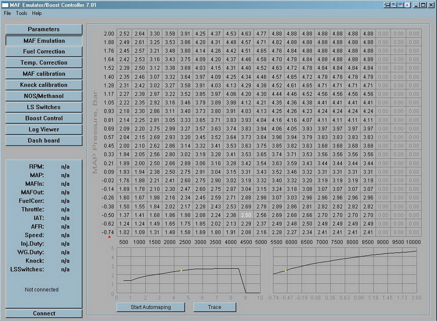

Since it was irrational to install MAF sensor to 4" intake I decided to switch to speed density fuel management...
... utilizing 4 bar Denso MAP sensor
So we've finished my car assembly at friday night (May 27) and I had no time to test and tune it in proper way cause friday night drag session was nearly to be closed soon.

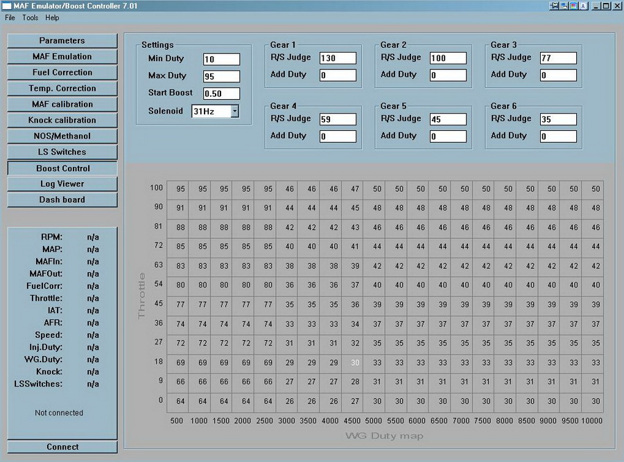

So I tuned WG duty and speed density map almost virtually

BUT with 27 psi tuned and tested.

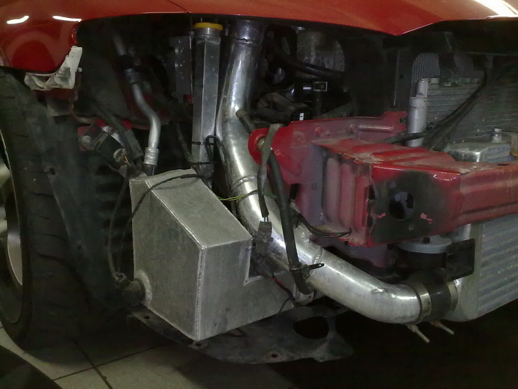

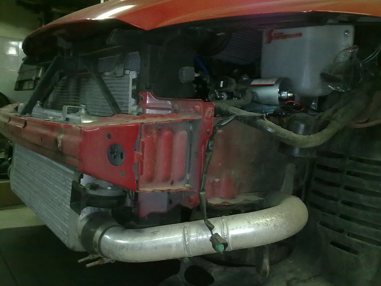

My naked chinese 24x12x3" FMIC and custom washer fluid tank by Nokia 5800 camera
To be modified soon.
