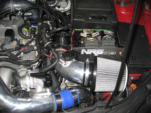

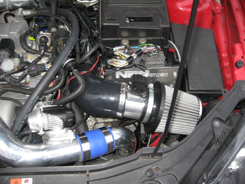

Phil, it's very similar to my last intake. And i can calibrate it. Not sure what you used to tune your 240, or who tuned it, but my setup should be easily manageable.
Just saying the bend and turbulence gives false readings so tuning around a false reading may not be the way you want to go. Same way if you had an exhaust leak before your wide band sensor saying you were lean so you kept adding fuel to compensate and end up flooding your engine with fuel instead.
I'm not just hating here it's a legit concern. What ever just keep it in mind if you ever have some gremlins poping up and need a place to start looking.

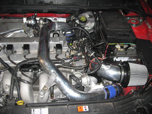

I'll keep it in mind, but i really don't think the bend is as aggressive as it looks. And the sensor is damn near at the filter (just like my last intake).
I know how to tune though, so if such an issue arises, i'll recognize it. Can't be any worse than Joel's blow through pipe hahaha. That was 100% unmanageable. His new one should be much much better though.

You're maf is going to hate life on that bend plus it really should be about 11 inches away from the turbo and 5-6 inchs away from any bend.
Exactly what I was going to mention.
Everything else looks like pure win though...

DJ you haven't learned from my fail? You're maf is going to hate life on that bend plus it really should be about 11 inches away from the turbo and 5-6 inchs away from any bend. MY 240 couldn't catch idle for shit off Decel being as close as yours is to the turbo and on a bend to boot. Pre pare you're self for tunning issues.
Agreed. The MAF needs laminar flow to accurately read mass airflow, and the closer you put the MAF to the turbo or a bend, the less laminar the flow will be. The rule of thumb I've been taught is 2 times the MAF diameter from any bend (upstream or downstream), and as far from the turbo (or throttle plate in N/A applications) as possible.
In addition, you may have to rotate the MAF around while tuning to get the best (i.e. most linear) response in relation to engine/turbo RPM's.
Don't get me wrong, I'm not hating; I just want the car to run as well as possible.
Darksun280 (02-08-2011), djuosnteisn (02-08-2011)

As far as the MAF location It looks like the picture distorted how severe the bend is, I think you will be fine
Maybe snap another pic from the other side
Also, what mounts are u running? Im guessing all of them?

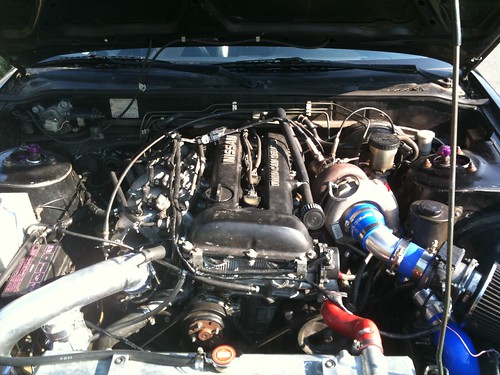

This gave me hella drive-ability issues
But this little change made it act right
I mean look wise it doesn't look so drastic but it was all the difference when it came to drive-ability and the way the car acted on boost onset.
The ms3 was cause of the bend and the pic of the Sr20 was cause of house close it was to the turbo. Once the piping got rerouted to the front radiator adding an extra 20 inches no more bucking or stalling or cuts.
Carry on citizens....

Honestly, i just made it like this cause it's pretty similar to how my last intake was. I'm already planning on replacing this intake at some point, so it'll work for the time being.

When you extended it on the SR20 did you also move the filter farther away from the MAF?
When you look at the cp-e filter on the MS3 you can see the built in velocity stack where the filter connects to MAF housing. This shape helps to smooth out the air and eliminate turbulence. Also when you look at the location of the MAF on your MS3 it was in the middle of the bend where air is going to tend to hug the outside of the bend and miss the MAF sensor altogether. When you look at the location of the MAF on dj's intake it is about 90 degrees to where yours was and closer to the start of the bend. There is a chance there may be some turbulence or noise here but it won't be near as bad as it was in your case.
