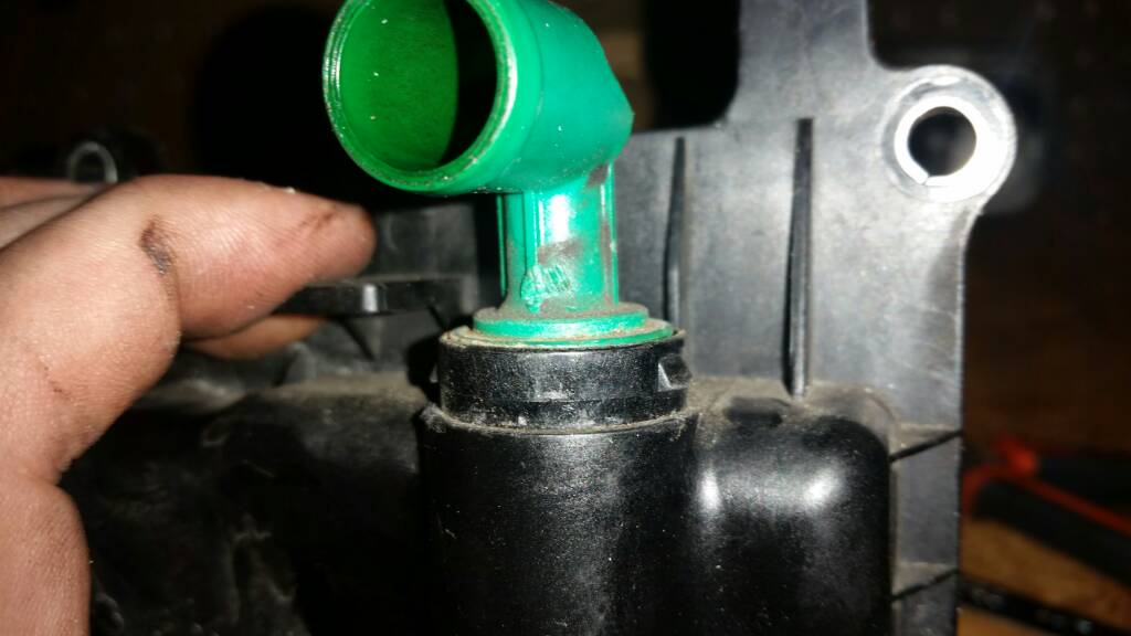

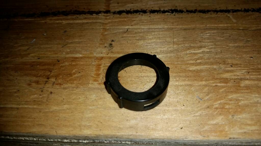

Well valve is still stuck. Talked to Pablo and we figured its best to change the pcv valve. Now i havent done this before so im unsure of what i need. Mainly whether or not i need this particular o-ring.
KILLAH BUILT
Navy_Mech2 is offline   Reply With Quote
 Old 03-09-2015, 12:12 PM   #177
Probably need both of them. PCV (13890) and the Oring (13203). Would stink to have to pay shipping on a 3 dollar part!
 Old 03-09-2015, 01:39 PM   #178
I broke the PCV on the CX-7 back in the day. Remove intake manifold, and it is right there. Get the valve, and a new clip to hold it in place. You will break it removing it.

Yea i know where its at and all juts didnt know what i would need. And eric are you talking about the clip that holds the valve into that box that bolts to the motor?
KILLAH BUILT
 Old 03-09-2015, 07:27 PM   #180

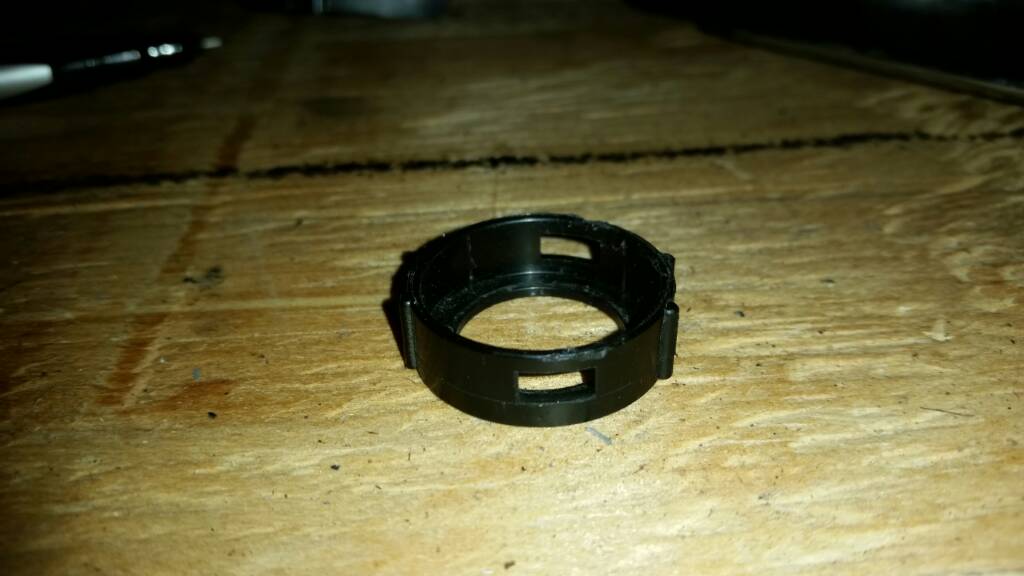

Yup, there is a round piece of shit plastic cockring that you have to remove to get the valve out of the box. Get a new one.

I ordered the valve and o-ring but can't find the cock ring anywhere. Have to get it from mazda I'm assuming?

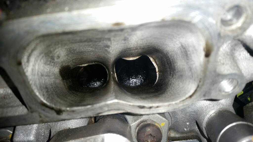

Oh sweet sweet victory! Got the PCV valve changed and didn't break the retaining ring! So screw you Eric! Haha. All in all it took about 2 hours with a dinner break in the middle. Tomorrow I'll put it back together. Now time for engine porn.

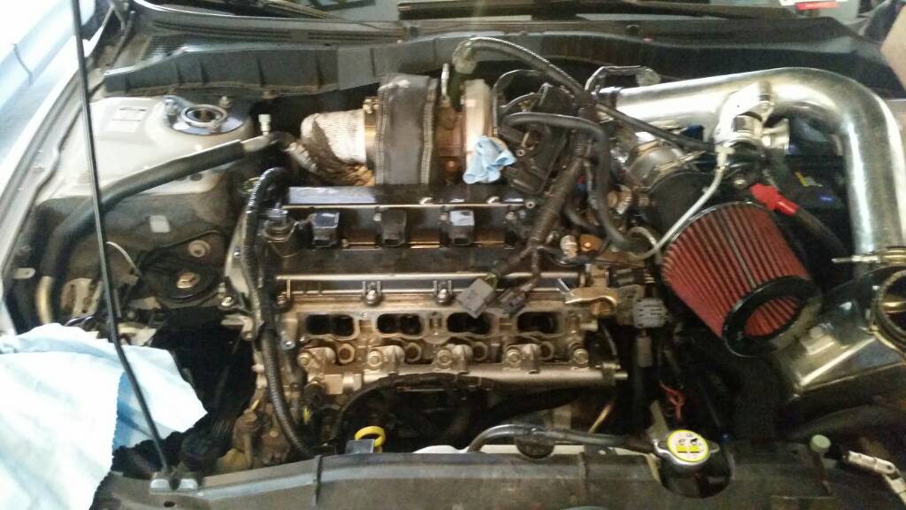

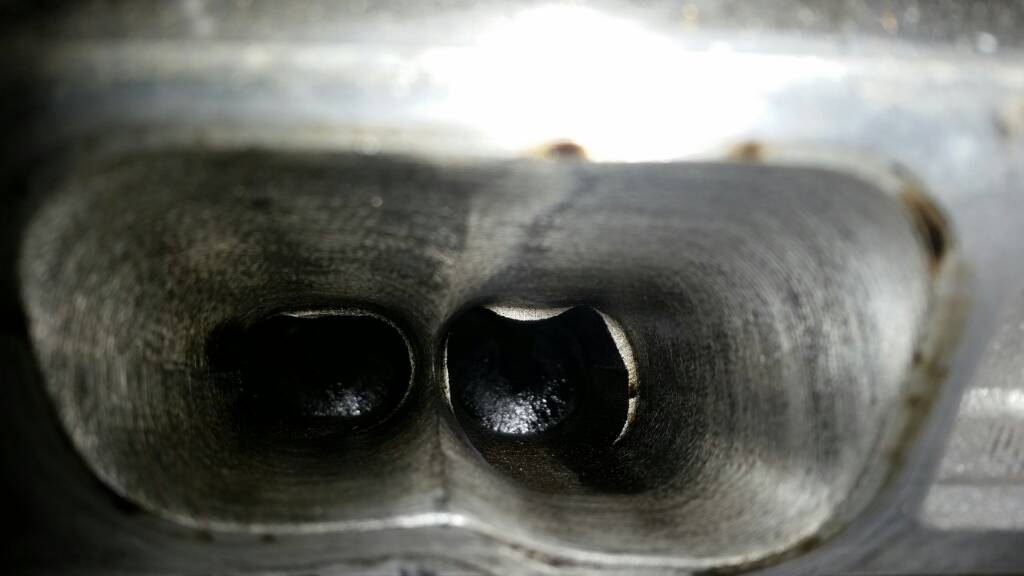

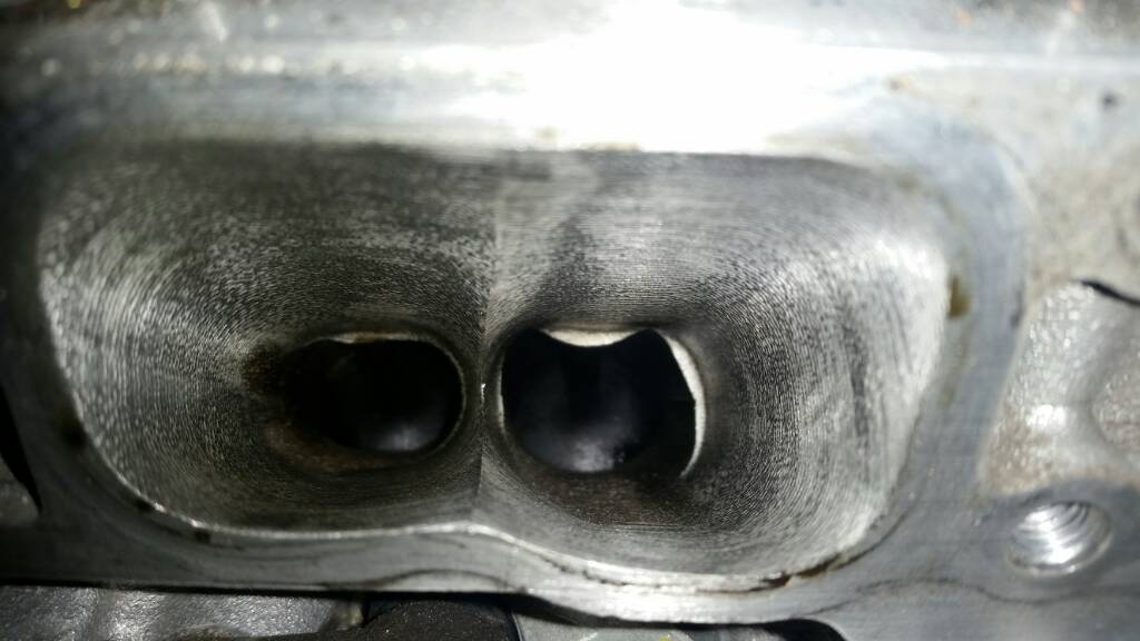

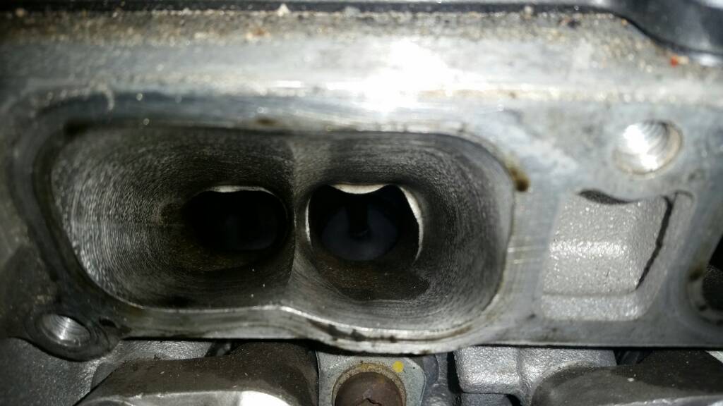

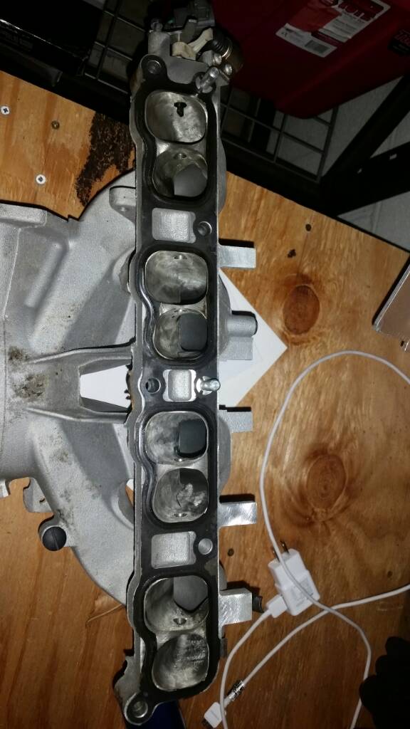

Not really. The PCV didn't change anything and at the advice of Pablo, I swapped out the check valve that came with the JBR catch can setup for the one Matt Damond sells with his. Other than that the car gets driven about once a week if it's lucky. Work traffic is hell in the afternoon and it takes about an hour and a half to go all of 15 miles. Needless to say the clutch doesn't really care for stop and go traffic much.
