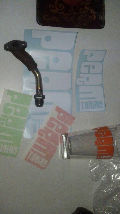

Thanks: 119
Christmas came early! @djuosnteisn; thanks a lot man the line looks killer!

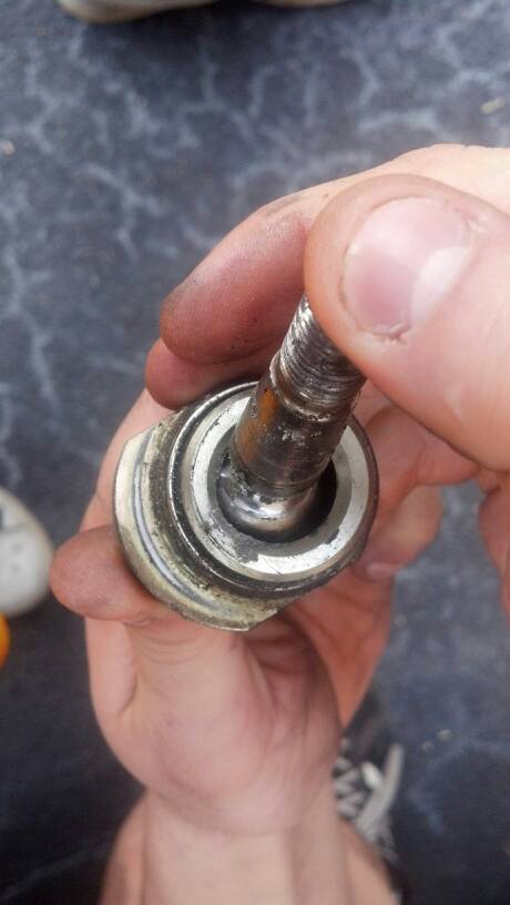

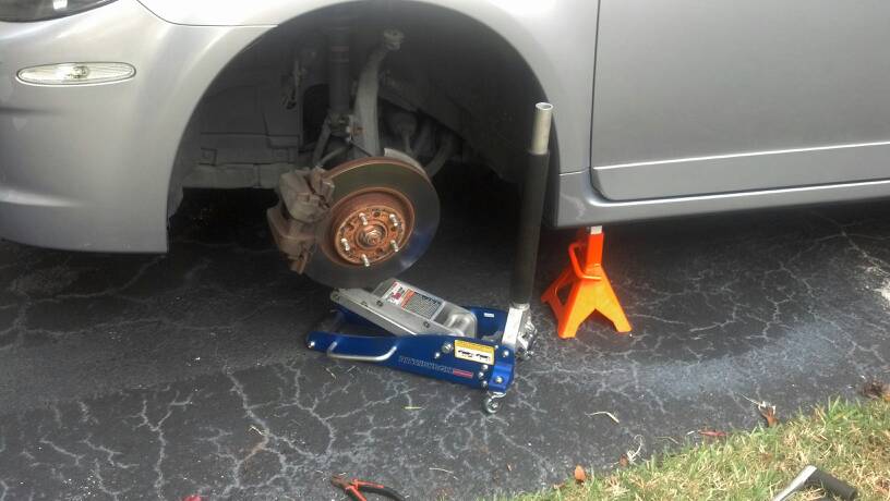

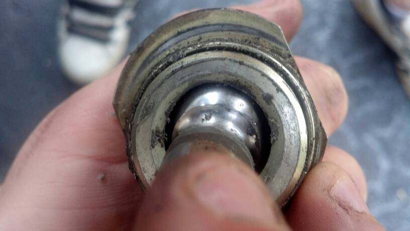

So since my brother is in town, and he works for beer, we changed out my front ball joints today.
Sorry about the cell phone pics... I've actually been putting off changine them for about 2 months now since I don't really drive the car much after I bought my truck. Anyway on to pucks of the carnage...
Left one
Right one
If you look at the visible edge of the socket you can see where its been egged out. And all the white/grey shit that looks like it doesn't belong is actually a mixture of sand and greese. A by-product of what happens when your dumb ass ex wife drives your car ON the beach. Took us just under 2 hours but we would have been done faster had the right control arm not gotten stuck to the bottom stud of the ball joint. Moral of the story, ball joints don't like sand.

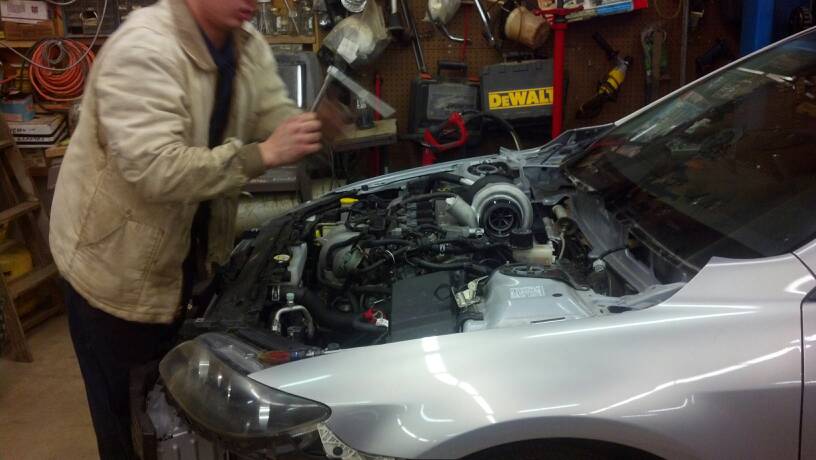

Thanks: 25,797
Congrats man. What turbo is that? And are you going top mount?
Sent from freeks kitchen
2010 Speed3-PTE5858
Freek built/Freektuned
510hp420tq
11.321@129.93
 Old 12-24-2012, 03:31 PM   #25
Navy_Mech2's Avatar
Location: Lusby, MD
Posts: 484   (View Stats)
Rep Power: 496
Thanks: 119

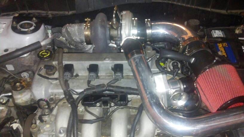

Its a bullseye s259. and yes im going top mount. im actually gonna be installing it from the 1st to the 5th

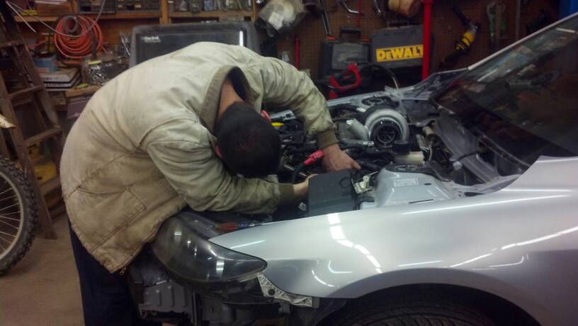

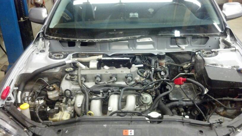

So end of day 1. Got all the stock BS out of the way and mocked up the manifold and the turbo to get some measurements for the down pipe and dump tube. Tomorrow I gotta get a couple bolts for the oil drain flange and track down some water fittings for the inter cooler and heat exchanger. Also does anyone know what amperage the Bosch cobra water pumps run off? Now on to the pics...
Sent by my thumbs
KILLAH BUILT

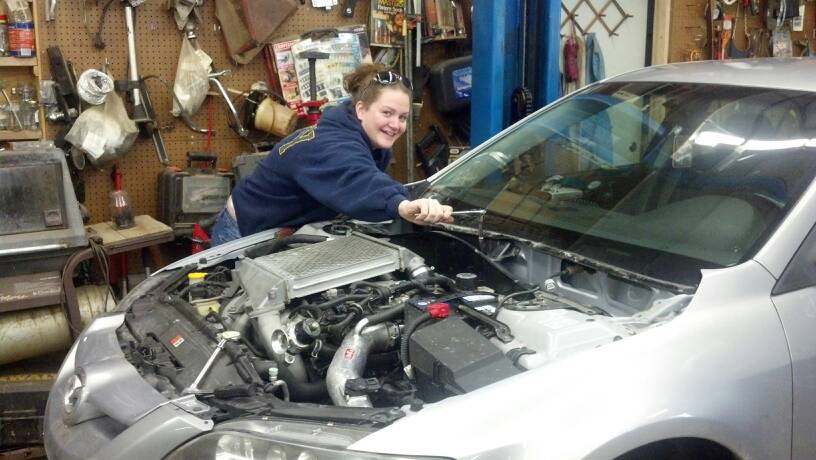

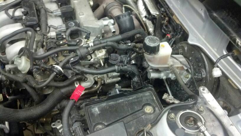

Ok. Days 2,3,4 and 5. Got everything in and made it back to Jacksonville running on all cylinders!! After many, MANY runs back and forth between o'rileys, rice-zone and ace hardware (i think i was on a first name basis with everyone), 3 long nights with hardly any sleep, its done!
So anyway the car runs good. Not perfect yet, but good. It feels slower right now since im running on wastgate pressure which is only set at 14 lbs, even though it creeps up to 17. The screamer pipe sounds dope and the turbo sounds like a damn jet engine when it spools up.
So day 2 was more or less spent mocking up the downpipe and making the new elbow that tied into my cpe downpipe. Took me and my brother about 2 and a half hours since we were working with a straight piece of 3" tube. Anyway, we ended up cutting 2 45 deg pieces and one 15 or so to make the turn after the turbo. I'm not 100% happy with how it looks but it works and it doesnt leak. So to feel better about it i wrapped it with heat wrap.
Day 3 was mostly running around trying to get shit made. I took my hot pipe to Ohio Hydraulics (great people if anyone in the Cincinnati area needs shit made) and had them machine and weld a flange for my blow off valve. They also brazed a -4an fitting onto my oil feed and gave me 2 -10an to 5/8" barb fittings for my heat exchanger. That night we finished up the downpipe and wrapped it, fitted, welded and wrapped the screamer pipe, and got the wasegate mounted to the manifold. ***Anyone using a turbosmart wastegate or going to*** This was an absolute -read- BITCH to get on! It probably took the 3 of us an hour using channel lock pliers to get on. What i ended up noticing was that the turbosmart has a sleeve that seals the bottom of the piston when its in the closed position. (i dunno if the tial or any other brands have this) Now the steedspeed manifold has a notch machined in the wastegate flange for this seal but it seemed that it was machined a smidge too shallow to allow the main body of the wastegate to sit flat on the flange. What we ended up doing was grinding down the seat of the insert so it let the wastegate sit flat against the manifold. Now again, i dont know if thats an issue with the steedspeed manifolds or not. I doubt it since most everyone else seems to have no trouble with them, just thought id share with you guys.
Day 4 was a rush to get everything finished since it was saturday and we had to drive back down today (12 hours). My 90 deg coupler from silicone intakes showed up at 1130 and we went to work getting the turbo put on, downpipe hooked up and the intercooler piping ran. Everything went super smooth until it came to the hotpipe. Unfortunatly our measurements, a.k.a. eyeballs, were off by about 4 inches. i think we just assumed the 90 deg coupler would be a little bit longer on the straight ends. so long story short the hot pipe is at kind of a wonky angle in order to get it to fit. I have a friend in town that im gonna have weld a few inches onto the end so that it lines up straighter. Now on to the funny (at least i thought it was) shit. While we were installing the heat exchanger, my dumbass knocked the fan off of the toolbox and of course it broke the housing and a blade off. So i just said fuck it and didnt put one on. Then i told my brother and girlfriend to put all the trim that goes against the windshield back on along with the hood and bumper while i cut a map to get the car running. When i got back and flashed it, the car fired right up, but when i went to back it out of the barn, i realized i had no power steering. Then i remembered that i forgot to put the serpentine belt back on. By the way, thats a bitch to do with a top mount setup since the downpipe blocks any and all access to the tensioner.
So after a few more tweaks to the map, we drove to my dad's girlfriend's house out in wilmington. (about 45 min) On the way there i rolled on the throttle on the highway and i could only boost 5 psi. When we got to her house it dawned on me...we didnt put clamps around the throttle body coupler . I borrowed a couple clamps from her neighbor and then the tune went stupid lean as soon as the car started. Imagine that. Luckily i brought my laptop with me and i added about 10% more fuel to the 20 that i already gave it and the car ran like a champ. Turbo spooled decently quick and i hit 14 psi and crept to 17 by 6000 with the afr's staying under 12. And thats where i left the tune for the drive back down.
Some thoughts on the LTA setup. Cruising BAT's are kinda high (40deg over ambient) but i think thats in part to not having a fan on the heat exchanger and a little bit of air in the system still. But when boost rolls on temps drop by the 10's down to just above ambient. Ill post logs about this later this week as well as a VD plot. As for the future i need to install my injector seals, get my hotpipe fixed and install my HPRV and buy a EBCS. I think im gonna get the Cobb one unless you guys think its a better idea to use another.

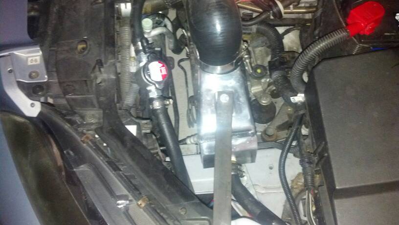

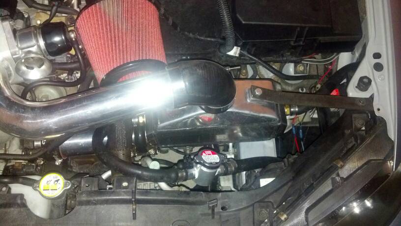

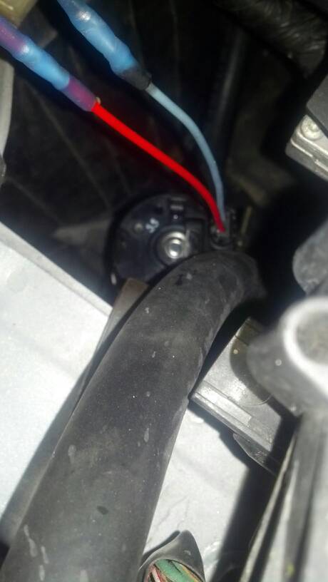

OK here's some better pictures of the setup with the heat exchanger and water pump. Sorry about the cell pics. And the slightly crooked pipe setup
Sent by my thumbs

It looks like you shouldn't have a problem. what direction does the water flow in and in what order?

From the pump up to the intercooler, then to the remote filler, back down to the top of the heat exchanger, out the bottom and back to the pump.

Sounds good then, you should be happy with just the tig and egr delete
