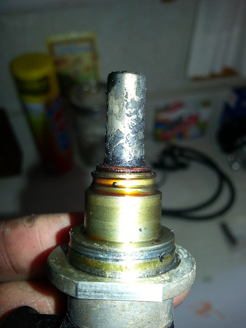

Thinking the same thing. That was the reason I didn't want to go with meth though was having to remember to have another tank full. Mark is it harder to tune running that way rather than just having all the injectors running the same mix out of the same tank?
But I do like the idea of not having my oem injectors looking like this anymore...
