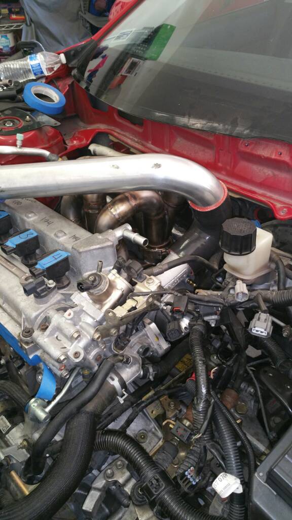

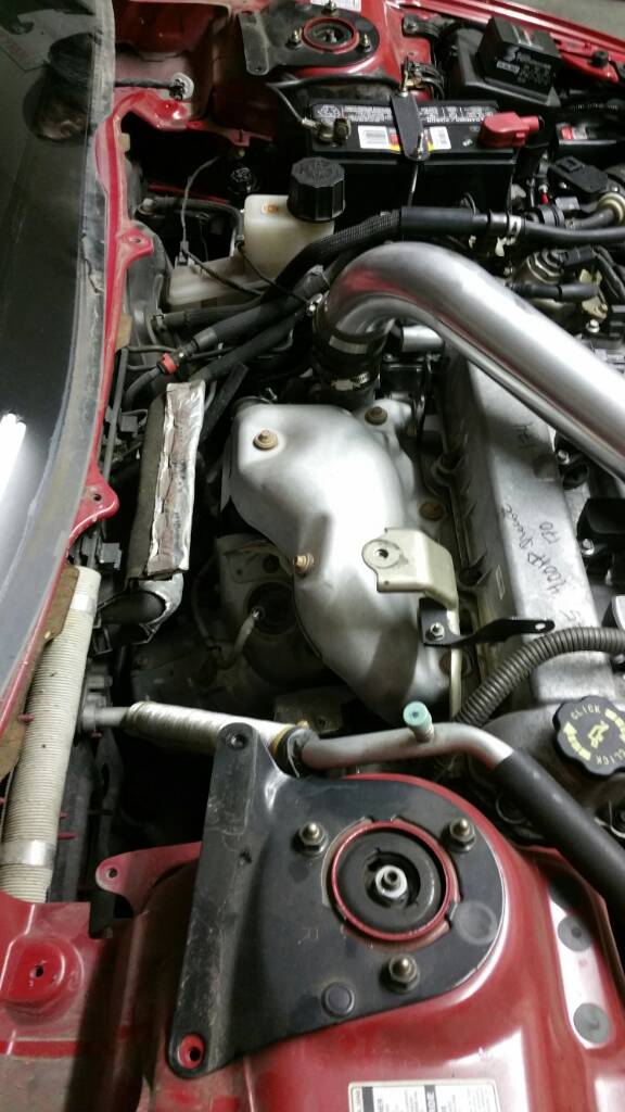

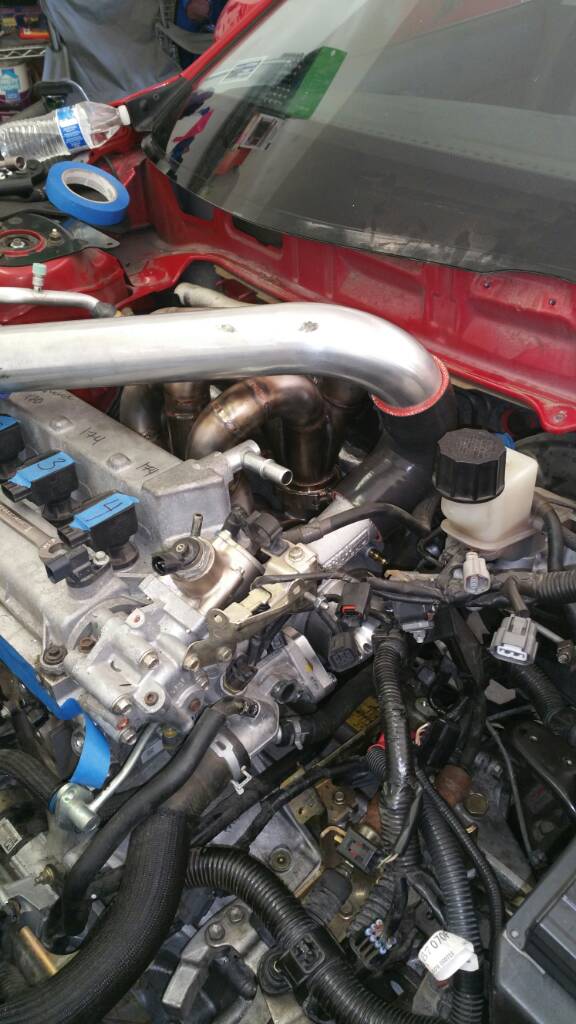

Alright so I figured I would finally make my build thread. I originally had hopes and dreams of being fully sp63 built and shooting for 5-600 due to other factors she is going to be built into a BT Flow monster until the block can be built.
Back story on the car - I picked her up about a year and a half ago in beautiful condition. It was a 1 owner dealer maintained car that only had 51k on the ODO. It wasn't long until I got the JBR PP2 intake an ap and some internals and got to work. Its been a process over the last year and a half of it coming into its current state.

As far as fueling I was debating on 6th port but because I already have meth installed im going to use that to fuel me to the limits of the stock block.
Essentially I would like to shoot for 380-400hp and tq somewhere around 360 - I think with how the motor will flow it should not be an issue. As long as I can keep TQ down then I will be ok.
I will update this thread as the build goes along and as parts start to show up. I want to try to make this as detailed as possible because there are not many Precision 6s and it would be great to build a knowledge base.

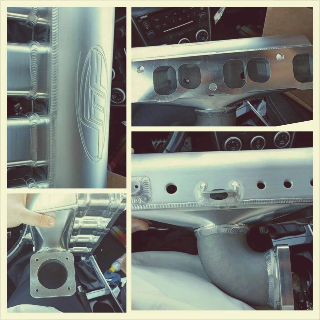

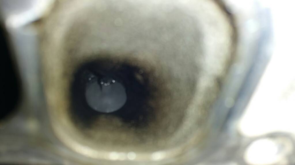

Some stuff that has already come in.
First thing to show up was the tail 44mm wg. I picked it up used so I have to pull it apart to see what springs are inside
My new rims also came in as well. Had an issue with them at first, they sent me one wrong color place I bought my wheels from was super cool about it and I had the right wheel 2 days late
First pic is the wrong flat black rim second one is the right rim.
Got some pictures of the old 225 NT05s vs the new 255 federal RSR
Pics of the car all mounted up with the new wheels. Car looks mean with so much meat under there. These new tires grip like crazy, autocross next weekend will be fun. Having some issues with a slight rub in the rear passenger side, I think i have to camber the rears another .5 deg to get it to not rub.

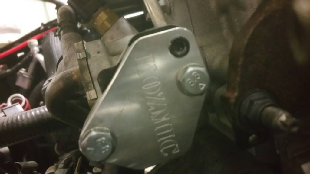

Kozmic EGR Delete, EGR Block & Oil feed line

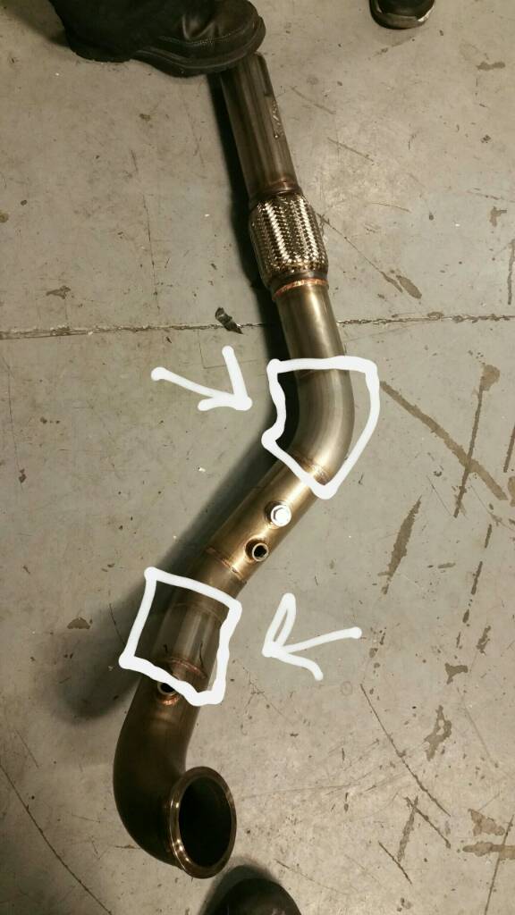

Best pic I could find of Dave woods speed 6. SP63 built his motor/made the drain line for a 6266

^ Wow, I would not run this line.

Dave does successfully on his 700+ hp speed 6

I'm with code monkey on this one. Can you ask them to shorten the line?

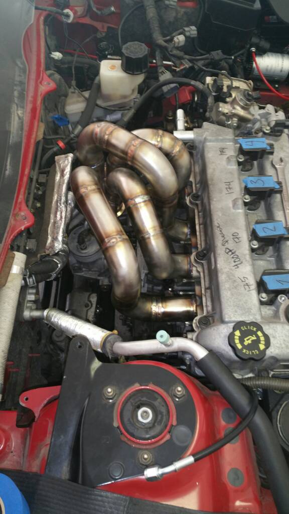

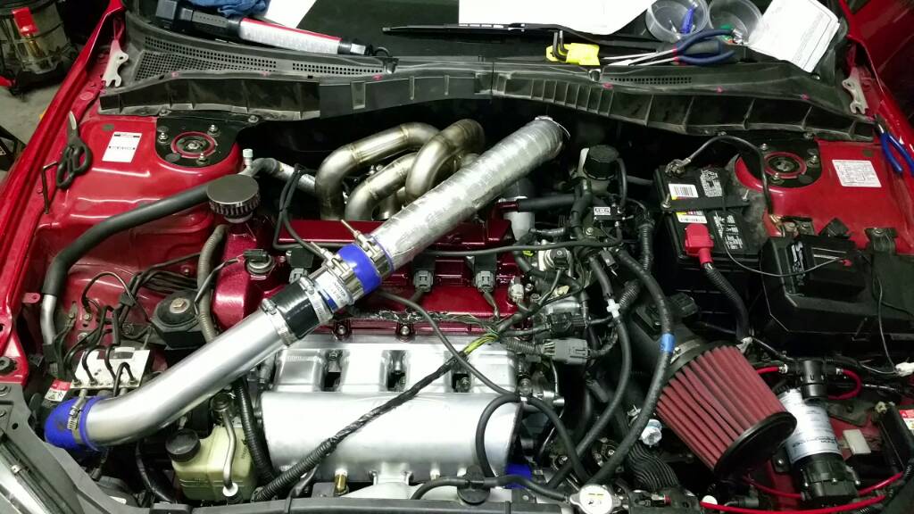

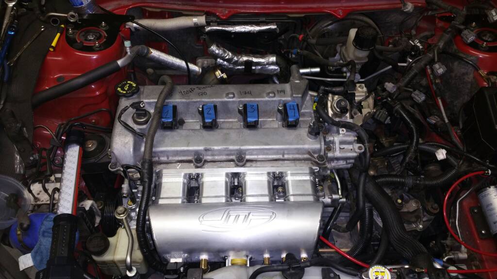

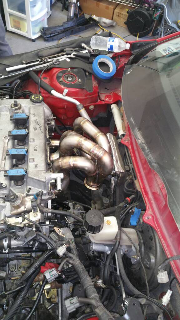

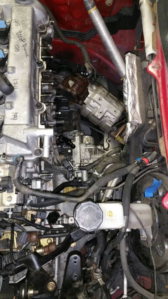

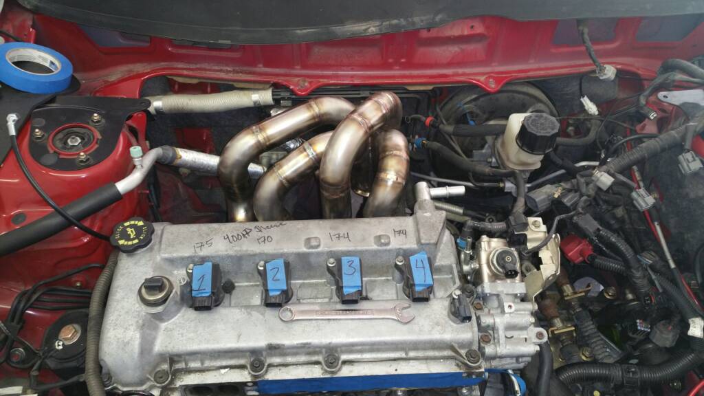

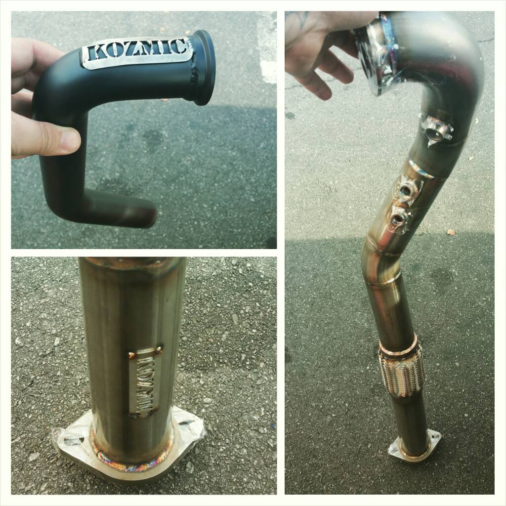

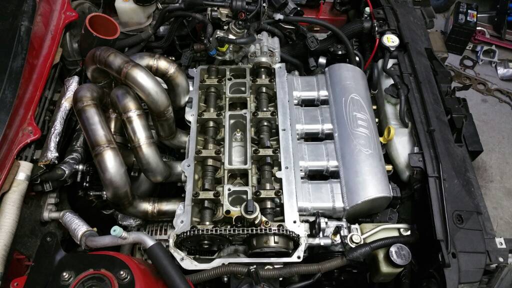

Aright, I've been lagging on getting some updates in but here is some noodz for you guys. Kozmic dp/screamer pipe came in.
Also jmf manifold came in!
I have everything for the oil line as well. @hanzodurr provided his oil line off his 3 and I took care of buisness. Line all cut with bung welded on.
I have all of the an fittings so I'm gonna get a semi test fit tonight. Install starts on Friday so I'm gonna be taking a lot of pictures then.

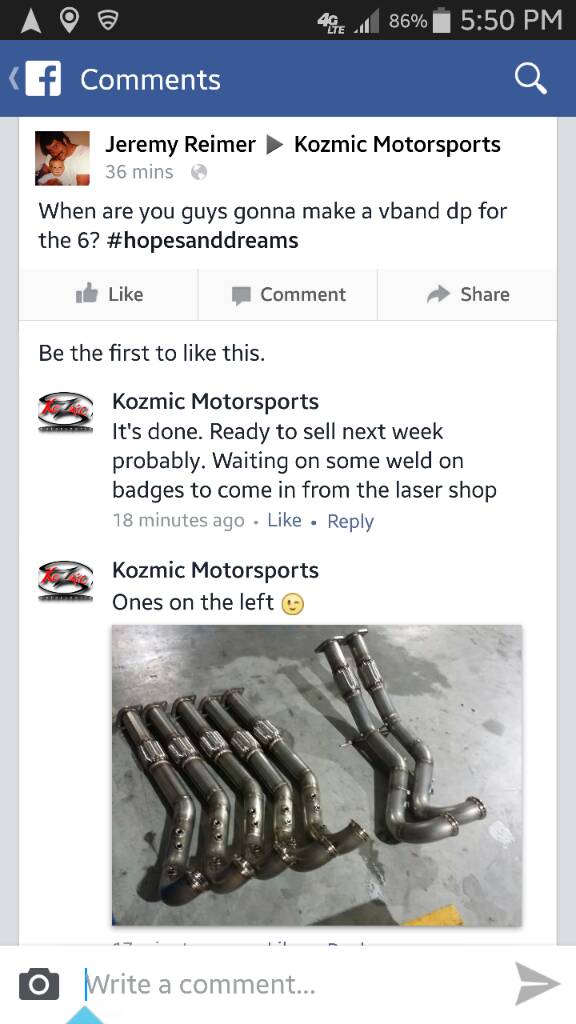

 Old 01-07-2015, 05:18 PM   #31
Is this a Kozmic MS6-specific DP? I thought we were still waiting for one to be released?

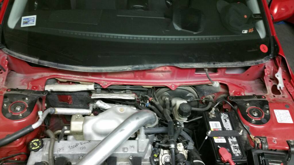

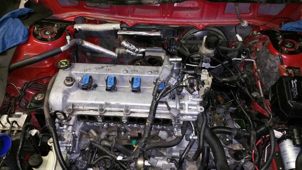

Man o man o man! It's done!!! Sorry for the lack of updates but there were some issues along the way that put up some setbacks. However the car is running! It is currently at the fab shop getting some things modified that I will detail later in the post.
There was the current status of the motor
After the removal of the cowell. I HIGHLY recommend doing this. So many times I thanked the Lord for having it off so it gave extra clearance.
So much room!
Kozmic egr delete (notice the wrong bung installed. I figured out it was wrong later down the line

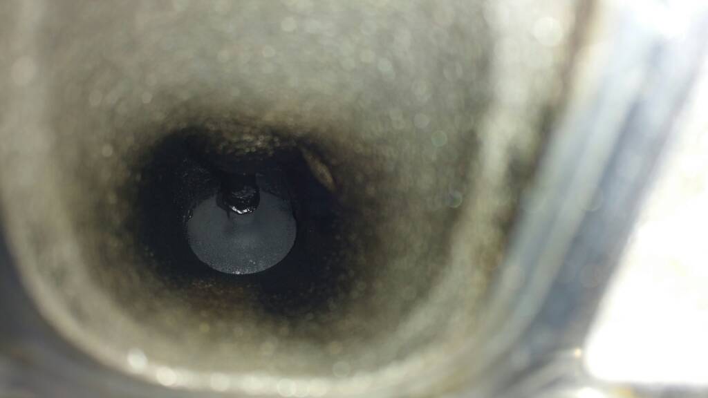

Got the intake mani pulled off and got a look at my valves. This is after 70k miles and NO OCC however I have been running meth for the last 6 months and it seems to have cleaned them nicely. I didn't end up cleaning.
Dick decided that my block needed the 8 finger singer
Exhaust mani pulled off. In retrospect this came off rather easy. Pb blaster is your friend

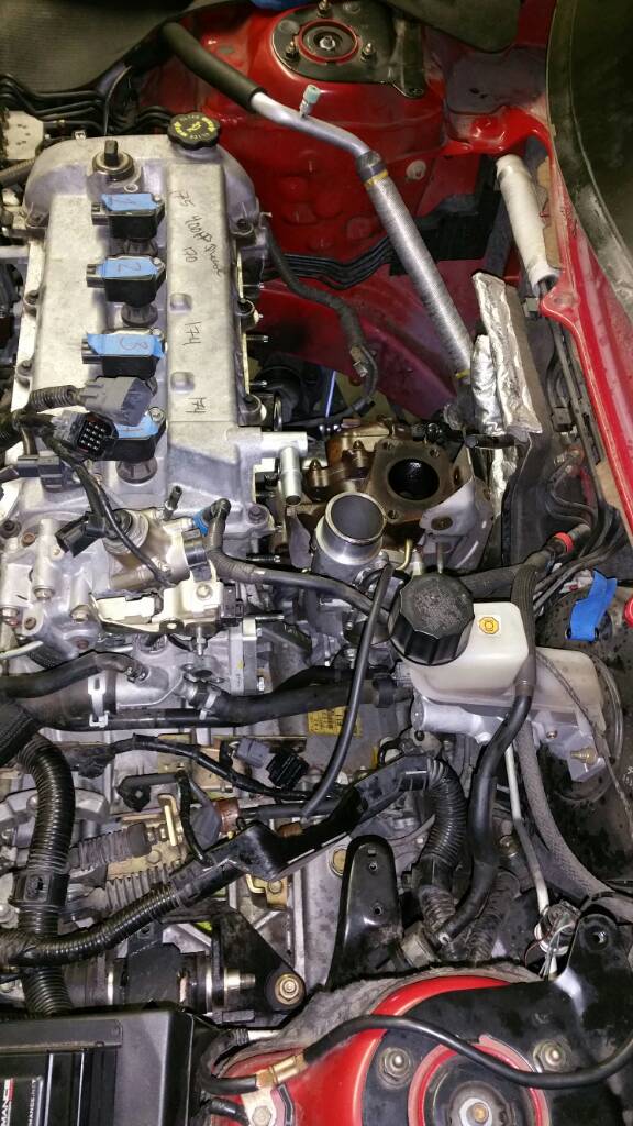

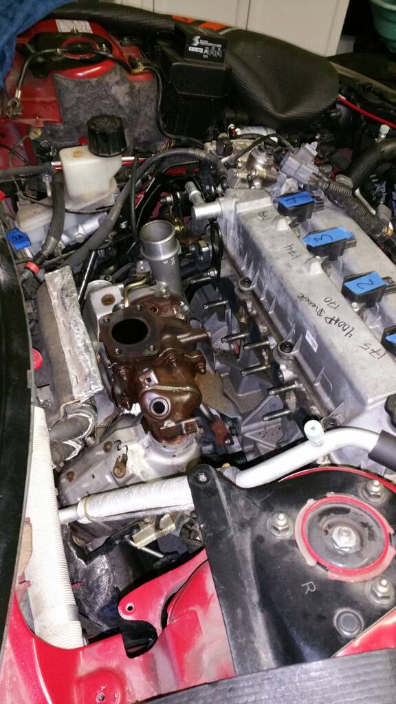

Look at that little turbo down there.
Turbo and alternator pulled out
That was the end of day 1

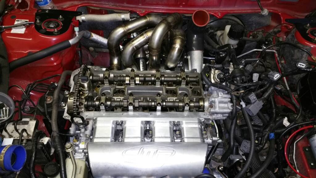

John russell came through. Manifold was delivered in the morning of day 2. Had to go to the post office to pick it up. This thing is beautiful. Very well built piece.
Mock mount up with turbo on
The turbo still needed to be clocked quite significantly still at this point.

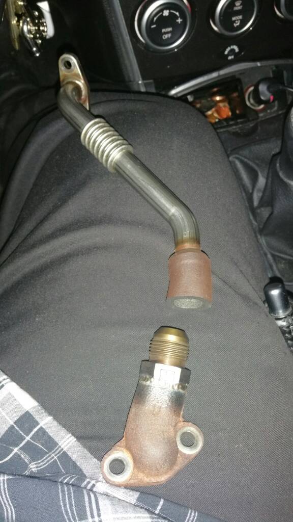

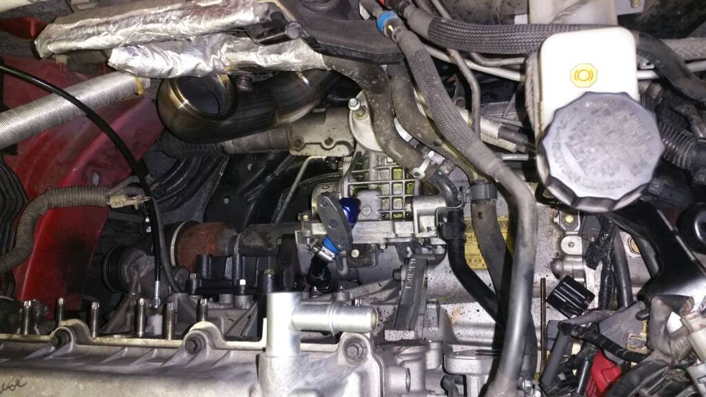

So earlier when I showed the Kozmic egr delete and the wrong bung this is the reason why.

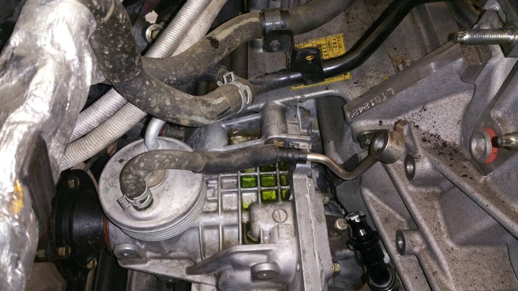

This is the coolant return line for the stock turbo. Thanks to William dawson -I will tag him when on the computer- helped me figure out I needed to buy a brass barb for the egr delete and connect the line to that. The line has a reducer in it so it's better to get another barb to connect it to a second line and connect thay to the egr. I however did not get a pic of that.
Jbr manifold mock up
Make sure you fully tighten the fittings on the intake. I had them hand tightened and they were leaking when I did the boost leak test.

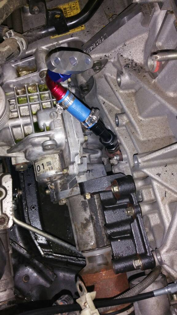

Built the turbo oil return line. Ended using a 45 and a 90 an fitting as well as a high temp silicone push lock hose. This was the most difficult thing of the night and took 3 nv nator guys to help fit it up and get it on. Thay was after rebuilding it because the initial cut of hose was to short. This was still off and we took about 3 hours to get it back on not fun. The an fittings will need to have the first flare cut off because it will be to long. Also use some worm clamps o either end of the push lock fittings to get it to secure. I will also reccomend to attach it to the turbo first then attach it to the block. I took off the turbo/manifold/wg/screamer pipe in all one fit probably 5 times and that is all very heavy.
This is with the manifold all mounted up. I did not get any pics of the wg/dump tube but once I get it back from the shop I will get some
I also removed the stock valve cover to replace with the new one. Timing chain was fairly tight for it being cold but it had a bit of slack.
Here it is all done up! Just before start up.

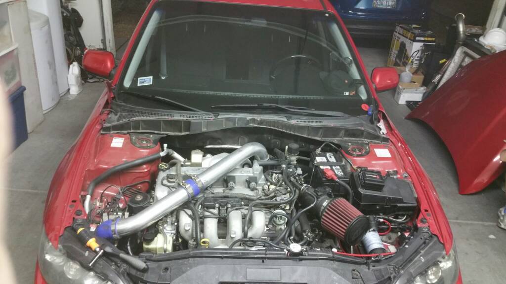

I had to create a bit of extra piping because the stock piping is to short. This Is from how I had the turbo clocked.
It was a super squeeze to get the htp3.5 back in with the 51r tray. Also the recirc tube was to short so I had to cap off at the end. I'm pulling the line and capping it off on the inlet.

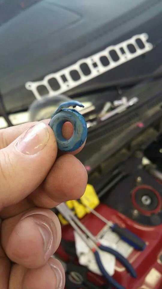

So map is loaded and getting ready for start up. Everyone is nervous and I'm trying not to be a bitch. First things first, have to prime it. As I was doing that it got to about 45psi and the fuel rail started to piss fuel...I was so dissapointed. I got the intake mani pulled off in order to see where it 3qs leaking. I ended up buying all new upper seals for the injecotrs...these are expensive as shit!
this was the culprit
You can see how the blue o ring got torn and ripped.
This was all the following weekend and I 2as determined to get it running. By 11 that night I was driving home!
Currently the down pipe is getting modified. It was rubbing on the drive shaft in 2 places. This is what had to be modified circled in white

Awesome to see the car is running!
It is a bummer though that the brand-new just-about-to-be-released Kozmic DP rubs on the driveshaft. Is this because your EM positions the turbo differently than the cp-e EM? I think the Kozmic DP is designed off of the cp-e one.

It very well could be. Kozmic from what I understand does a lot of research. I have @hanzodurr cpe manifold in my back seat. I'm gonna see if I can get some measurements done once I get the car back. With how much the pipe had to be extended it seems like it could be a bit of kozmic being off and the exmani being off.
