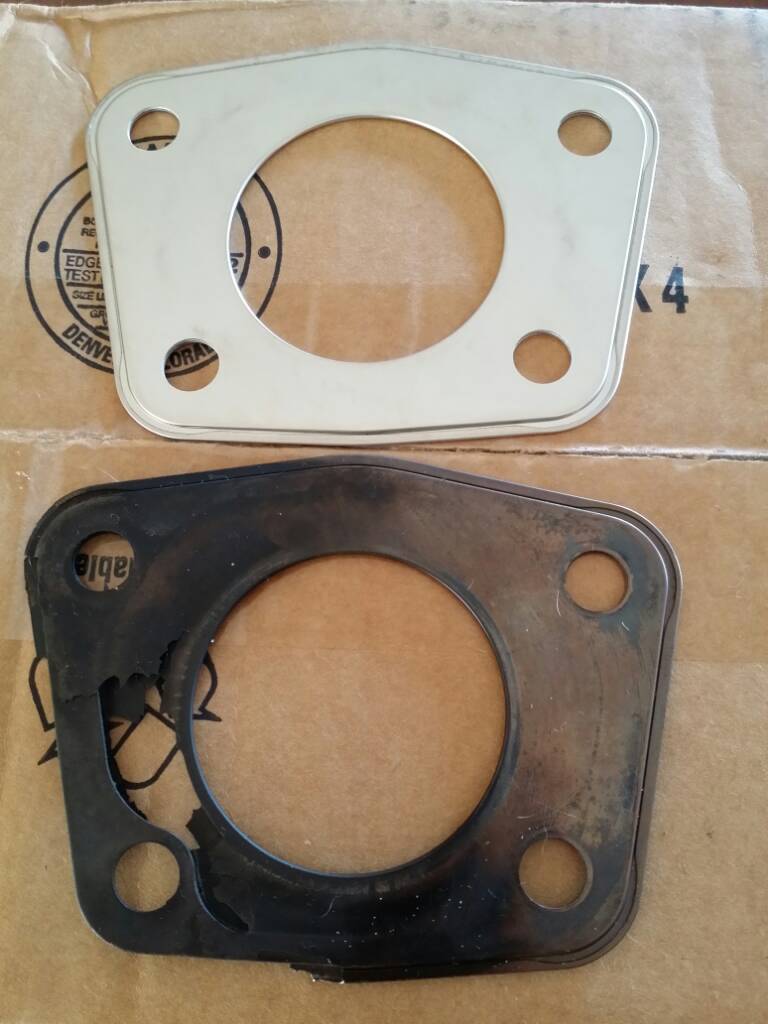

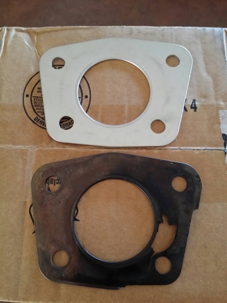

It's funny, because I was going to update this thread tonight. I just received my package from @EdgeAutosport.com;
I had to order the manifold and down pipe gasket. I also went ahead and got a new set of Denso ITV22 spark plugs.
Nothing has gone smooth since this whole upgrade started, but it should be coming together very soon.
*Edit
How the fuck does this happen?

The bolts on that side were not tightened properly and the heat of the escaping gases burnt that gasket.

I will be sure to double and triple check this time around, but I'm sure it was tightened well when I installed the manifold.
If they were loose, there were zero signs of a leak.

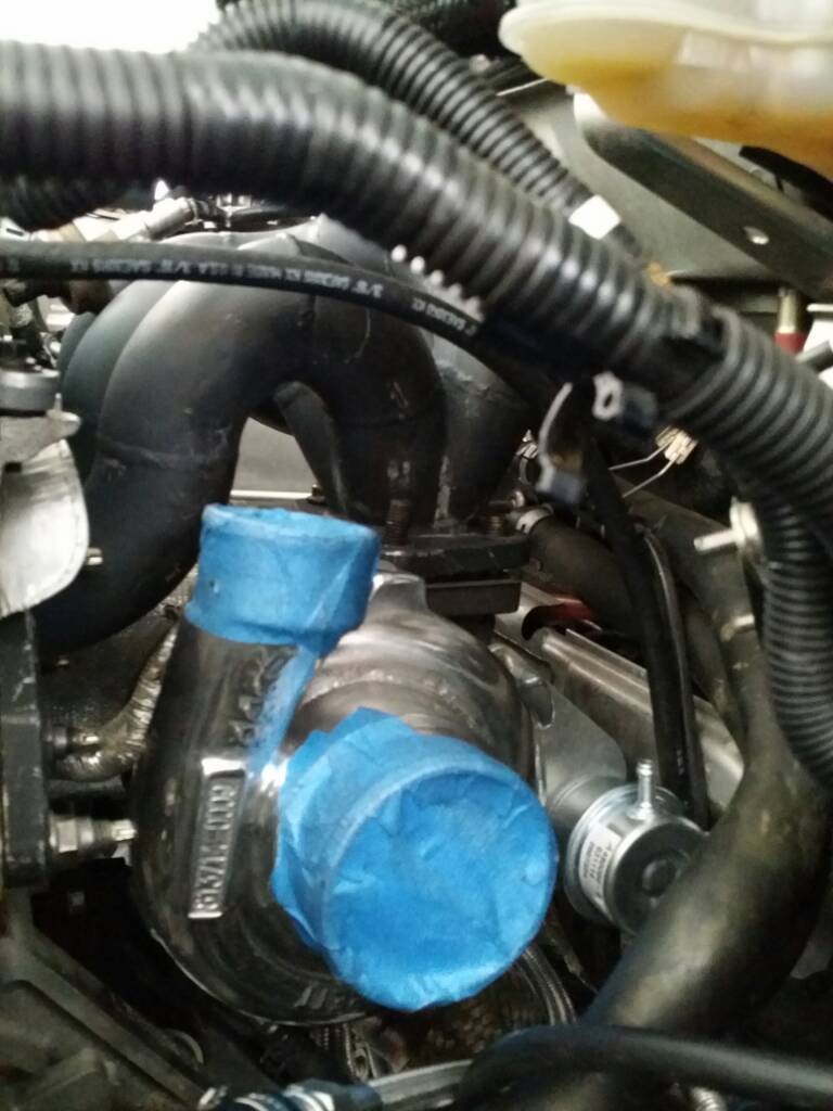

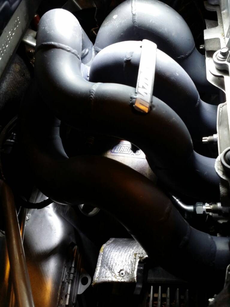

Had some time to work on the car yesterday. Here is a list of what got done.....
-Turbo is bolted to the manifold
-Down pipe is bolted to turbo
-Oil feed line is bolted to turbo (banjo bolt took a bit to get lined up)
-Oil return line
-Primary EGR
-Coolant feed and return
-Coolant bypass
-Throttle body TIG

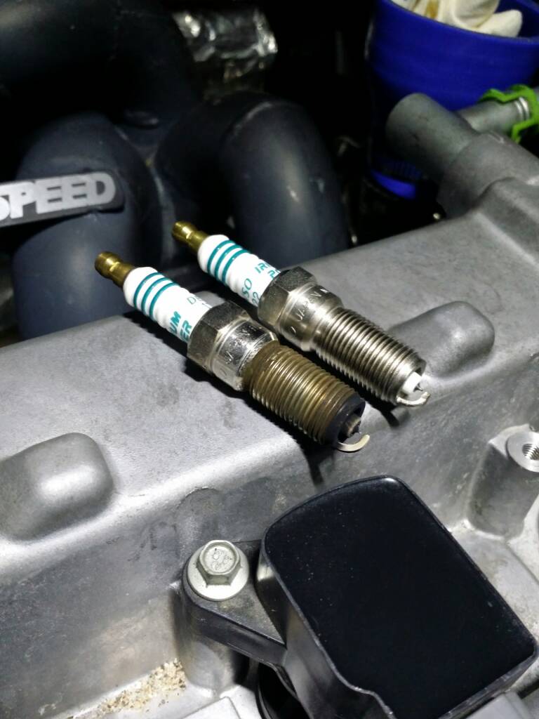

-Got the intercooler hot pipe figured out and installed.
-Installed new plugs

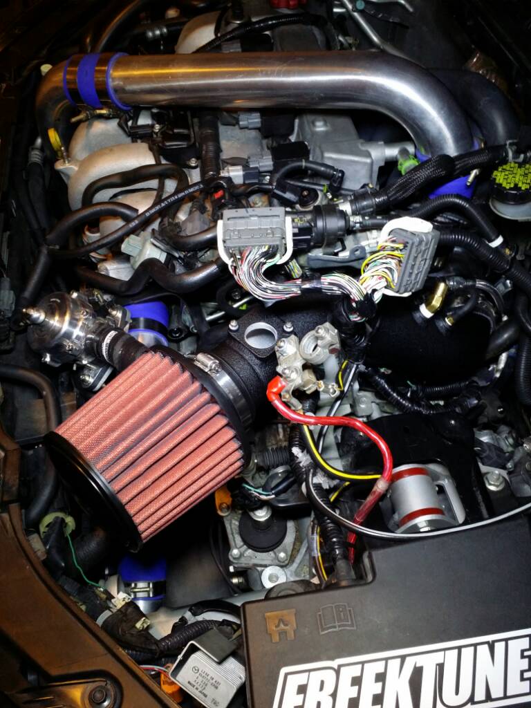

After working a 12 hour shift I grabbed a Monster energy drink and worked on the car for a few.
Intake is completely installed.
I do have a question. I deleted my primary EGR. There are 2 plugs on the harness that plugs into the EGR.
One goes to the EGR and will not be used, so where does the other plug go?
That entire harness is under the intake, so I hope I don't need it. Haha

the gray plug is egr.
the smaller black plug is the factory boost controller, which you'll need.
it's what you plug your ebcs into.

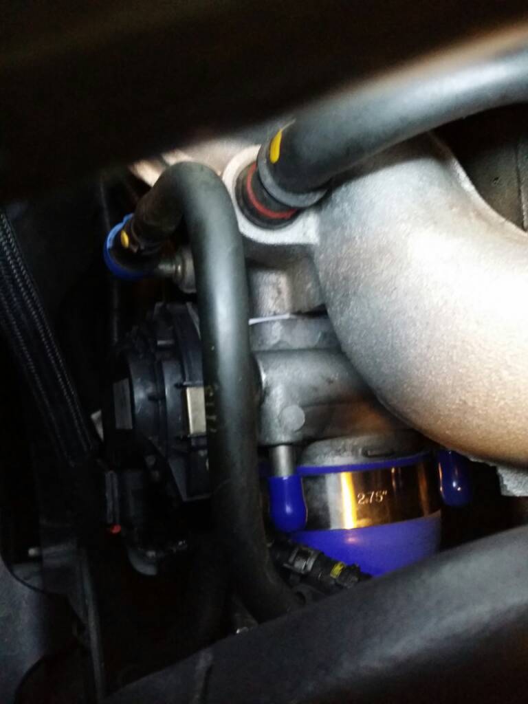

-Car cranked over on the 1st try. Thanks @Justin@Freektune; for the kick ass base Map. Now to get some miles on the car and get you those logs.
-Thanks to @smoogs12; for your help with the coolant questions.
-Car idled for about an hour, no leaks
-Those 2 plugs I mentioned are not plugged in anywhere. I will deal with that when the time comes.
-Drove the car 1.9 miles, only went to 3200rpms, 3psi of boost
Here is the only issue I need to figure out. When I installed the Turbo the Wastegate Actuator was touching the firewall. Now when I drive the car ONLY from 1st gear I hear a rubbing type sound inside the car. I'm assuming it's that.
Any help or feedback will be appreciated.
I helped install the same turbo on a friend's car and he had the same rubbing issue. It went away after the actuator rubbed completely through the firewall, haha. No problems though.
Engine
Handling

how did you hook up your electronic boost controller without using the black factory boost controller plug?
you have to use that plug...
it's how the car reads and controls the boost
i just saw you're using an aem true boost.
to be honest, i don't know anything about those and how they hook up.
so maybe it's different for you.
Yes. ..AEM does not have a source to plug any type of electrical component into it. It's all done with boost source. Im not a pro, but that's how it was hooked up before and got tuned.
That's why it was weird when I saw the 2 plugs just hanging there.

Enter the 36 Chambers
NoRegrets's Avatar
Location: Beverly Hills, FL
Posts: 612   (View Stats)
Rep Power: 1632
Thanks: 4,746
ahhh.
this is how my 3 port ebcs is hooked up.
you can see i had to plug into the factory plug in order for me to control my boost.

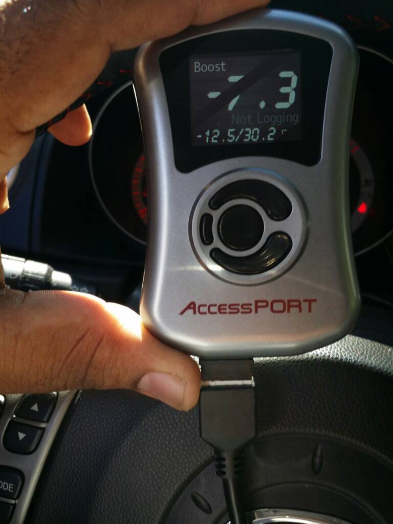

Thanks: 2,235
Still on Base Map, but popped a coupler while getting into boost.
Coupler fixed. Went to do some logging and car feels like it's hitting boost cut.
AP shows boost psi...
Waiting for results from @Justin@Freektune; about those logs.
NoRegrets likes this.
2008 Mazdaspeed3 GT
GTX2867r

Thanks: 4,746
I don't think a base map would allow you to hit 30psi... mine only allowed me to hit 15ish.
You might want to check out your connections for your wastegate and boost controller.
That 30psi spike is probably why you're feeling boost cut.
It could be maxing out.
I would just putt around until you hear back from your tuner.
Don't need any rods pulling ejecto seato's on you.
Tuned by Nishan

+1 For a wastegate issue/ebcs issue. I hooked mine up full retard and was getting 30psi by the time I could lift at part throttle.
DO NOT GO WOT until you get that shit dialed in.

Thanks for the heads up guys. Don't need this thing blowing up on my anytime soon.
I'm going to stay away from WOT for sure. All the connections up top look good. I have to make my way underneath the car to make sure all the connections down there all still hooked up.
