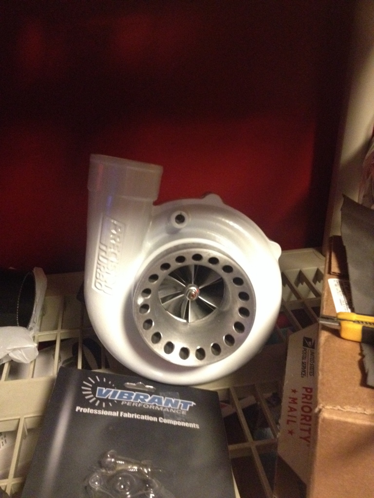

So as stated in the title, this is my motor build with the Precision 6262 turbo w/ .63 A/R hotside
List of parts for build:
-PTE 6262 (no I did not paint it purple, previous owner did lol)

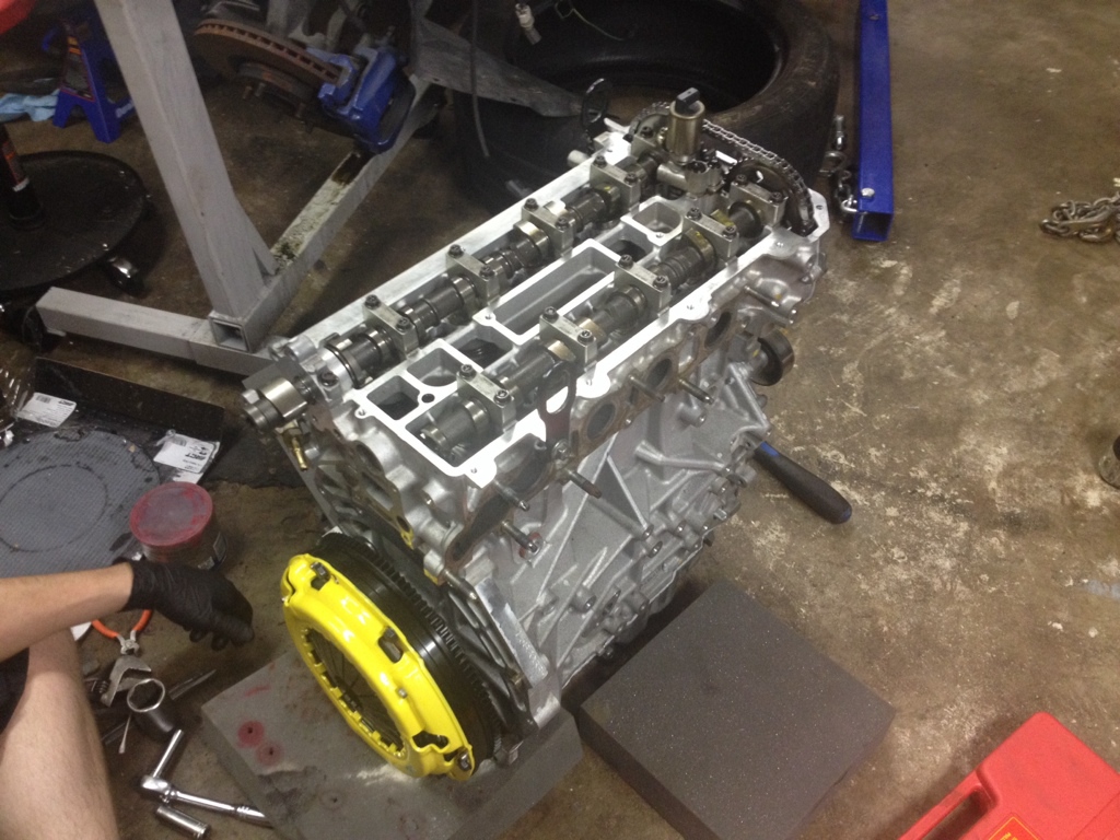

-ACT 6 puck w/ Streetlite flywheel

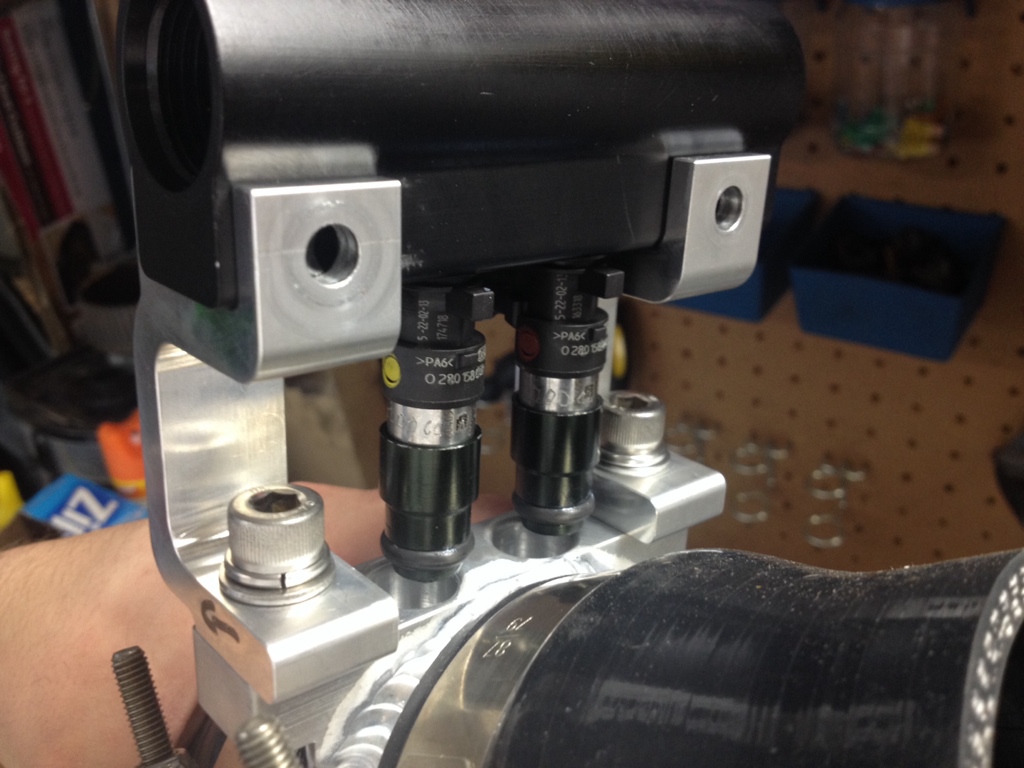

-Kozmic Motorsports 6th port w/ 1200cc upgraded injectors
-Devils Own 2.5 WMI w/ D10 nozzel

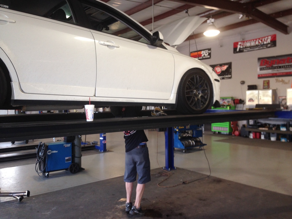

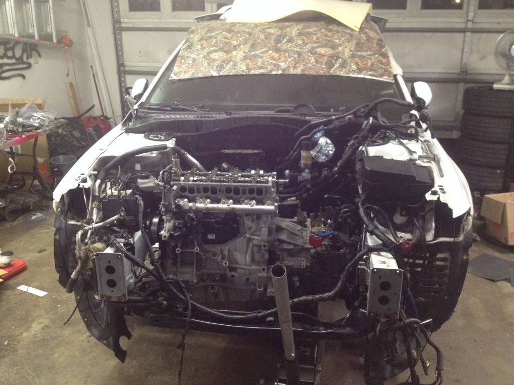

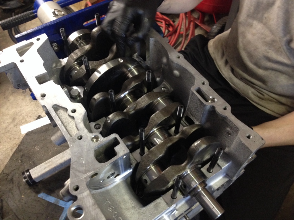

Engine removal:
Drivers side axle nut was no match
Motors out!!
Just a few hot spots...

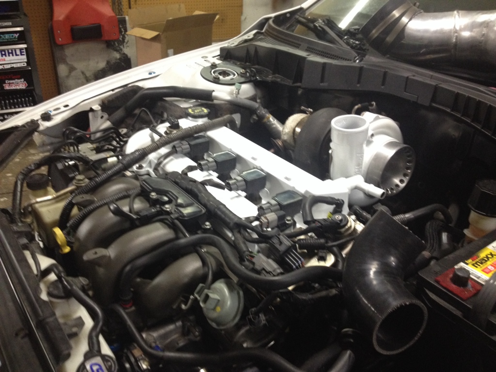

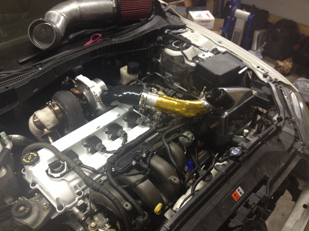

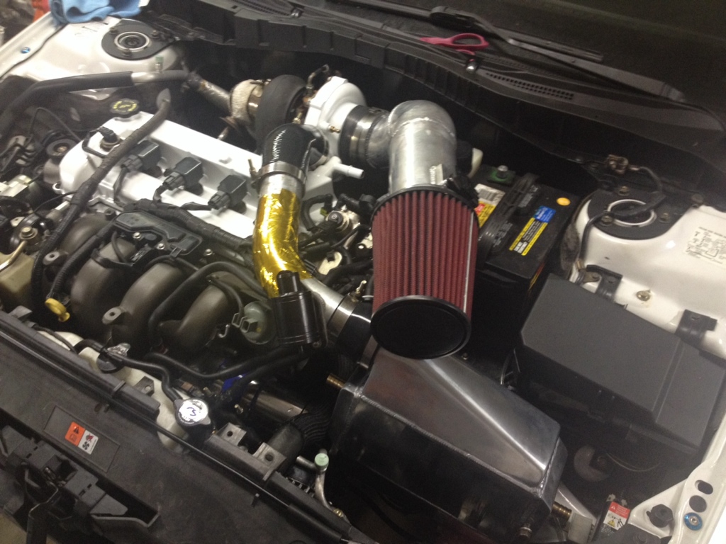

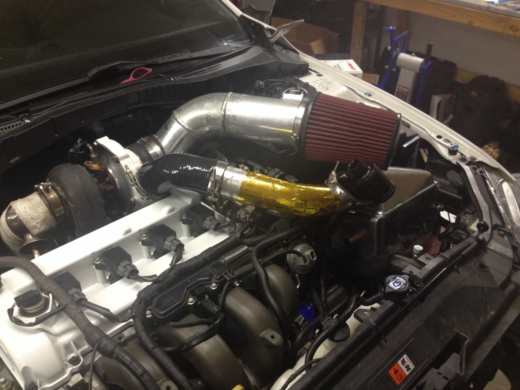

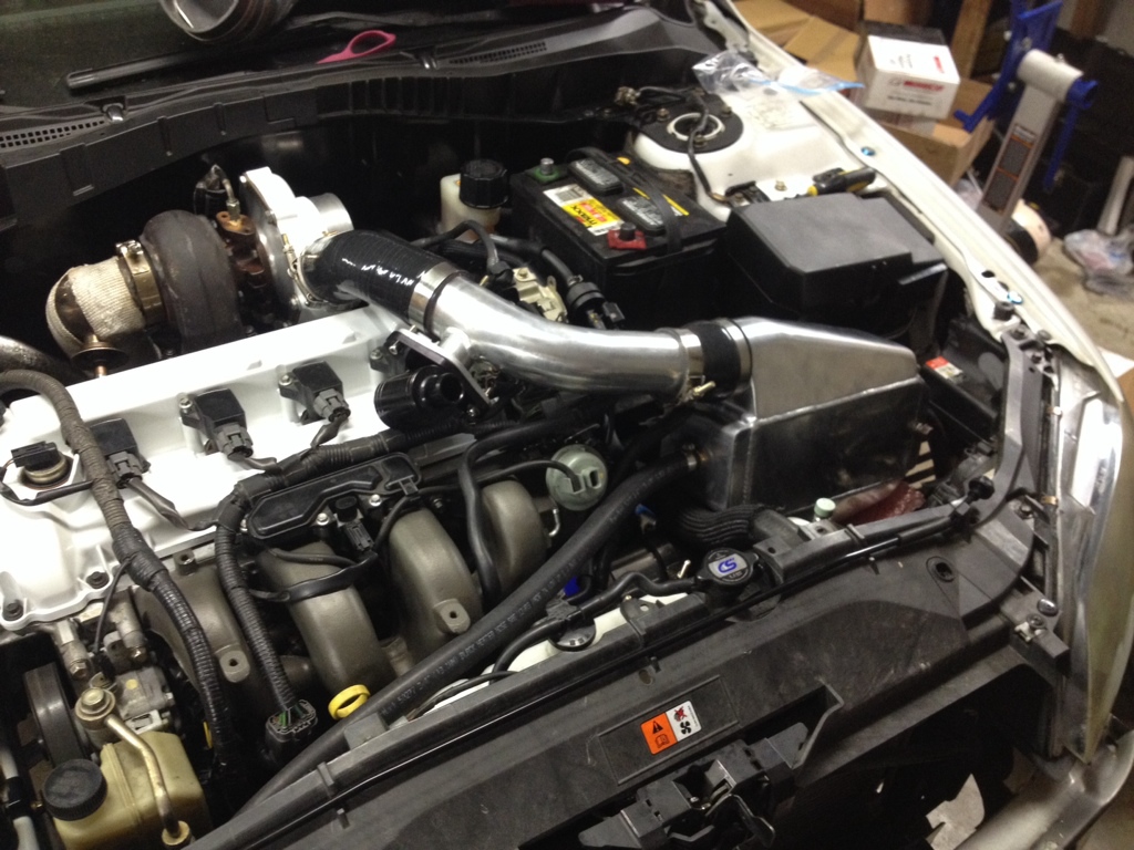

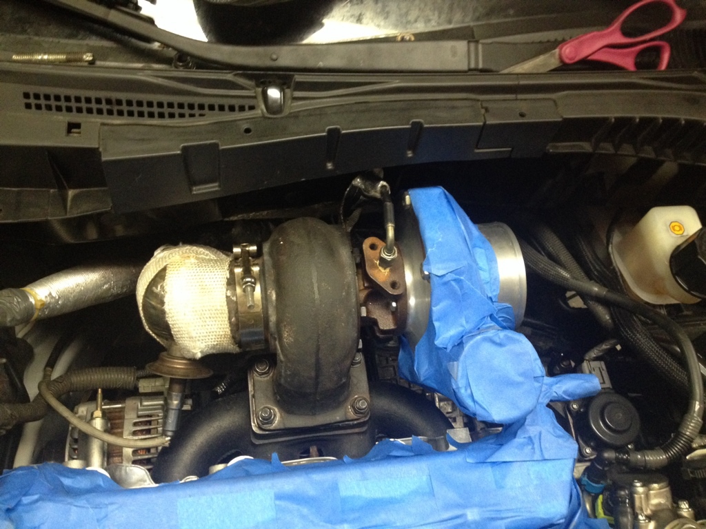

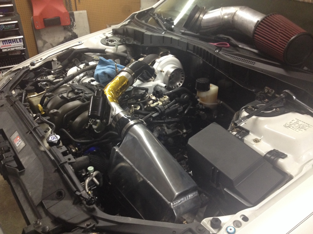

Mocking up the fitment
The top right hole on the mani doesn't quite fit so we had to widen it to go over the stud.
Also found out the flange where the turbo meets the mani could use a light grinding to match the turbo.
When we removed the motor the last bolt that came out was on the tranny mount. Had the engine hoist connected with tension, and the transmission sloped down and apparently hit the RMM bracket....ouch. Does anyone think it would be okay to bend back?

Um I haven't seen much on these cast top mount manis but the turbo seems to be sitting pretty far back from the block. Are you sure it won't contact the firewall?
This turbo setup was previously installed on a MS6. This is his car. Fit just fine. Don't see how his mani fit over those studs though lol. Definitely had to open one hole a bit more (giggidy)

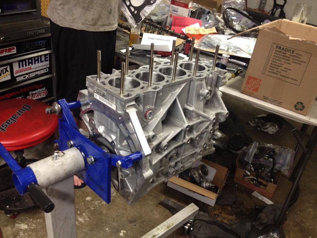

SMALL UPDATE:
Dropped the block off last week to get it bored out and the rotating assy balanced, and took the valve cover + compressor housing to get powder coated pearl white. Also sent my head to get the valve seals done. QUESTION: there are 2 different color valve seals that came in the rebuild kit. Does one color go to the intake valves, then the other go to exhaust? Or does it matter?
Gonna have it all back this week hopefully, and put it all together on the weekend!

UPDATE:
Sorry it's been a while since the last update, been moving into an apartment and am on vacation now, but I have some downtime now so I figured I'll post some new pics.
Cars up and running! Currently at 750 miles on break in, 250 more to go!
Freshly powder coated valve cover and compressor housing
Complements of my builder Robby
Fresh L19 head studs
Mounted
Taped the vlv cover and turbo so they wouldn't get damaged during install
Ran into an issue; the kit didn't come with the adapter for the injectors to fit onto the fuel rail, so I called David at Kozmic and he hooked me up with them!
Finished product!!
Haven't installed the 6th port just yet, waiting on motor break in, then the real fun begins

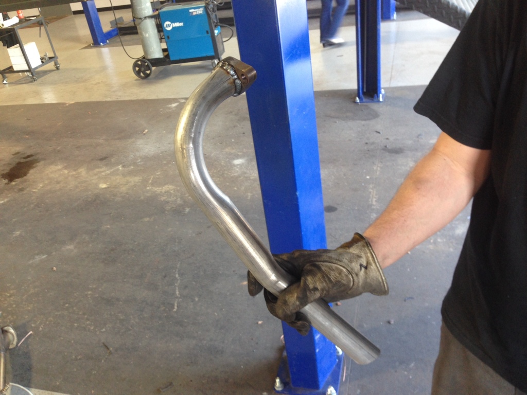

My builder got the car to the exhaust shop yesterday while I'm on leave in AZ, and had my dump tube made. Took only a couple bends, works great! He also changed the oil at 750 miles, and put the new map on from Freektune. Thanks a bunch Robby!
Going to install the 6th port hopefully Monday with @finalspeed; and finally do my first WOT log afterwards!
