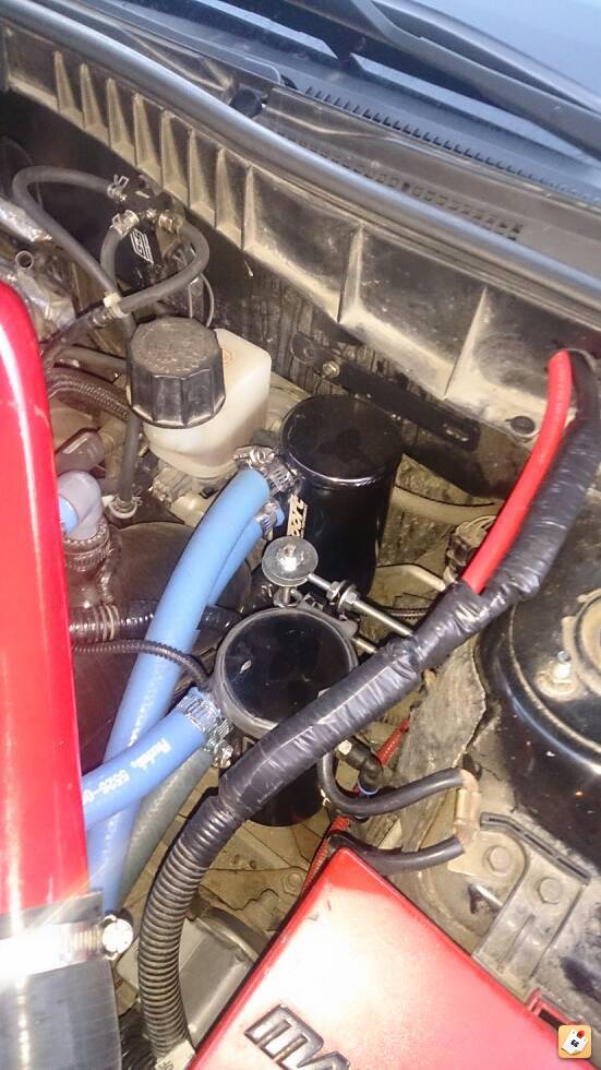

Did coolant bypass today. Took 1 minute lol
Also decided to check my catch cans. The catch can that routes back to the manifold seems to be doing it's job; the catch can routed to the intake is bone dry. Didn't catch a bunch so it has me mildly concerned that the position of at least the intake routed catch can is sitting too high. It seems like the larger the intake, the less sufficient the vacuum gets (could be just me...). I'm thinking there is an accumulation of oil at the lowest part of the pcv hose(s) but this could also be subject to how much blow by there is.
Can anyone add to this?

Indeed the larger intakes see less vacuum. However the intake can should be dry if you don't have blowby and the engine is running well.

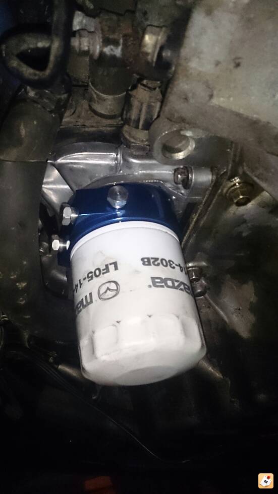

So I'm hitting a wall here for the winter I believe. Just did a fancy oil change yesterday....wooo

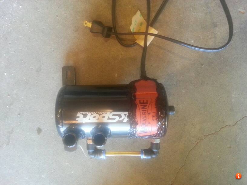

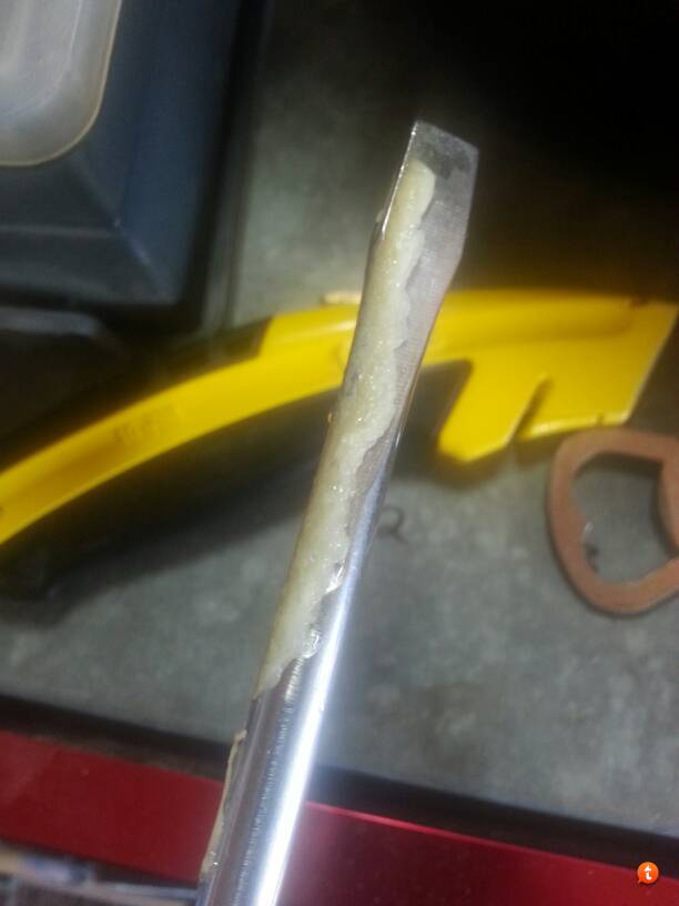

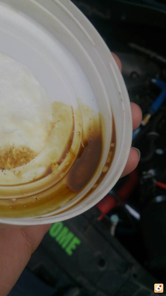

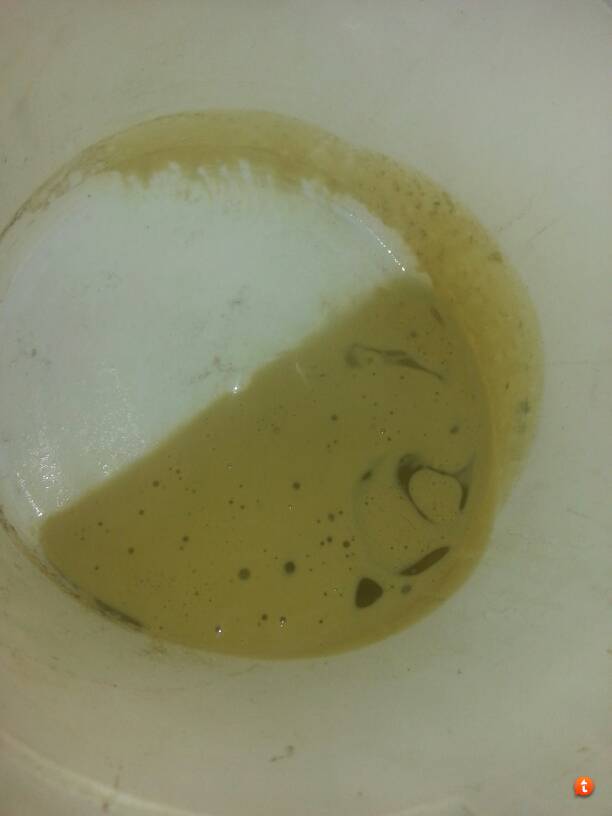

dead thread by now but waiting on the spring for WMI. So during the winter, I've been catching some frothy thick ahit in my catch can that looks kinda like bacon fat and mixed with water it looks like coffee. The hoses on my PCV system is a standard heater hose and not rated for oil/fuel so this is my first guest that the inside of the hose is being eaten away but still not sure. My car is running fine otherwise. Here's some pics of the poop in the can and what I scraped out of one of the hoses. any insight is appreciated.
The oil seems healthy checking the dipstick and looking other the oil fill cap. For those of you that don't know my PCV set up, I have the PERM plate w/dual catch cans. One for under vacuum and one for boost. My boost can and hoses attached are completely dry indicating good motor health. all the shit collects on the vacuum side.
and I also stuck on a heating pad for my catch can to take care of condensation and -40 weather haha.

I have seen the same here in Texas on a buddy's car...2 weeks ago. Stock PCV plate, single non vented catch can. Looked exactly like coffee with cream when it came out.
at first sight some people may think its coolant getting into the oil but I would have smelt that and my compression is fine.

Also remember that with cold temps you will get a lot more condensation and that will change what the stuff coming out of the catch can looks like.
good to know. I'm changing the hoses anyways because we've actually had a chinook roll in this week so it has felt like spring time which lets me work in my driveway It's like Vancouver's winter lol.
