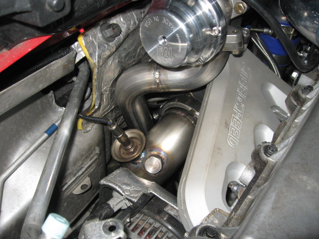

Dunno if this is the right area but i'm trying to get an idea of how many people are running t3's on their cars, or higher. I've been running my setup for about 10 months put almost 25k on it since then. I've been running a stock tune up until 2 weeks ago. i just bought a standback so well see how far this will go with a tune. Its a garrett clone with a 67 mm compressor and a .84 A/R hotside full 3 in and out. no dyno numbers but my quickest quarter is 13.9 @108, thats with boost cut in 3rd, 4th and 5th. Its pretty laggy of the line but i gain 20 mph from the 1000 ft to 1320. on the highway its nasty and i have pulled on c6's and srt-8's and new ss camaro's. Anyways just trying to get a feel for what other t3's look like in this community. thanks guys.

do you think that mani is helping or hindering the turbo? I know there were mixed reviews on the manifold. Dyno yet?

I think the with the infancy of our motors/tuning it doesn't matter right now but it will once the fuel pressure issues get solved and more power will be made. the runners arent equal and the ewg flange sits basically on the collector for extra added boost creep but it was cheap(thanks dark!). just got my sb so tuning as we speak and i will be at the Delirium Dyno Day in March with my vidcam so we will witness fail first hand!

wow nice setup. i would def get a new mani for no other reason but because its only a matter of time till phils gremlins come to haunt you.
Wait I'm the one who sent you down this path? My apologies. I can't remember did I sell you the DP aswell?

yeah they figured out the fuel issues so there is no where but up from here. or out the side of the block. wherever. i did run the bcd for a while with a map clamp but my turbo flows too much and i never got the maf flash so you gotta atleast tune thats what im doing not going for the fences or anything.
nah i had hector at exhaust depot build one for 200. he did that shit in 30 min. made my dump tube for 20. thats probably why theyre going out of business.
thanks man that setup cost me 2 g's for everything (it looks it!) yeah that thing creeps like a mutha. the wastegate does a good job but def need a new mani. i cant believe im gonna say this but RR has a hot looking T3 mani.

I'm surprised you got creep I'd blame that more on wastegate in my experience. What kind of WG is that anyway? I almost thought it was a bov I was like WTF lol
jgs 40 mm compact. i got it cuz it fit the firewall on that mani. had a tial but traded up. i hope its not the wg. i got it set for stock boost on a 12 lb spring so it should run 15-16 but it creeps to 18-19 in 4-6 gears. i wish i was around when you were getting rid of that turbo. that thing is nasty.

sounds like WG. Look at my tial if you get the special fitting they have for tight spaces you'll have no issues.
yeah i actually have the elbow from my old tial and that never crept just looked ugly jutting off to the side like that.

You of all people should know about function over form.

GT3582R T3, custom everything..lol..
No times yet, motor is not broken in yet. Should hit some big numbers.
that setup is probably the hottest ive seen so far. i like that intercooler piping. Hows that hks twin fire working out?
There is no intercoller piping in the picture...or were you being sarcastic?
nah i like that it doesnt go over the valve train but it is actually partly visible under the intake.
The ignition works great.. With the 2 step colder plugs I would sometimes throw a code for random multiple misfire but I haven't had it pop up with the ignition installed. I was shocked at how small it was when I first opened the box though...
i like the way you have it sitting. is that mated stock like that or is it a custom bracket?

It's a just a little bracket I made..
