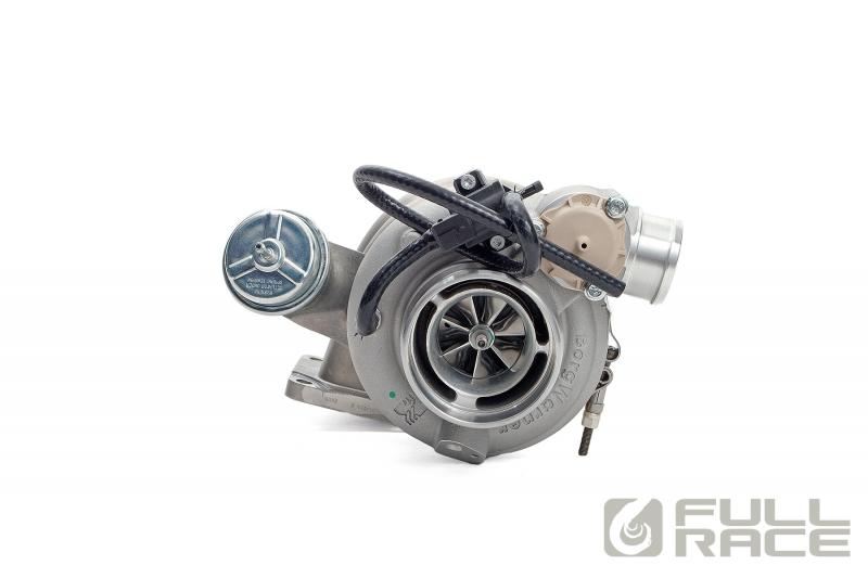

a friend just sent me this...BorgWerner's new EFR line...they're IWG's tho:
BorgWarner EFR 6758 Turbo
EFR 6758 is a versatile turbocharger with very large map width for outstanding power potential even at high boost - and does it in a small package. This is an excellent turbocharger for autocross, rally, drift, road racing and street driven applications. This turbo uses a 67mm OD compressor with a 53.9mm inducer to support a remarkable 49lb/min max flow rate. The low inertia 58mm Gamma-Ti turbine wheel is the optimal match for the FMW compressor wheel. EFR 6758 uses the smallest-sized EFR compressor housing, fitting in the tightest engine bays particularly twin turbo V6 or V8 applications. In twinscroll T4 configuration, the 6758 delivers mindblowing fast spool and response while working well on stock and modified engines. Ideal for use in single turbo applications for the 300-490hp range, or as twin turbo applications 550-900+hp. Ceramic Ball Bearing only, watercooling recommended (not mandatory).
Compressor Specifications
■Compressor Wheel OD (exducer): 67mm
■Compressor Wheel Inducer: 53.9mm
■Max Flow Rate: 49 lb/min
■Built-in BOV: All EFR compressor housings incorporate an integrated BOV.
■Compressor Housing: 2.5" inlet, 2.0" hose coupler outlet
Turbine Specifications
■Turbine type: Low Inertia Gamma-Ti Turbine Wheel
■Turbine Wheel OD: 58mm
■Stainless Steel Investment cast Housing
■0.64 A/R T25 undivided (Internal WG)
■Turbine outlet: GT-Vband (aka small 3" vband) ~92mm OD for all EFR turbos
Features
■Dual Row Ceramic Ball Bearings - lowest friction and fastest spool/response, most extreme durability, built-in oil control orifice - (aka oil restrictor) **no restrictor can be used with EFR turbos
■Watercooled Center Section - watercooling is recommended, 14mm banjo bolts
■Double seals on both turbine and compressor end for extreme durability and resistance to any oil seepage
■Boost Control Solenoid Valve Integrated to Compressor Housing
■Integrated Speed Sensor mounting provision

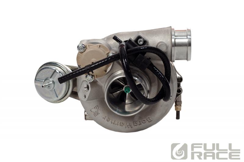

This is I guess their real big turbo...
BorgWarner EFR 7064 Turbo
EFR 7064 is an excellent turbocharger for drift, road racing and street driven applications. The 7064 delivers incredibly fast spool and response while working well on stock and heavily modified engines. The 70mm OD compressor has a 52.2mm inducer and at 56lb/min max flow - there is potential for 560hp - unheard of for this size compressor wheel. The low inertia 64mm Gamma-Ti turbine wheel is the optimal match for the 70mm FMW compressor wheel and is capable of 45+psi boost. This turbo uses the mid-size EFR ported-shroud compressor housing, great for fitment in cramped engine bays. Ideal for use in single turbo applications for the 350-560hp range, or as twin turbo applications 650-1000+hp. Ceramic Ball Bearing only, watercooling recommended (not mandatory)
■Compressor Type: Forged-Milled Wheel (FMW) Extended Tip ** picture of EFR 7064 compwheel
■Compressor Wheel OD (exducer): 70mm
■Compressor Wheel Inducer: 52.2mm
■Max Flow Rate: 56 lb/min
■Compressor Housing: 3.5" Ported shroud inlet, 2.0" hose coupler outlet
■Connections:
■Inlet: 3.5" Hose Coupler
■Outlet: 2.0" Hose Coupler w/ integrated Vband option
■Turbine Wheel OD: 64mm
The EFR 7064 is available in (3) different turbine housing configurations:
■0.83 A/R T3 undivided (Internal WG)
■0.92 A/R T4 twinscroll (Internal WG)
■1.05 A/R T4 twinscroll (External WG)
Features
■Integrated Speed Sensor mounting provisions
That IWG is a work of art compared to the shitty ATP setups...
That would make a great BT for someone not wanting to deal with the EWG headache...
