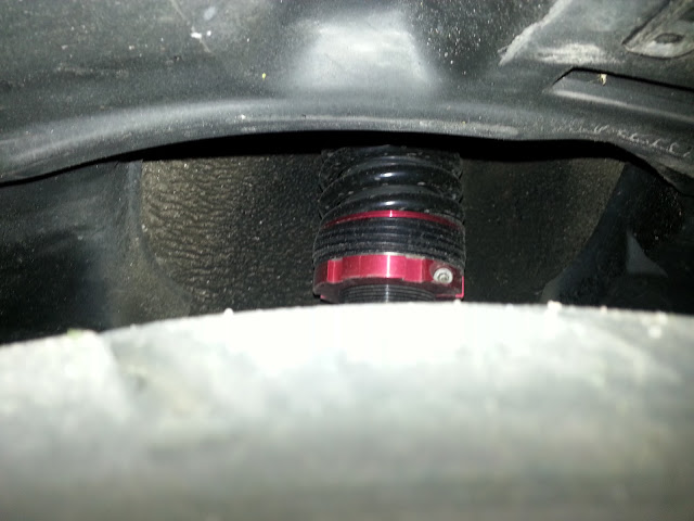

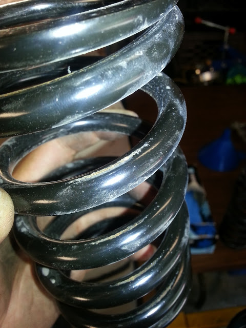

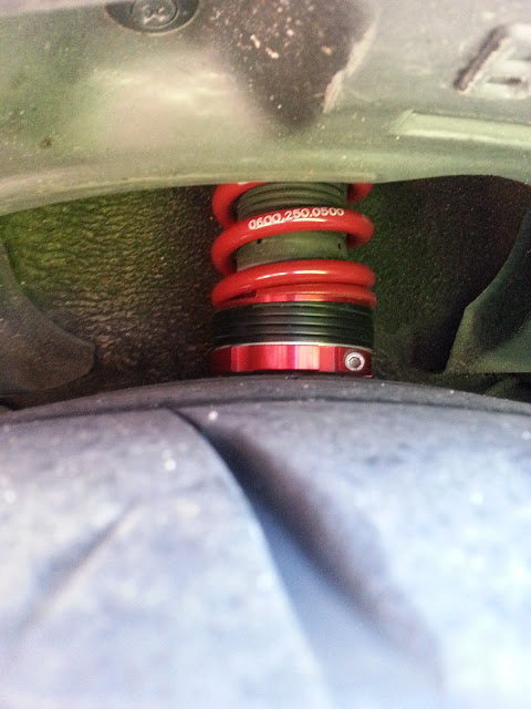

We have changed all 3 sets of Coilovers that were experiencing the issue to the springs that Paul mentioned in the Development thread - Eibach 2.5" ID, 6" length, 500 lbs/in (0600.250.0500)
Before, sitting on the driveway:
Spring removed, you can see the rusted parts from where the coils were making contact while blocking:
After, sitting on the driveway:
These springs ride MUCH better. There are no more noises that were previously chalked up to "because coilovers, bro".
I can take a speed hump at 40 km/h with no horrendous bang like before and they are also, dare I say, comfortable

Now on top of there valving stuff because the springs block up under compression all that load is transfered straight to the wheel bearing and bushings. My AIM logger has me pulling 1.32G around some corners. The track I was last at has heavy loads on the driver side, that could be why I only had end link issues on one side. Also the wheel bearings were not designed for this type of loading and are now groaning on the highway. Those will another $500 to replace. On top of that I need a new end link and to fix the sheet metal and paint where the end link rubbed through.
I hope some of you now understand why this pisses me off. I accept your criticism that I should have called before making the post. The last time I called it was weeks before I heard back from Corksport. So being a Saturday night I was not waiting until Monday to let this be known.
During some measurements and calculations these springs have about 30mm of travel. I drive on the highway go over a dip in the road something not even it bad and the bang is so loud and harsh my rearview mirror moves so much I can. See my shifter in it. I emailed about this and heard nothing. Derrick posted in another thread the correct spring length was 6" that's still not enough travel. These were supposed to be track tested and made to hold up to the abuse I was going to put them through. At this point I would have been better off with Raceland coilovers.

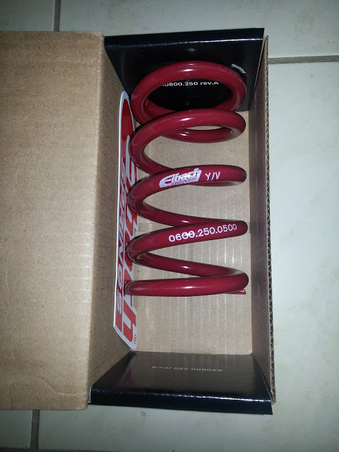

OK I think I found the spring spec I was looking for.
But @MajesticBlueNTO and @Celestspeed3 didn't provide how they did set up the car height with the adjuster ring to get the car as lower and closest to the height, the original springs from this Kit.
Can anyone of you guys who ran this Eilbach spring confirm the following:
1) What helper spring goes with this Eilback 2.5" spring? Is it what cames originally with the Corsport coilover kit?
2) How did you adjust the height to get the car's height lower than stock.
Those are the 2 questions I'm trying to solve now. And I'm running out of time because the first events are starting already this coming weekend and I'll need to hit the alignment shop again after the install.
To anyone who can give some heads up, please feel free to chime in so I can get the car ready for this racing season.
Thanks

So is this how you guys set up the helper springs with the Eilbach?
Is the helper spring supposed to be all the way compressed, static, like in the pic below?
This is what I'm trying to figure out.
Thanks for your answer:
So the original springs that comes with the corksport coilover kit drops the car lower than stock.
I mean to get a similar car height achieved with the spring that come with this kit.
Do you guys have more pics of the car, so I can see how low is the front on the car and also a pic of the front coilover like the one Paul posted with the Eilbach spring + helper spring?
It'll be greatly appreciated.
Thanks

Ii guess I'll drop the 9K spring and go with the Eilbach spring + helper spring.
Hopefully this should solve the stability I'm trying to achieve on the front.
9kg/mm = 503lb/in. Was it a longer spring?
Edit: If it's a no name brand spring, the rate could be WAY off.
Yeah, it was a longer spring. Longer than the Eilbach in this pic and longer than the one that comes with this kit.
What I did was trying to take out the helper spring to get the car to an acceptable height, since the front was way too high. But by doing this, the 9k spring was not being compressed when not install on the car. And when installed, the only way I could get some compression on the spring, was to set the adjuster ring pretty high. Therefore this will cause the car to be up very high once the car is of the jack.

BTW, where to get those Eilbach springs?
Thanks
 Old 02-03-2014, 10:52 PM   #140
Eth Fiend
phate's Avatar
Location: Auburn Hills, MI
Posts: 6,947   (View Stats)
Rep Power: 11231
Thanks: 14,868
Good call. The shorter spring with helper is the only decent way to solve that. Calculating proper spring lengths isn't as simple as it sounds, lol. I think I've figured out what my 6 needs (finally, heh).
Originally Posted by bertrand_CX_7 View Post
BTW, where to get those Eilbach spring?
Thanks
Any Eibach vendor should be able to get them. I prefer MAP for most everything, but I'm sure Edge and the like have them, as well.

Can anyone confirm? This is what I got before installing the suspension on the car.
Is the height on the adjuster ring about right?

Looks about right to me.

Ok have the front struts in. Height is really close to what I got before. I'll adjust it first thing tomorrow morning before hitting the alignment shot.

Give some feedback here. Car feels incredible balanced with the 500 Lbs spring. This is how it should be.
I'm loving it it again...... On the top of it new clutch.
