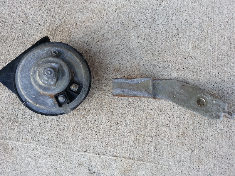

The amount of damage that the coils blocking up and causing the horrendous bang is no laughing matter...I have wheel bearings stashed away in case.
But there are times when damage is almost comical.
Shortly after the install of the coilovers, I noticed that the horn was making a sound like an ailing cat when I locked the doors getting home from work one night.
The next morning, on the drive to work, I went over the unavoidable rough patch which causes the same loud banging. After getting to work, I locked the car and pressed the button three times to hear the horn (I'm OCD like that) and there was no horn.
Today I went to change the horn and I saw it hanging...why was it hanging? The horn bracket broke...
I can't wait for those new springs to get in... 7k (392 lbs/in) is too soft for a 6" spring on the speed3. It may be perfectly fine on a regular 3 but not on a speed3.
MajesticBlueNTO is offline   Reply With Quote

Well I think 9k springs would be great for daily and 11k for track.
