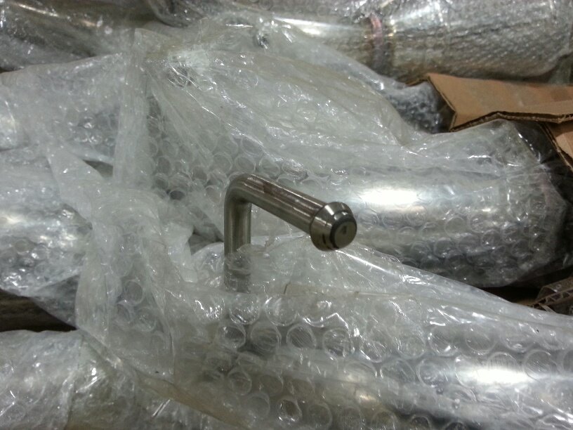

Originally Posted by Littlescroll View Post
Not sure if that was directed at me but I can tell you the only issue I had was that I was missing a spacer/donut on my racepipe that caused the mid pipe section of the exhaust to butt up against some heat shielding in the exhaust tunnel causing a minor rattle. Once we put the spacer on it it sat perfectly and the hangers are all good.
No, it was not really directed at you, but since you answered....
The hangers are not all good, if they are still using what amounts to stainless brake line tubing for the hangers. I had a local down at my place to do a brake job and rear motor mount and this is what I saw. As you can see in the picture, there is no evidence of an impact to the hanger.
I have installed many exhaust systems over the years, and when I saw this...well, I could not believe an after market company would use hollow tubing instead of solid round stock.
When he emailed and called Corksport to utilize the "2 year warranty" they told him to go to an exhaust shop and have it welded and they would only reimburse him $35 for repair. Re-welding this hanger at the point where this broke is not an option as it will only make the metal more brittle and it will break again.
Well obviously I know nothing of past issues with that, but I can tell you that the hangers on this system appear to be completely solid and are very sturdy.
Are they hollow tubing or are they solid?

 Old 03-21-2014, 10:56 AM   #21
jrotaryb's Avatar
Posts: 416   (View Stats)
Thanks: 118
I'm 99% sure that many OEM exhaust hangers are hollow as well. My 06 Civic SI had hollow hangers off the main cat (i.e. a heavy item) and I'm pretty sure the Evo X has hollow hangers as well (I'm sure to cut down on raw materials costs).
We all know there are lots and lots of Corksport exhausts out there and to my knowledge this isn't a widely reported issue. Some times stuff just happens... In all my 17 years of modding every car I've owned, I, right? Try to keep the mindset that anytime you break free any factory seal/bolt/screw or replace any part, expect that you may have to re-visit it in the future regardless of the price/quality of the parts you have and/or who put them in.
Exactly, there probably is a bunch of these out there, but that just reinforces that this problem was from a craftsmanship issue or a material issue. They (corksport) wanted him to have that hanger welded, which is a no go after it has broken that close to an already existing weld. It simply will not hold.
We make revisions and changes to parts quite often based on feed back from customers, things that have concerns, or problems.
They make revisions for a reason, and I understand why companies do this. But why not send a new style hanger out to help the customer?
I looked at the stock on the shelf for the MS3 racepipes and they are hollow like the one in the picture which is broken above. It is really odd to see a hangar break.
To keep this simpler with less people (Me or any of the other sales people) in the mix Tom should talk with Kelly here @ CS. She is here to help.
-Derrick
He did, he talked to Kelly at the beginning of this week, and her solution was to have the bracket welded and CS would pay up to $35. What I am trying to get across is that having a weld put back on an already fatigued piece will result in the same outcome it is in now, broken. In my opinion, it looks like the weld was too hot and made the thin tubing brittle and it finally snapped.
