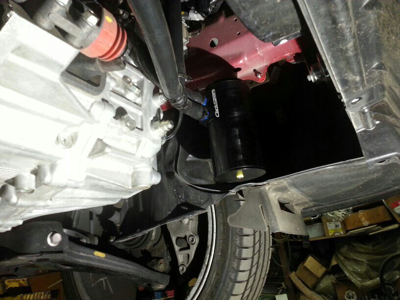

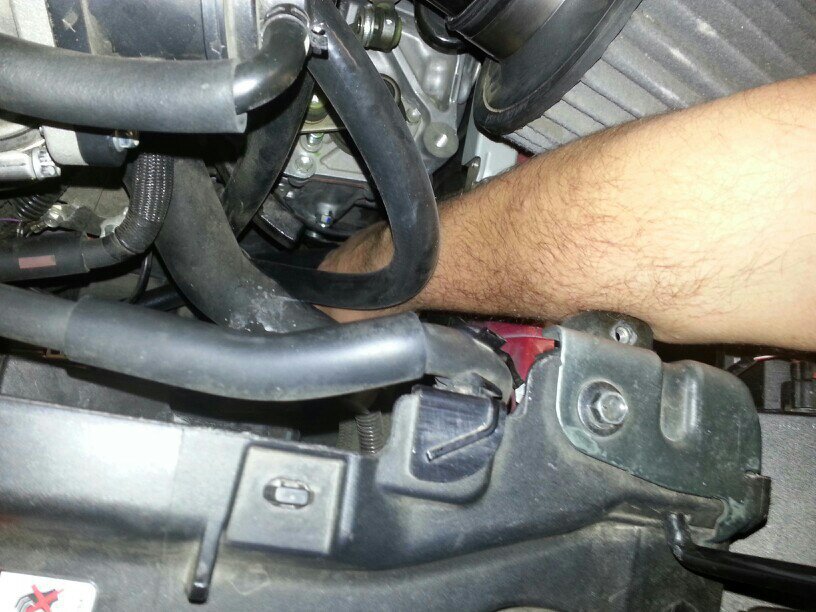

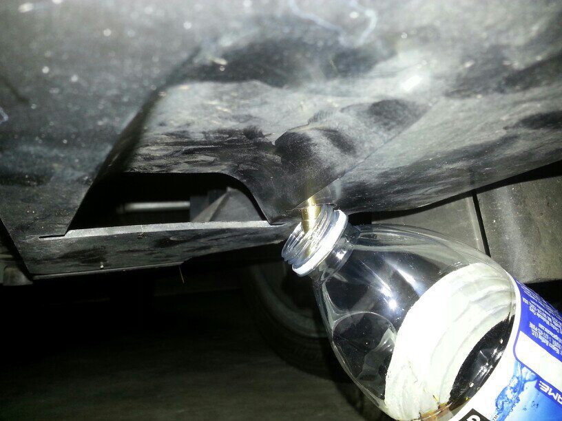

I finally got around to installing Corksport's new catch can they released a few months back. I figured I would share my experience with this contraption.
The new design of the can looks great, and I thought the built in dip stick was a neat idea. I was a little sceptical of how the hoses were routed with the IM being plugged and using the Intake as vacuum source for the PCV & Valve cover Breather. I ignored any doubts that were building up in my brain and preceded with the installation. Corksport's instructions were very clear and easy to follow. I liked how this catch can bolted directly to the frame utilizing unused factory nuts. Installation took about an hr or so.
After the installation I started my car and drove home. I pulled out my AP and monitored my fuel trims, they were normal. When I got home I let my car idle for a few minutes as I looked at my AP and I noticed that my car was idling incredibly smooth. My car has always had a rough idle, and I have been trying everything in the book to smooth it out. I guess the CS catch can was the fix my car needed.
After a few hundred miles my car started smelling of fuel which means its time to empty. so I emptied my catch can like so... and got this
I am amazed of how much crap was going into my IM. I could not be more satisfied with the results of this catch can. I recommend this to anyone who do not already have a CC.

Why do so many people insist in dumping their catch can where they shouldn't? I just put it in my oil collector and then when I do my oil change, I take the oil to get recycled with the catch can shit inside of it.
Don't worry, its usually in a bottle or my Girlfriend's Tupperware. The main reason for the solenoid is because I am back on the stock intake, and it is too much of a PITA to empty.
Then again a dump to ground would be fun too. But don't worry I'll only pull a Herbie in front any rice and/or Prius.
I drain mine into a water bottle so I can see how much it collected and what it looks like and then dump it into the container of used oil waiting for recycling. I though everyone bumped theirs in with the used oil.
