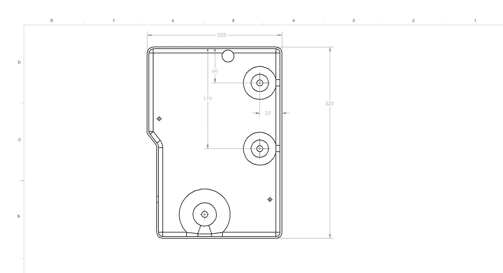

Any chance you could get the measurements indicated in the picture below? That will tell me if it will fit with my HTP 3.5" intake.
Ask and you shall receive.
That is the final size of the box. There is more than enough space for a 4" intake but it all depends on the routing of the pipes.

Brydon, do you know how this compares with the unit I have? Is that a hole up front for wiring, or venting? It isn't there on the version I have. I curious what revisions have been made.
 Old 09-23-2013, 01:58 PM   #21
It is actually for a bent bracket on the body of the car. They seem to vary from car to car so some touched the box. Dual purpose would be a drain if anything ever went wrong in the box.
The major difference between yours and the final product was a little length and the added hole. The hole for the main power wire was also enlarged slightly so you could send all of the wires from the relay box through the battery box if you really wanted to tuck all the wires away. Other than that the boxes are very similar. We also added laser cut tie down bracket.

Alrighty. I've got more pictures and more information.
First off, the top. The top does overhang and leave a tiny gap, however there is trim tape on the underside of the cover, preventing this from being for ventilation. But the back of the cover is open, as you'll see in pictures. I imagine this is mostly for ease of removal, but could also provide venting.
Next up, dimensions and clearance. I measured and converted all of the dimensions CS provided, and added it to their provided drawing. I also took some pictures of clearances with a tape in pace, as well as noted them on the drawing.
Let me know if I didn't get everything needed.
EDIT: The pictures of clearance for an intake are pretty dark. I can take better ones with more light tomorrow. There is about 5 1/4" from the engine side of my CS Intake, to the edge of the box. About 3 3/4"-4" to the wire harness, but that only matters depending on the location and piping of the intake. The higher the piping, and there is more clearance.

Last night I got installed a new 3.5" HTP intake with the early version CS ECU Box I have. So I imagine that the more flexible silicone of the JBR 3.5" would fit with this box as well.
It is very tight. I should mention that I also recently installed the new cs bpv. It is noticeably shorter than the Turbosmart I was running. Didn't take measurements of that, but as you can see the filter just about touches the BPV, so keep that in mind if you're still TMIC.

wow that is still some tight space there, I know with the jbr battery relocate kit you have a lot more room, but you also run a 51r batter which allows for more room to.
