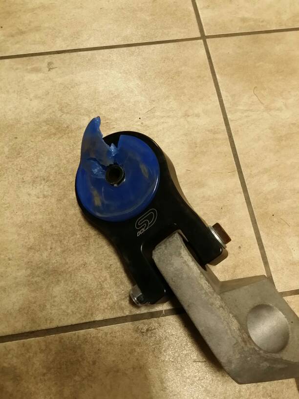

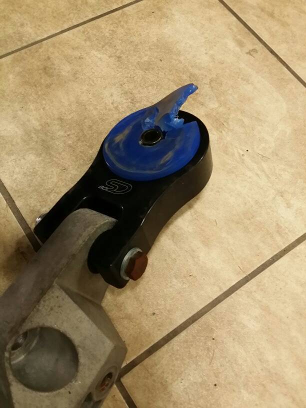

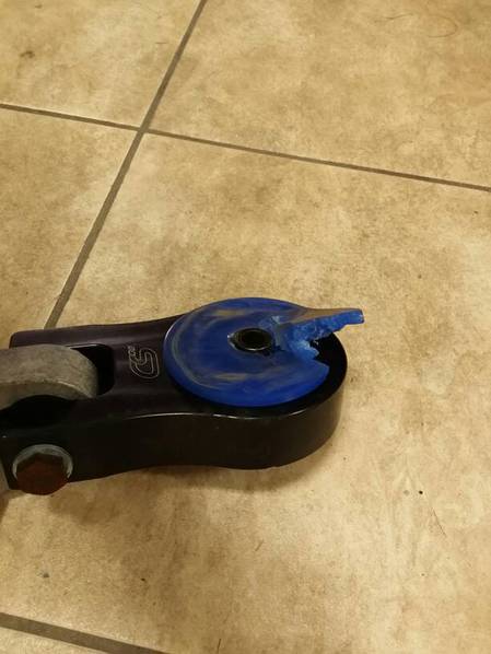

Default Race rmm bushing failure
Hit the track last night for the first time on the nexens the dealer put on my car, had 1 decent launch of a 2.21 60ft and it hopped pretty bad, did this to my rmm
anyone else had an issue with the bushing ripping out? it was torqued properly and installed properly

Call them first, they will for sure take care of you. But the fact that it broke and your not pushing crazy power or on slicks......... hmmmm........

im sure they will help me out, i posted bc i didnt know if this was a crazy thing to happen or not.
i have a test pipe and was on meh street tires. didnt think this should break like that

If that happened to your rmm I hope you checked your transmission mount for damage. The oem is pretty weak.

Put the om rmm back in. Beat on the car and all seems normal.

just spoke to kelly, harder bushing is inbound, i <3 good customer service

got the bushings in today, put them in this morning. the harder ones def have a bit more nvh, but less play in them.
im happy with the customer service and the parts.
stuff breaks from time to time, good companies know this and take care of it when it happens.
