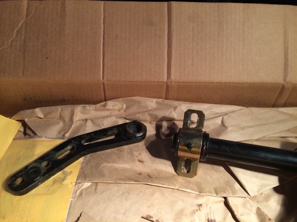

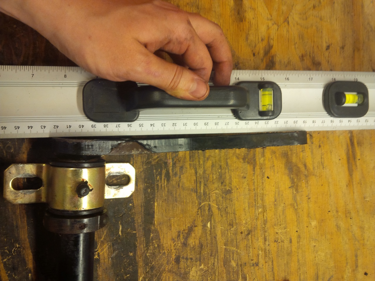

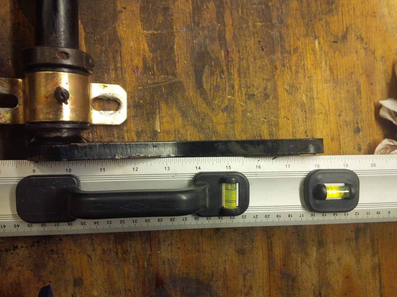

I've had some clunking in the rear end for a while that I've been trying to sort out and couldn't find what it is. Had checked near on everything and all looked good and was tight. So since I still have my extended warranty on the car I decided to remove my Corksport RSB (only suspension mod), put the stocker back on and take it in to Mazda to deal with.
Well...as I'm cleaning up I notice something a little odd.
That's a little off eh?
Yup other side looks good...
I wonder how out of square that is....WOAH

That doesn't look like a defect to me... Looks bent from some sort of impact
Well obviously it didn't come like this from Corksport many years ago lol...that said, I've never had anything happen to the car that should have caused this. Car is just daily driven, never tracked, hasn't taken any big hits, stock suspension otherwise, only probably 30,000km on the bar itself, etc. Seeing the amount of deflection I'm shocked that the endlink isn't broken or bent or anything from it as I would have expected it to be the weak point.
No matter, it's just an FYI post...not blaming corksport for this.

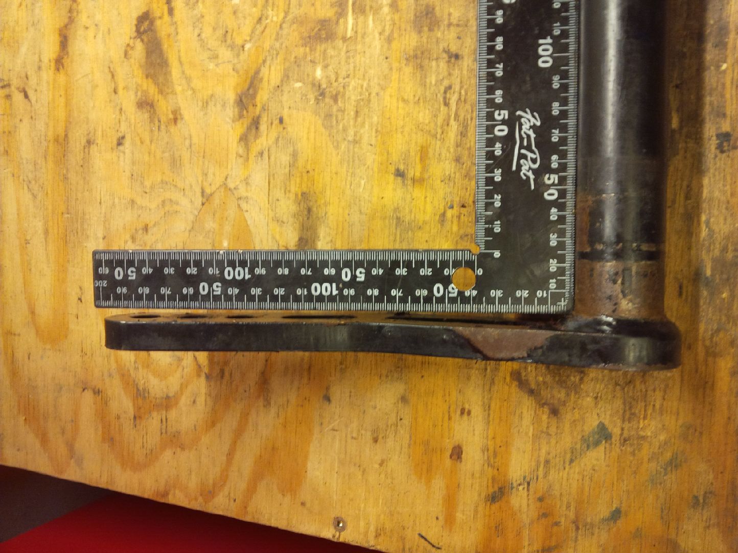

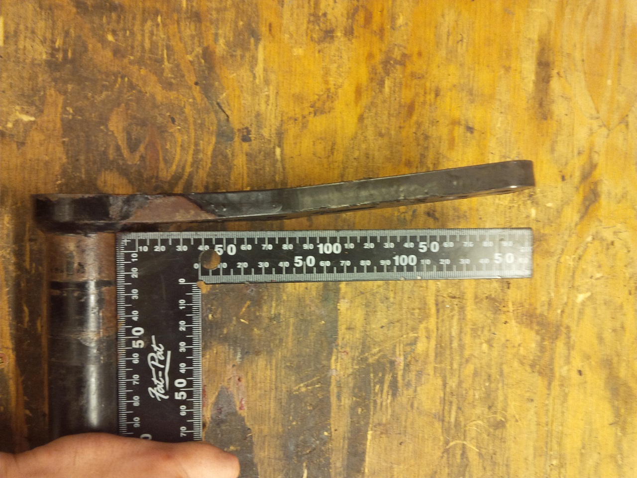

Well, now that I have a new (scratch and dent) bar on the way I decided to see just how much effort it would take to straighten the bent bar back out.
Surprisingly not much, a few minutes in the vise and some muscle and I was able to get it back to almost right on. It's good that Corksport changed the design, the 1/2" steel plate isn't that tough at all. I have no doubt in my mind now that the forces applied while driving without hitting something would be enough to have caused the bend.
