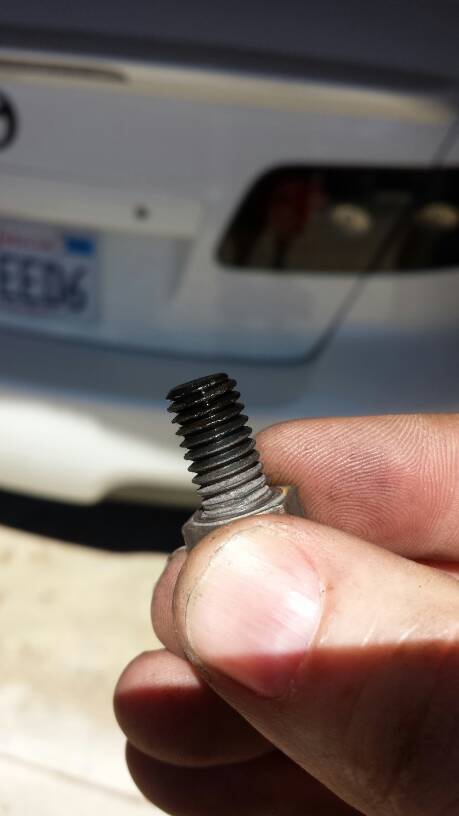

I was prepping patient for surgery today. I pulled the heat shield off and pulled the egt probe from the header (preturbo). Thing was oil soaked.
I am 99% sure that all of the oil is a product of a major failure in #2 and possibly a bad pcv. Motor is in Monday and surgery begins Monday.
