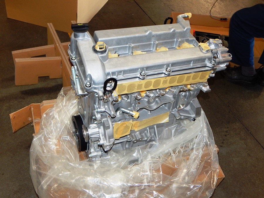

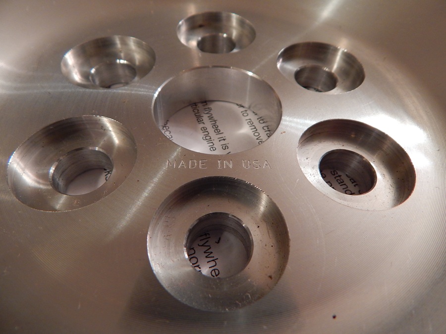

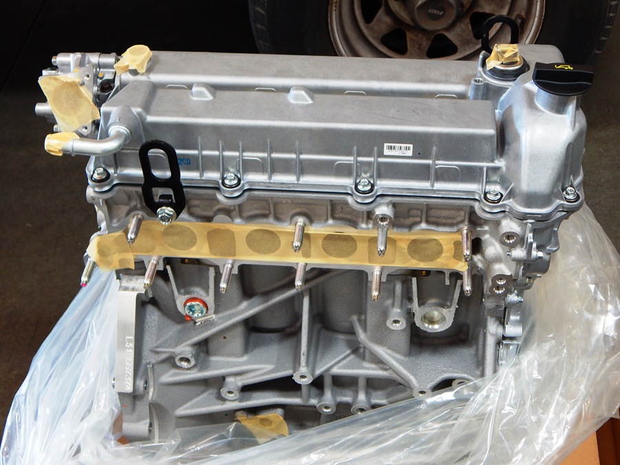

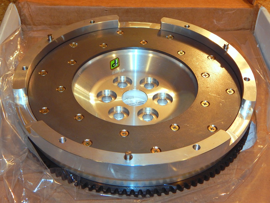

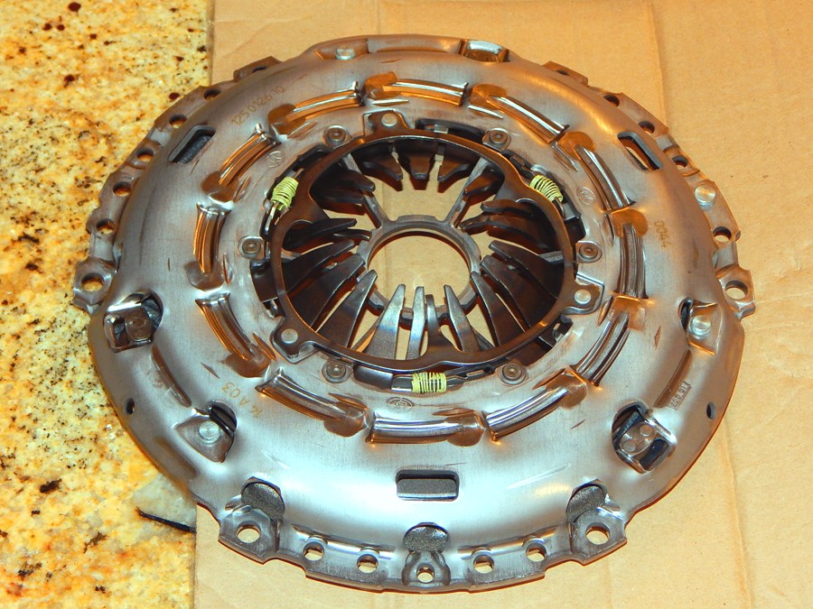

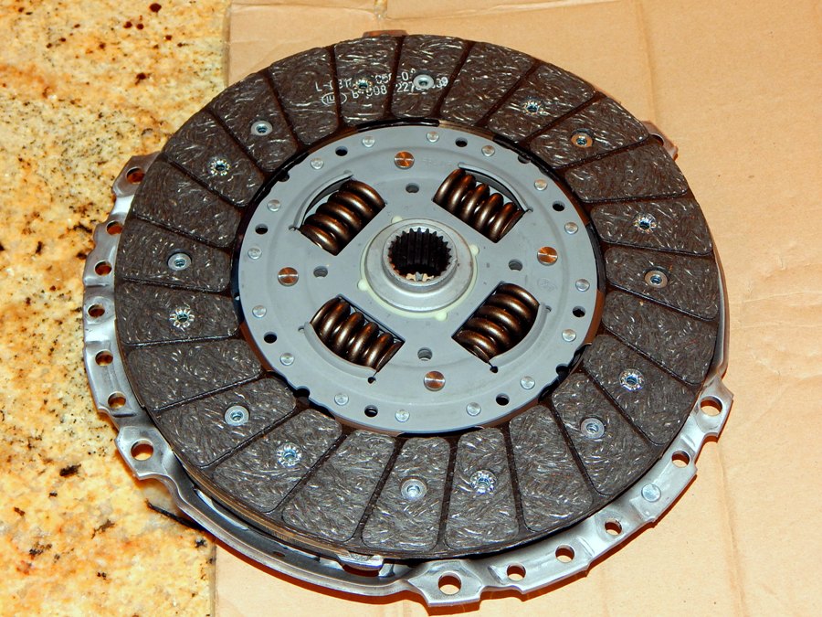

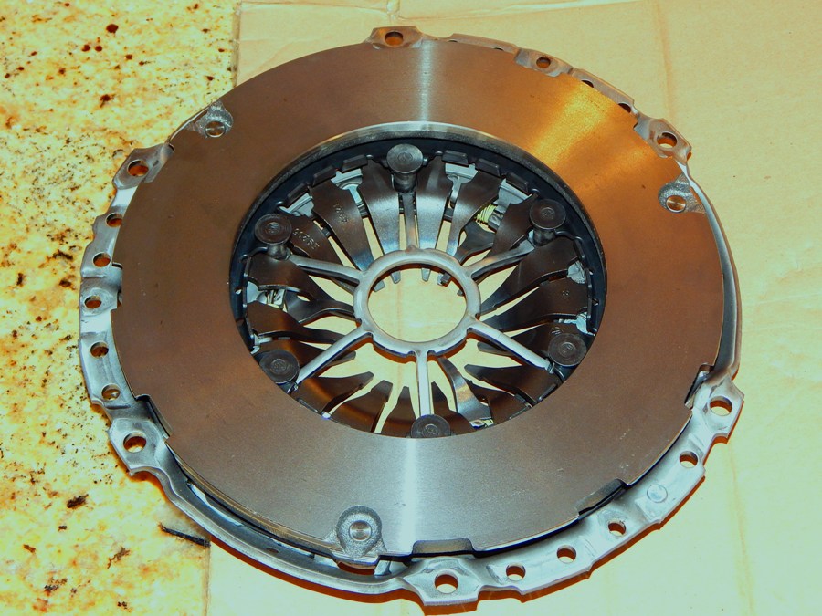

Little early motor porn... Stopping by shop tomorrow to snap a few more shots including virgin mzr.
Fidanza FW
Only big surprise with FW was this right here; not very common anymore.
LUK CLUTCH
And CP-E safe seals. Damnit if I didn't put about 1-2k miles on my car since I installed a set of these on the last motor...
Injectors are going out for cleaning and then it should start coming together pretty quick. Maybe by Friday.
MINI H1 6.0 - CAR LED TAILS
Cevaes_64 (08-27-2014), CosmicArkie (08-27-2014), ItsNox (08-27-2014), rymanmazda (08-27-2014), sidekick (08-27-2014)

Is that a LUK stock replacement?

Yes

That's the one I'm getting when is time too, 299 on eBay for the kit =)

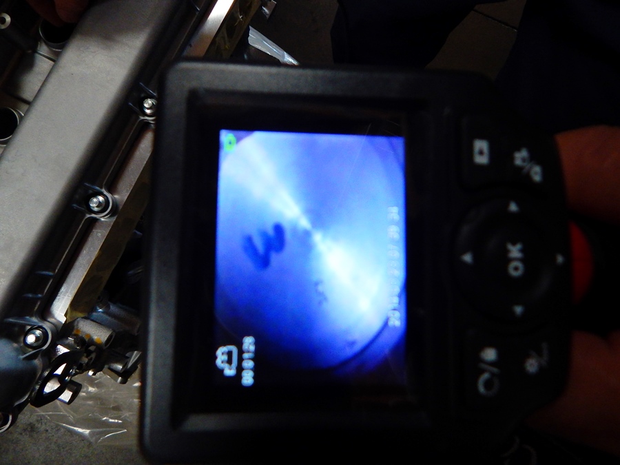

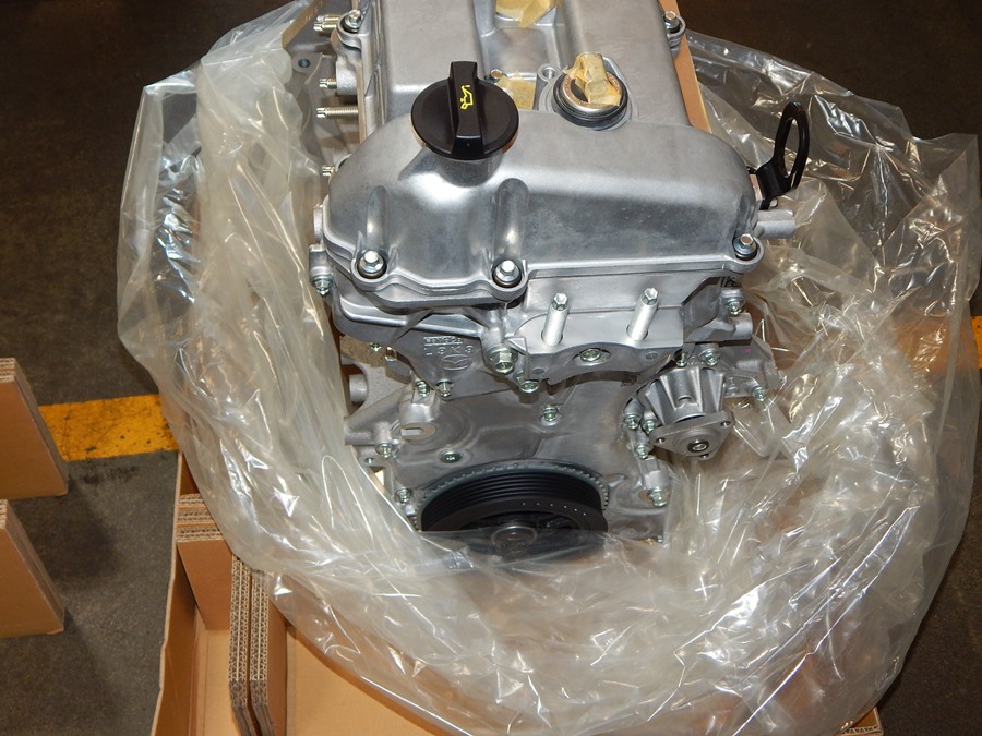

Here's some motor porn. Gen 1 pistons of course, no surprise there. We inspected the cylinders, there were a couple TINY bits of what appeared to be shavings and/or debris in the cylinders on the pistons/walls. Definitely worth it to clean them out before install.
Pistons were numbered with handwritten numbers up top; I assume that's part of the balancing process.

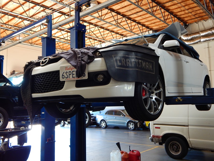

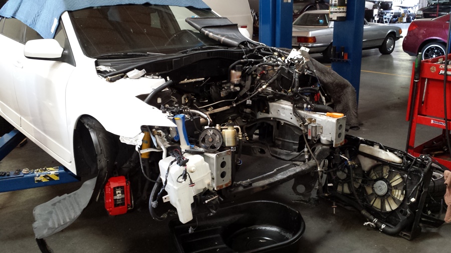

MS6 still looks good in the air in pieces.

Why is the hood off?

Hmm. .. dunno.

Totally forgot this was going on. Congrats on the new long block. Looks like you're making some great decisions. I always planned if I ever rebuild to stick with a smaller quick spooling turbo tuned in the range of 350-400 whp. I really like that you're sticking with the Beaner, I think that will make for an excellently balanced speed. Good luck!

I stopped by shop today, it looks like motor should be swapped over today and tomorrow delivery is still a reality. I would have taken pictures but it wasn't very exciting. Just a ripped apart car. They did decide to pull the motor out of the front of the car.

That's crazy they pulled the motor out of the front.
I drop them bitches fromunda.
 Old 08-28-2014, 07:53 PM   #111
That would be lifting them in. Dropping implies you are using gravity to help.
ALPINEST4RS (08-28-2014)
 Old 08-28-2014, 09:23 PM   #112
ALPINEST4RS's Avatar
Location: Pinckney, Michigan
Posts: 905   (View Stats)
Thanks: 794
Groaned at 8 Times in 3 Posts
It's the redneck big 3 slang I recon.
I gracefully and gently set the engine on a roller. Then, I hoist the vehicle back in the air. Like so.
