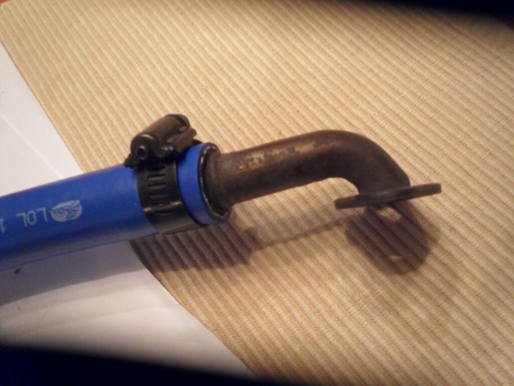

This is what caught my attention:
The seller e-mailed me another picture:
and I had this thought that maybe, maybe we could use it on the block side for the oil return line.

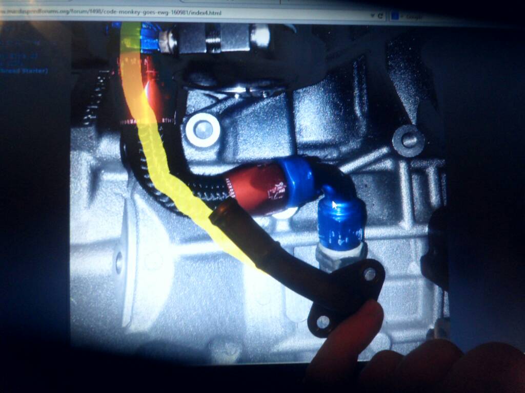

The part arrived Saturday and here is what the flange looks like superimposed on my earlier sketch:
Now, onto some measurements and comparisons.
The stock oil return line's orifice is 0.5856", the Miata's one is 0.5120", the third flange, same as Treadstone here sans the integrated o-ring, is 0.505". I am not concerned about the smaller than stock diameter as virtually all aftermarket flanges are 1/2" ID.
The bolt holes on the Miata flange are a bit too close and will have to be elongated, should be easily doable. The flange is super thin compared to the stock line, I have no idea if this is a problem, most likely shorter bolts will have to be used. The line should clear the TC easily, but it is still possible that it would run too close to the block. A -10an line with a clamp fits very snugly and there should be no leaks.
I do have a spare block and a spare stock EM, maybe one of these days I will grab another turbo and test my theory. Or perhaps someone who is in the middle of a build will jump on it.
The Miata part # is 32-5M0 and goes for $21.95. As you can see in the diagram, there is an o-ring if needed -- it is an extra $17.70 as part of a seal kit -- but I am sure we can source just an o-ring at a cheaper price. Another possibility is to shave the flange so it is perfectly flat but I am not sure if there is enough material.

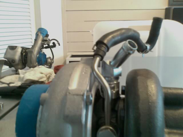

Lol you used all of my pictures!
I don't think this is a great solution. Prone to leakage. You could weld a AN fitting onto the end of that and call it a day.
I never had an issue with this set up.
That's a picture my uncle took a long time ago. That's a gt28 IWG. The problem on the speed 6 becomes even more of a pain with an ewg housing on the turbo itself. Like in my picture above.
