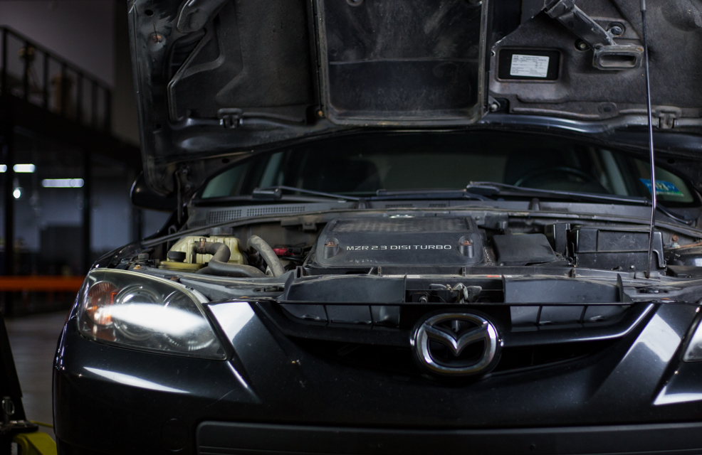

Nick here from Mishimoto, I just wanted to let you guys know that we have a direct fit catch can in the works for the Speed 3, and if you happen to have a Speed 6 in the Delaware/Philly/Maryland area, we'd love to have you in for a test fit. Anyways, on to the project.
I don't have to tell you guys that the 2.3L MZR Turbo laid the groundwork for what we now know as Ford's EcoBoost series engines. From what we've seen between the several different EB engines we've had in, not to mention our experience with early direct injected turbo engines, we already knew that the MS3 was highly susceptible to large amounts of engine blowby and intake valve carbon buildup.

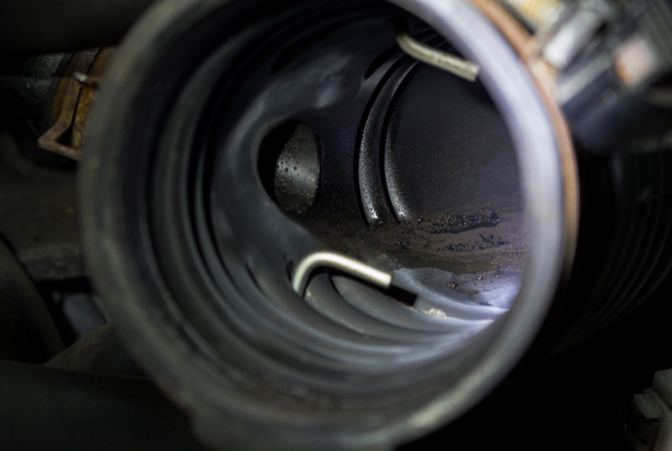

We we're wrong, either especially after our engineer started digging into our loaner MS3. The intake boot was coated in the murky stuff, meaning that the rest of the top end internals could be in worse shape. The Speed3 runs into a unique problem, in that the top mounted intercooler is prone to heat-soaking, and can bake those oil deposits into the heat exchanger's passageways, effectively quashing the cooling properties.

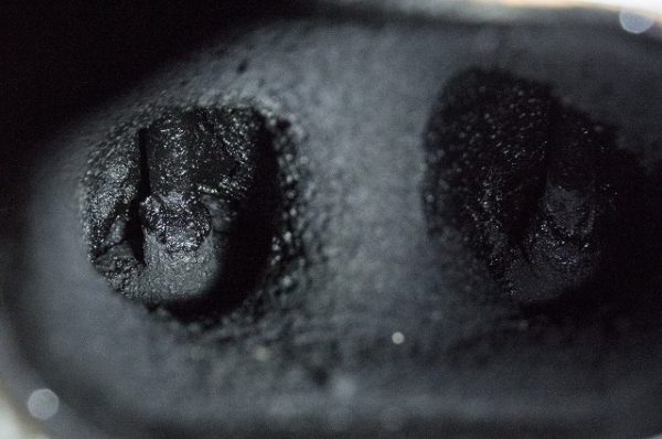

While the Mazdaspeed department might not be around anymore, the Speed 3 is still out there on the road racking up the miles. After a decade of being on the road, the MZR propelling these hot-hatches along might have seen plenty of replacement parts along the road, but there's system that you never want to have to replace, and that's the valve-train. In our last installment we went over the causes of blow-by, and as many of you know, these engines are highly susceptible to copious amounts of carbon buildup.

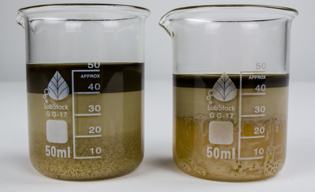

While this photo might have been from one of the Speed 3's direct competitors, the MKV GTI, the story is still the same, if not worse. Over our development period for this catch can system, we ran two separate 1000 mile tests, leading to two different results. The first was in warmer weather, yielding what we might call a standard collection of about 18 ml. However during the colder months the story was much different, and our short test produced approximately 100 ml in the same time span.

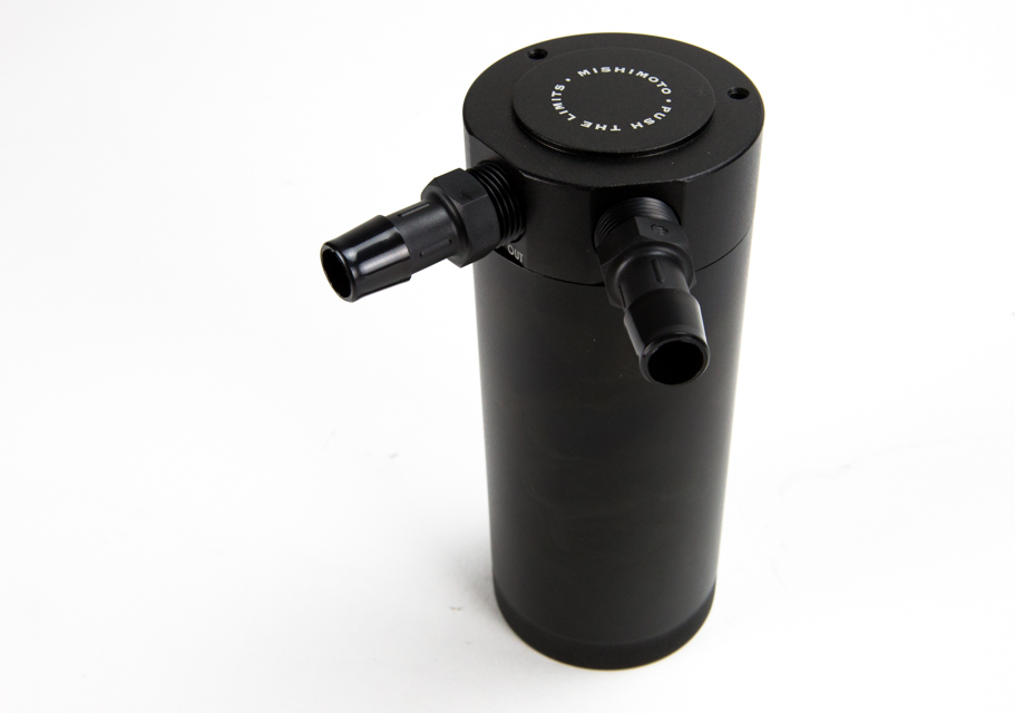

With such a large amount of blow-by collected, it was a no-brainer to utilize our larger, 7.5 oz. catch can over our standard 2 oz. compact can.

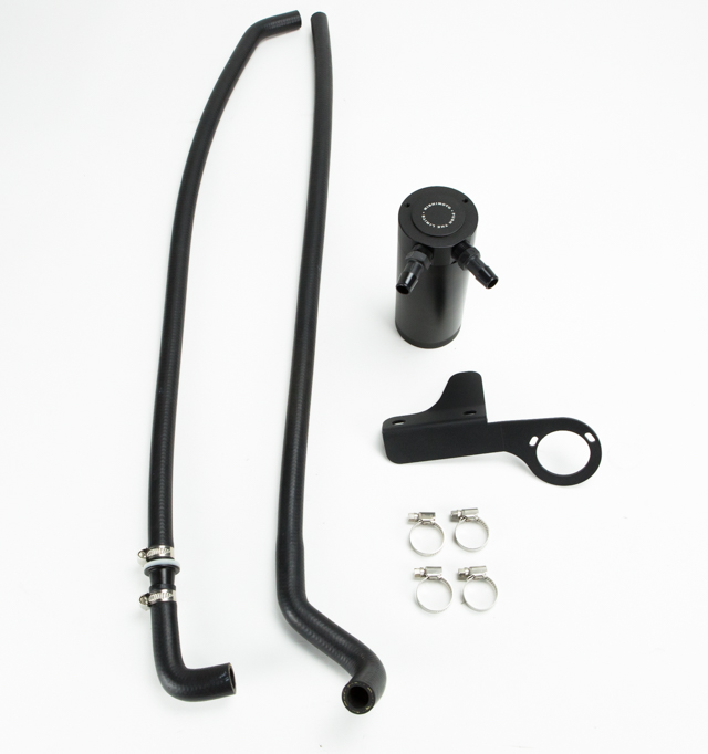

For the full write up, including our mounting and our prototype kit, check out our latest post on the Engineering Blog.
Those of you with a Gen1 Speed 3, the presale for our kit is now available! Check out the link below to be one of the first to get you catch can!
Mazdaspeed 3 Direct Fit Baffled Oil Catch Can Kit
Special PreSale Price - $165.95
