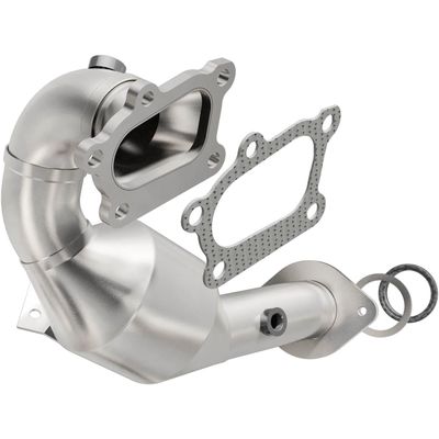

Magnaflow Catted DP
MS3 DP
Two-year warranty
Available from: Magnaflow Catted DP
MS6 (No), MS3 Gen1 (Yes) $490, MS3 Gen2 (Yes) $490

 Old 07-02-2015, 10:36 AM   #40
GregScuba's Avatar
Location: FL
Posts: 96   (View Stats)
GregScuba is the leader of the worldGregScuba is the leader of the worldGregScuba is the leader of the worldGregScuba is the leader of the worldGregScuba is the leader of the worldGregScuba is the leader of the worldGregScuba is the leader of the worldGregScuba is the leader of the worldGregScuba is the leader of the worldGregScuba is the leader of the worldGregScuba is the leader of the world
Thanks: 324
Thanked 265 Times in 47 Posts
Not sure if this has already been mentioned, but I just stumbled upon this, and thought I'd throw it in the mix. Apparently Magnaflow makes a DP. No idea how it performs though.
Magnaflow/Catalytic Converter 51545 at AutoZone.com
nomorecivic! likes this.
2010 Liquid Silver Mazdaspeed 3
Cobb AP v3, tuning by Stratified Automotive Controls, Autotech HPFP internals, one step colder NGK Iridium plugs, Cobb DP, Magnaflow 3" CBE, Corksport SRI/TIP, Corksport Race RMM 80A, Synapse Synchronic DV in push mode A+B, Treadstone TR6 FMIC, JBR FMIC piping kit, JBR Silicone recirc hose, JBR rear sway bar, Bilstein B14 coilovers, SPC adjustable rear camber arms, Stoptech SS brake lines and brake pads, 17x9" et+45mm Enkei Racing RPF1's, 245/40/17 Hankook RS3's, JBR 5mm hub/wheel spacers in front.
GregScuba is offline   Reply With Quote
