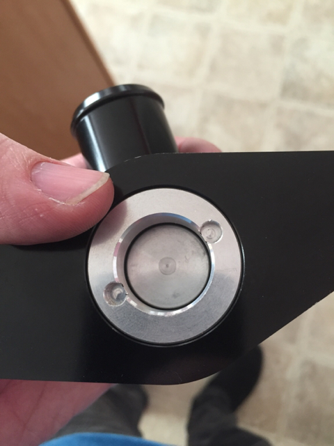

The softer spring is leaking on me around 20 psi. Piece of shit. The hard spring is too hard and I get some compressor surge and the soft spring is too soft now.
MINI H1 6.0 - CAR LED TAILS

I used the soft spring with a 24PSI tune and it was fine. I think the ability of the BPV to hold boost is not necessarily dependent on the opening pressure. When into boost you have the same boost pushing the piston into the closed position both in the cold pipe and the other hose connecting to the IM. So as long as the pressure difference does not exceed a certain value that would make the spring compress (14PSI for the softer spring and 20 psi for the stiffer one) the piston should stay closed.
If you guys have problems with the Turbosmart BPV holding boost check that rubber o-ring/gasket at the top of the valve. Over time mine got longer for some reason (probably because of the Turbosmart Oil I was using, or heat stress?) and I had a very hard time threading that cap back after I was lubing the piston. Last time I lubed the piston it took me 20 full minutes to put it back in place, and this used to take less than a minute. When I got back in the house I ordered a Cobb XLE which requires less maintenance thanks to the low friction material used for the piston coating.

I have had the Turbosmart BPV with the soft spring for a while. Every oil change, I pulled it apart and oiled it. I just recently inspected it and it was fine. It seemed to do fine, but lately, I started hearing (and seeing in logs) the BPV dumping some boost over 20psi at peak boost. I am not sure what changed since I first installed it. I don't think this is a leak at the o-ring; I think the spring is starting to compress and leak under 20+ psi boost pressure. Maybe the spring is getting a little tired? I don't know.
Anyways, I put the higher rate spring on and we'll see how it does. It isn't fluttering at partial boost and is holding boost fine.

The spring gets indeed a bit softer over time but not too much and I still don't think it's a real issue.
I lubed mine every ait filter change which in my area has to occur at 3-5k km (2-3k miles), so a lot more often, and still the piston had some obvious wear marks on it.

Is it this, I need to unscrew?

No, the top unscrews to change the spring. That's one of the things I didn't like about those. The best you can do is hold the BPV body and try and grip the top by hand and turn it counter clockwise. If you can't get it loose, get a vice grips, wrap it in a towel and lock it onto the top and then unscrew it.
Both springs will feel softer than stock. The OEM is stiff as shit, but it's a different design meant to blow off very fast.
If your AFRs are shifting from going back and forth you have a leak somewhere. Are you using the paper gasket and is your bypass hose snug at the BPV and turbo inlet hose?
