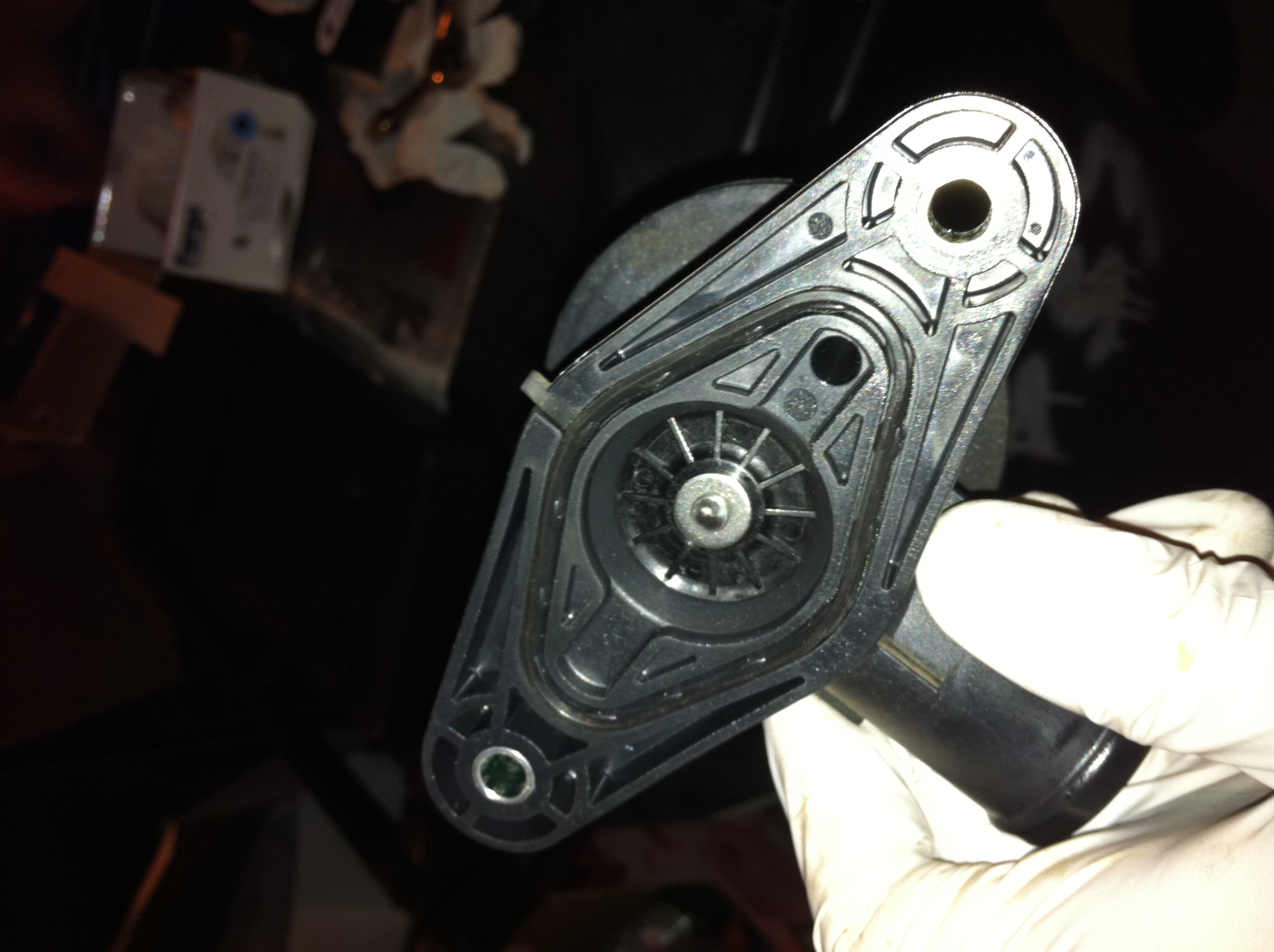

So Am pretty sure I have a boost leak somewhere, as i am only hitting about 12psi on the gauge. The car is bone stock besides a JBR SRI with Turbo inlet pipe. I will attach a log for reference. So I looked at some of the DIY and made a boost leak tester, i connected it to the Turbo inlet, and when i try to pressurize the system all the air immideatly leaks out of the small notch on the bpv. I am prety damned confused right now and any help would be nice.

What notch on the bov is leaking? That is probably the leak that you felt you have.

Thanks Ill try that and see if the code goes away, as for the notch i am talking about you can see it in the picture below.

Lol, that's the notch that is SUPPOSED to hold the BPV o-ring in place, if your car had one. It looks like your BPV o-ring gasket is gone (or torn or something).
I am 99% sure that's where you are leaking boost.
See what I am talking about? Replace the gasket, get the boost back. Oh, and donate.

Yeah it's the gasket. I had the same thing, shop that replaced the timing chain & VVT must have forgotten to put it back.
