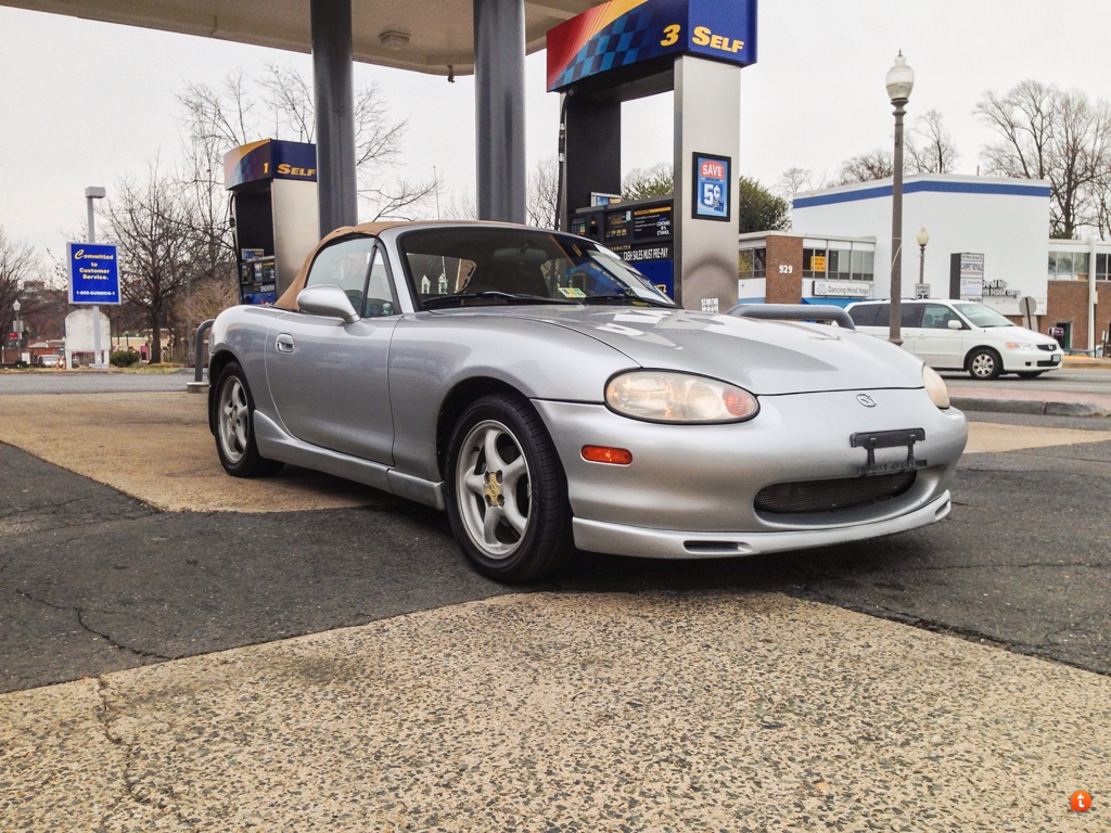

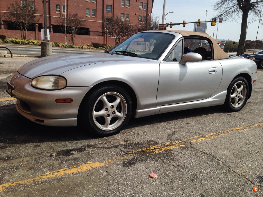

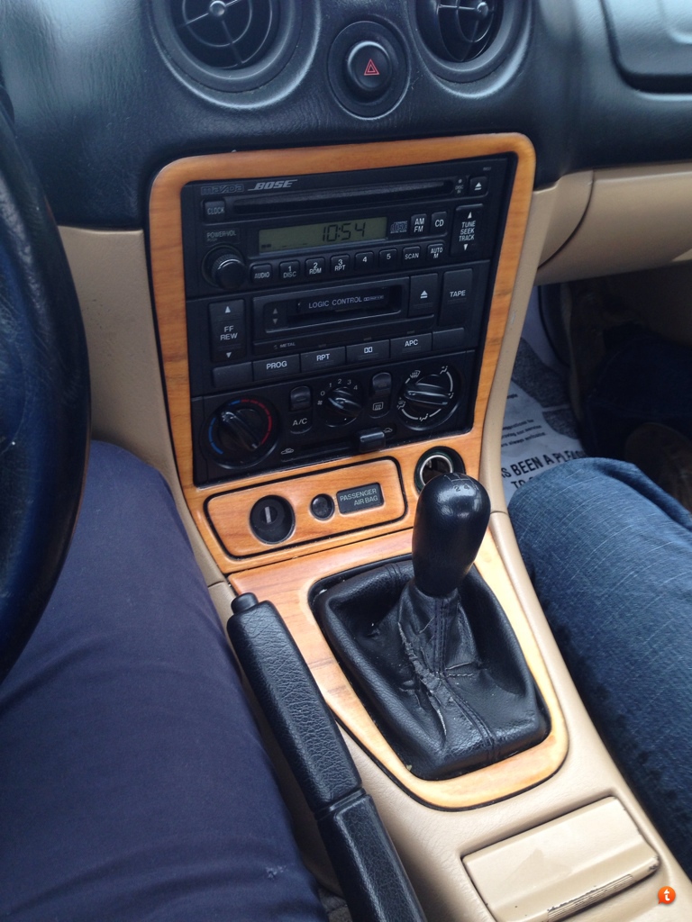

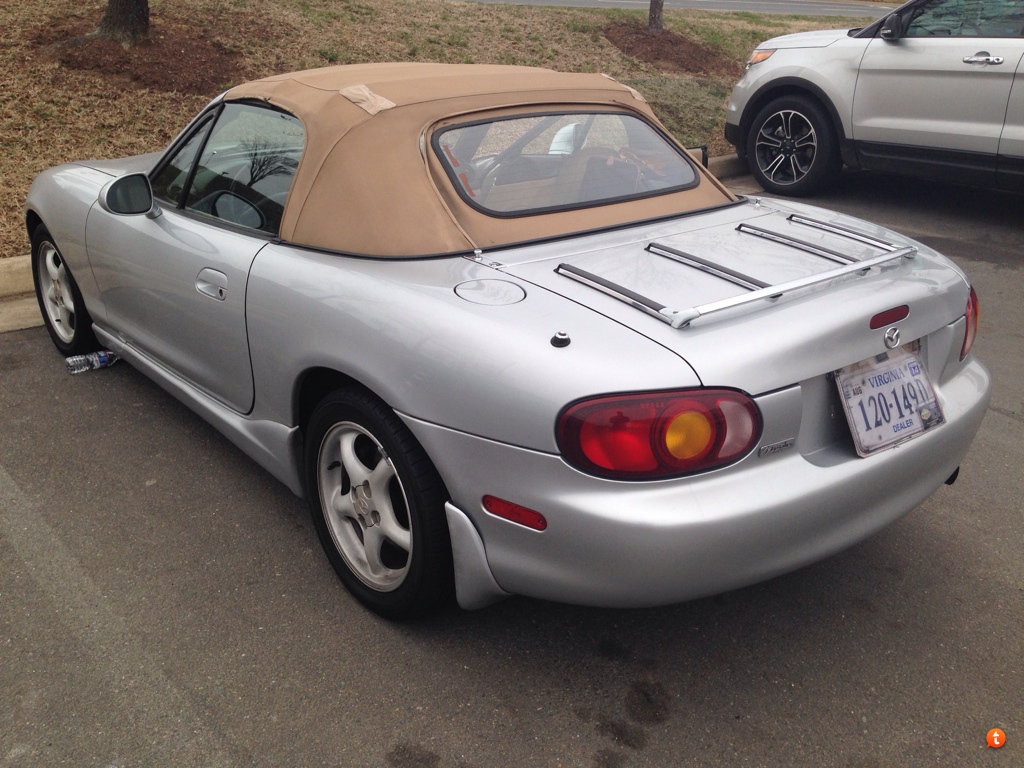

Just brought this baby home. She's a 99 with leather, Bose and wood grain, I feel like Rick Ross. Oh and its got a luggage rack, talk about classy as fuck. I need to give it a good wash and an oil change and wipe down the interior with antiseptic wipes to get rid of residual semen stains. Got a black top on the way to replace the tan one that is torn, worn and stained, probably from all the ejaculations over the years. Don't mind the water bottle, ebrake is in mint condition and a water bottle isn't required to keep it stationary. When are we cruisin @Rokusek; @AtTheDriveIn; @Skatethesea;

Polish those headlights bruh.

Nice find.

Been looking for one just like this!! Sweet find. Just curious about how much she ran ya? Trying to get an idea of what others are paying..
Plans?

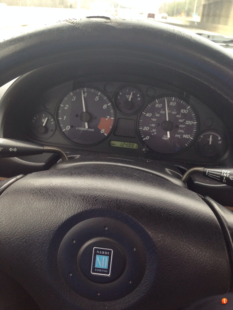

my immediate plans are to post up a 40-120 speedo vid

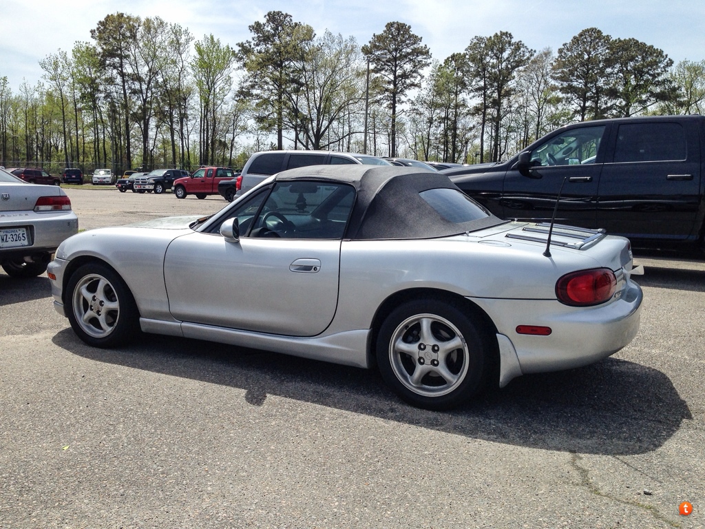

but first i replaced the torn tan top with a black one and got some tint

I need a new soft top
And glass rear window so I can tint mine.
Looking good @Manny;

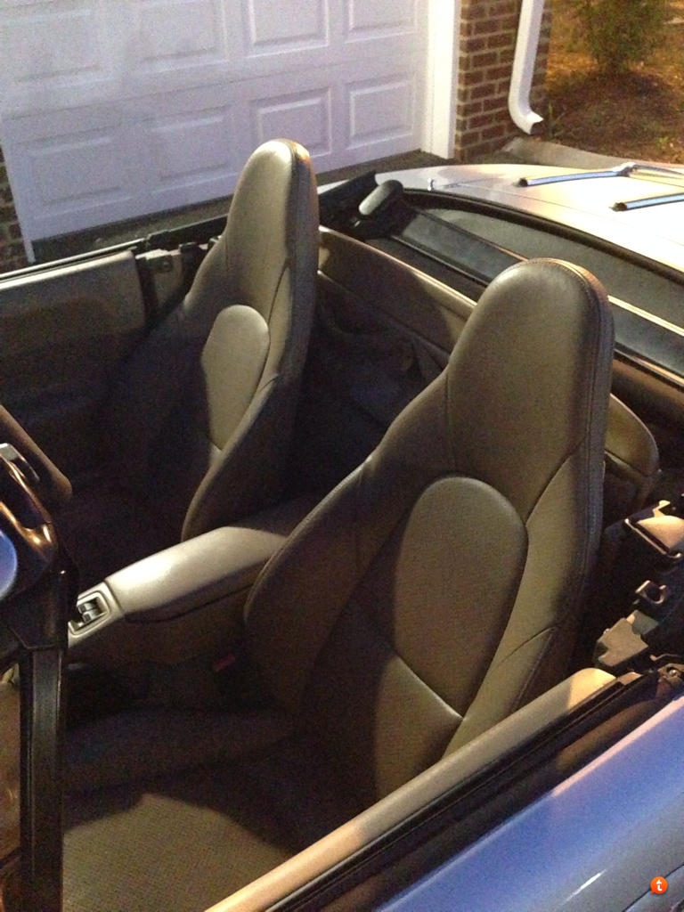

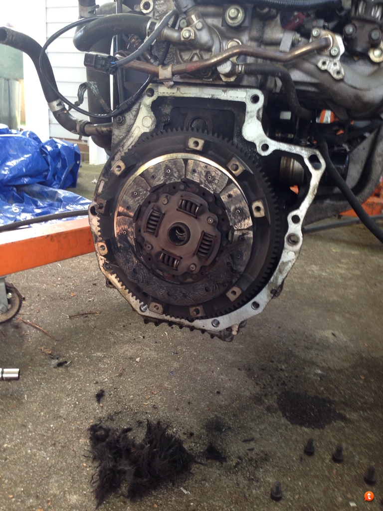

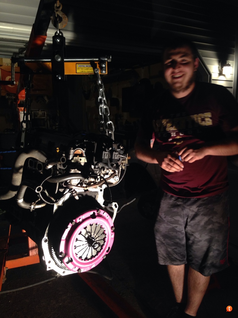

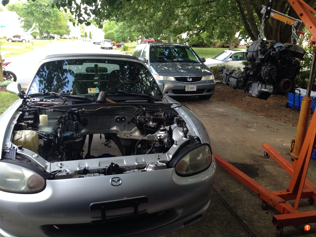

So I've replaced the clutch with a flyin miata happy meal level 1 clutch kit, replaced the rear main seal and put in some mazdaspeed competition mounts in along with a k&n cold air intake. Also got an oppurtunity to snag up some NB2 seats which are much more comfortable and have much better back support compared to NB1 seats. I just attended my first autox with the car this past Sunday and I have a lot to learn and need more seat time to play around with stuff like tire pressures to dial it in. I've been working with Cobb Tuning and I'm proud to say that I'm the worlds first Cobb tuned miata

I just picked up a NB1 myself and have been looking for nb2 seats too!!
How hard was the clutch swap, because ill need to do the same here soon?

Clutch wasn't hard at all I figured pulling the motor would've made it easier but that just created more work. At the very least I know how to take the car apart now. Figured the oil pan may need to be dropped to do the rear main seal but apparently that isn't the case. Everything went pretty smooth though. Just make sure you read up on how to align the PPF because it has to be aligned with a straight edge and has to be within a certain range otherwise your car will sound like a blender. In regards to the clutch install there are plenty of detailed how-to's out there that make it a relatively easy job.

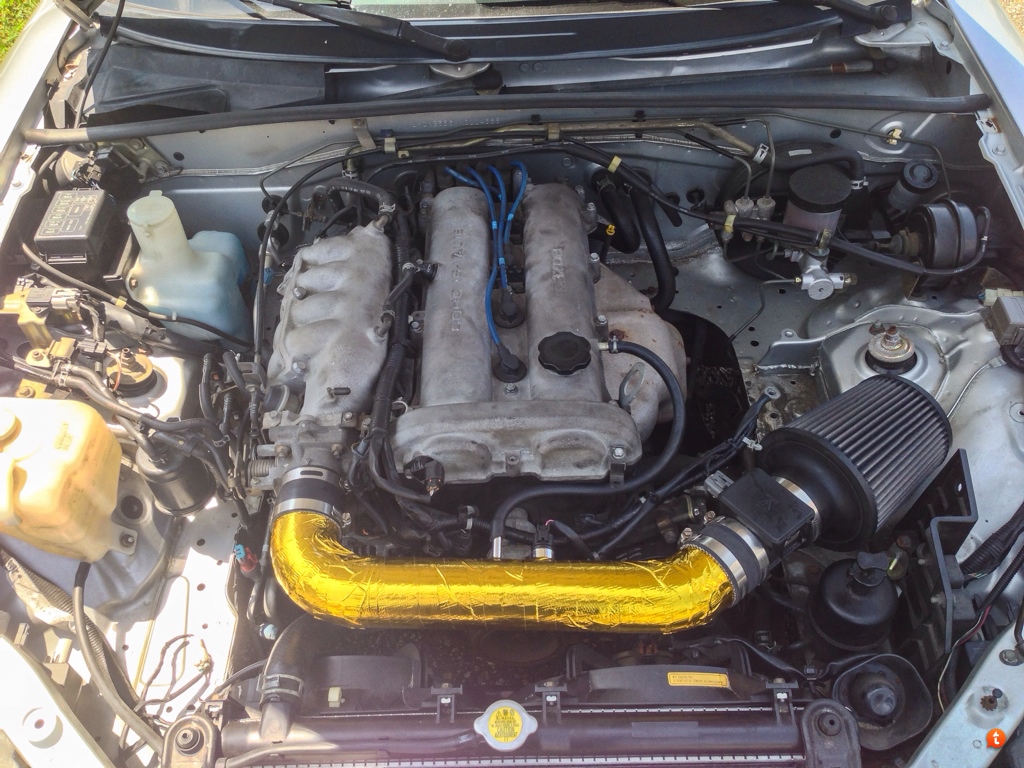

Pulled the intake off and wrapped it in DEI heat reflective tape. Shoutout to my boy @papaspeed3; for the moral support. I'm gonna build an air box for it eventually

Nice job on the clutch, seemed a bit much to pull the motor since it's pretty simple on it's own, but whatever. No harm no foul eh?

so I pulled a @Neverlift; and drove my car off a cliff on a togue run. Replaced it with a 2001 LS. Previous owner put a brand new oem top on it last year. This ditzy blonde slut was given this car as a hand me down from her father and developed a knee problem because she spent too much time on her knees sucking dick. Car sat around for a year in the middle of bum fuck nowhere hickville so I got this one for less than I paid for the 99. Rear rotors are scored and there are some minor blemishes here and there and some rocker panel rust that needs to be fixed other than that this one is ready to go. I'm going to swap the trans and clutch from my old miata into this one eventually because getting into second is a little notchy and with 140k the stock clutch is probably on its last legs.
ImageUploadedByTapatalk1410067563.571403.jpgImageUploadedByTapatalk1410067585.338665.jpgImageUploadedByTapatalk1410067600.421677.jpgImageUploadedByTapatalk1410067612.821519.jpgImageUploadedByTapatalk1410067670.371784.jpgImageUploadedByTapatalk1410067688.354964.jpgImageUploadedByTapatalk1410067702.188200.jpgImageUploadedByTapatalk1410067733.488557.jpg

Can i get your seats from the other one? Or from one of them? Il be out there this weekend and wouldnt mind if you were able to let me get them. The seats in my NA are garbage lol

HOLY SHIT MANNY!
When did this happen? Are you ok?

Yikes man. Looks like the miata didn't do to bad for going off a cliff, the new ones looks good though.
