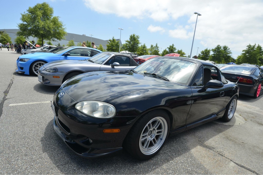

aligned, got a touge run lip, Lamborghini Newport Beach license plate frame, washed, clayed, waxed and got a nardi woodgrain steering wheel in that order, I have nothing else to add besides the fact that the gay Virginia is for lovers plate will be gone soon.

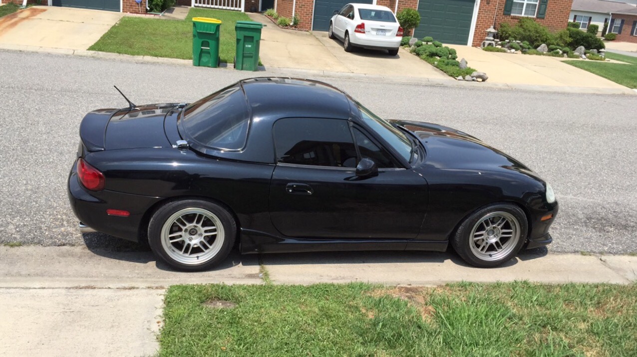

wheels are on, need to clean the car up. I might spin the rear coils down a couple turns and she will be sitting good.

You need about .5" of rake rear to front, fyi.

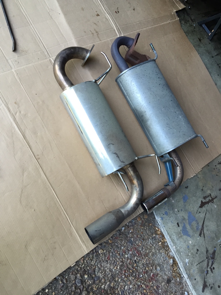

picking up a racing beat resonated race pipe today along with an MSM axle back from a local later today. Maybe I will post up some vids tonight.
Miata Race Connecting Pipe for 99-05 Miata - Racing Beat

A+ to rice pipe update. lol
You know you want a Roadstersport or Enthuza muffler.

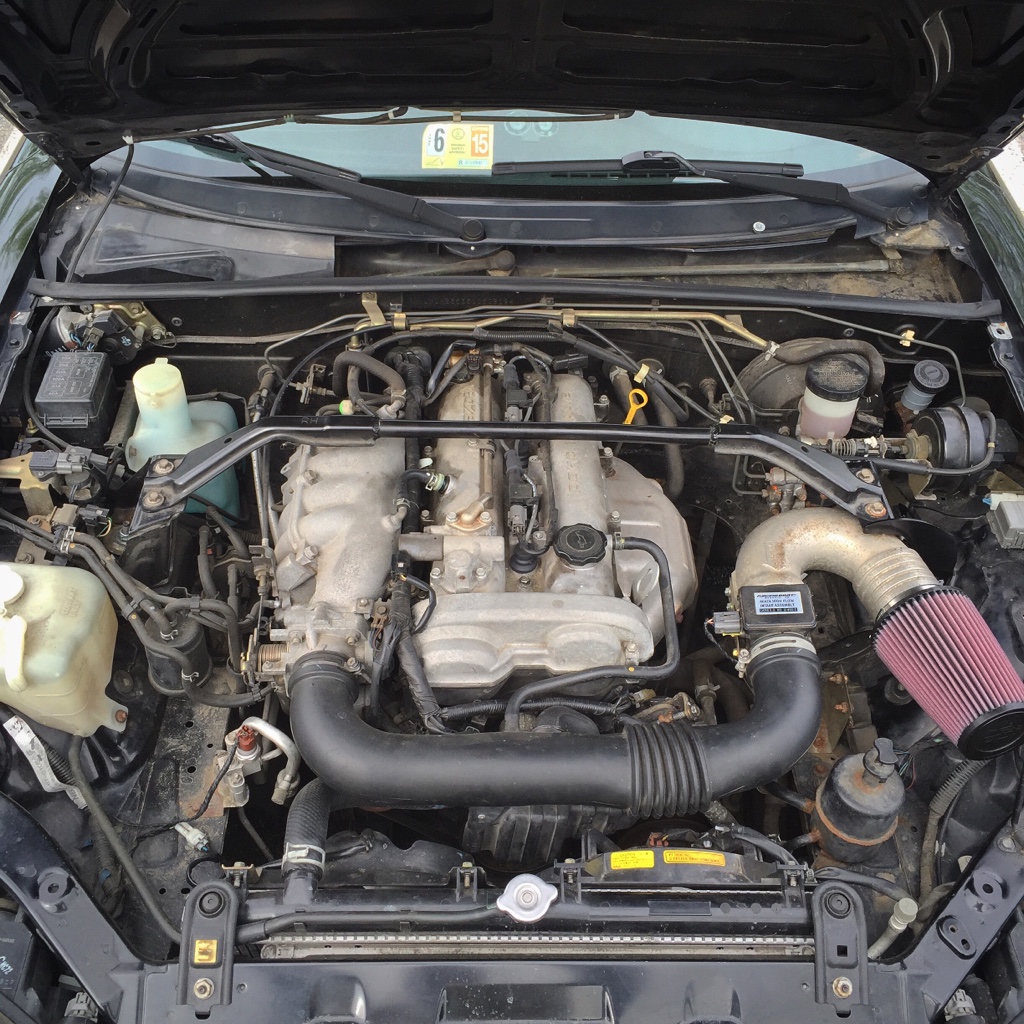

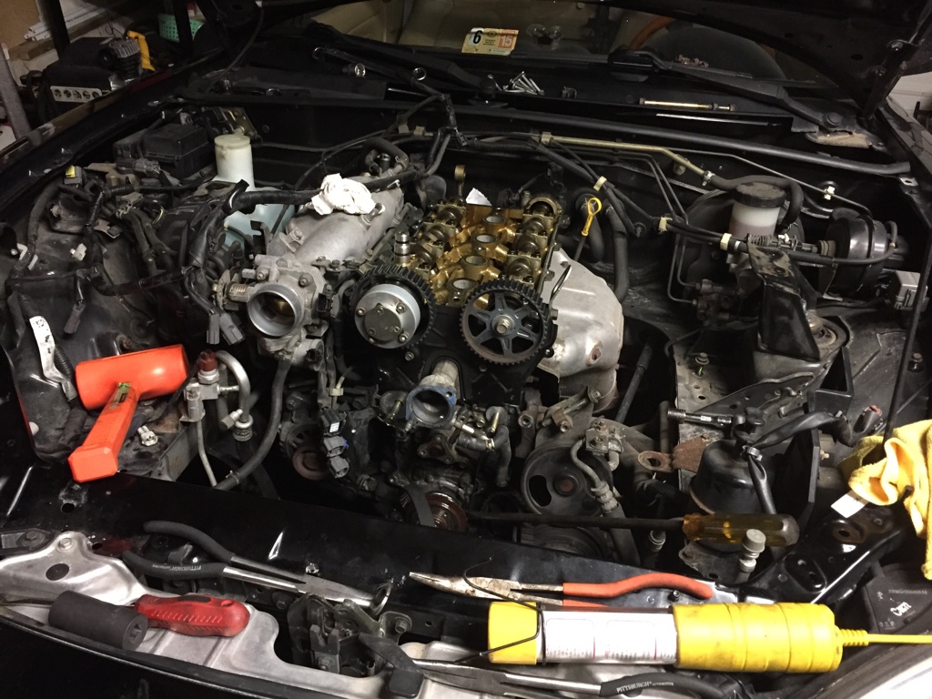

I didn't really pick the best day to do this because it was snowing and I had snow and ice packed into every crevice underneath the car, which caused a constant puddle under the car all day long which was annoying. I was getting a little bit of a misfire when applying high throttle in 2nd gear down low. I had a bunch of parts sitting around so I went ahead and decided to knock it out. Replaced my valve cover gasket, cam position sensor, spark plugs, coils packs, plug wires, timing belt, water pump, thermostat, pcv valve, cam and crank seals. The plugs that came out from the previous owner were gapped to .080 when factory range is .040-.045 which is probably why it was missing. I'm getting a much better burn now. Doing a timing belt job definitely wasn't as bad as people made it out to be. Got caught up with trying to break the crank bolt loose and an impact gun didn't work, but bumping the starter did the trick. Other than a hold up with the crank bolt, everything else went smooth and the car runs better now. Afterwords I hooked up some sleds to the rear tow hooks for some sledding action.
Next up is overhauling the brake system and maybe new hubs and rebuilding the calipers because my brakes are starting to drag a little bit. I've heard the brackets that have the slider pins on em are the culprit but I will have to inspect the calipers the next time I have the car up on stands to do the diff fluid. I'm still deciding on what I want to do with pads. I'm thinking Carbotech AX6 up front and XP8 in the rear. Aggressive pads may cause the front to lock up too easily so i'm thinking going with a higher torque pad in the rear may change up the bias a little bit. I may consider HPS and HP+ but i've never been a fan of HPS or EBC for that matter. I don't know about pads too much outside of those brands.

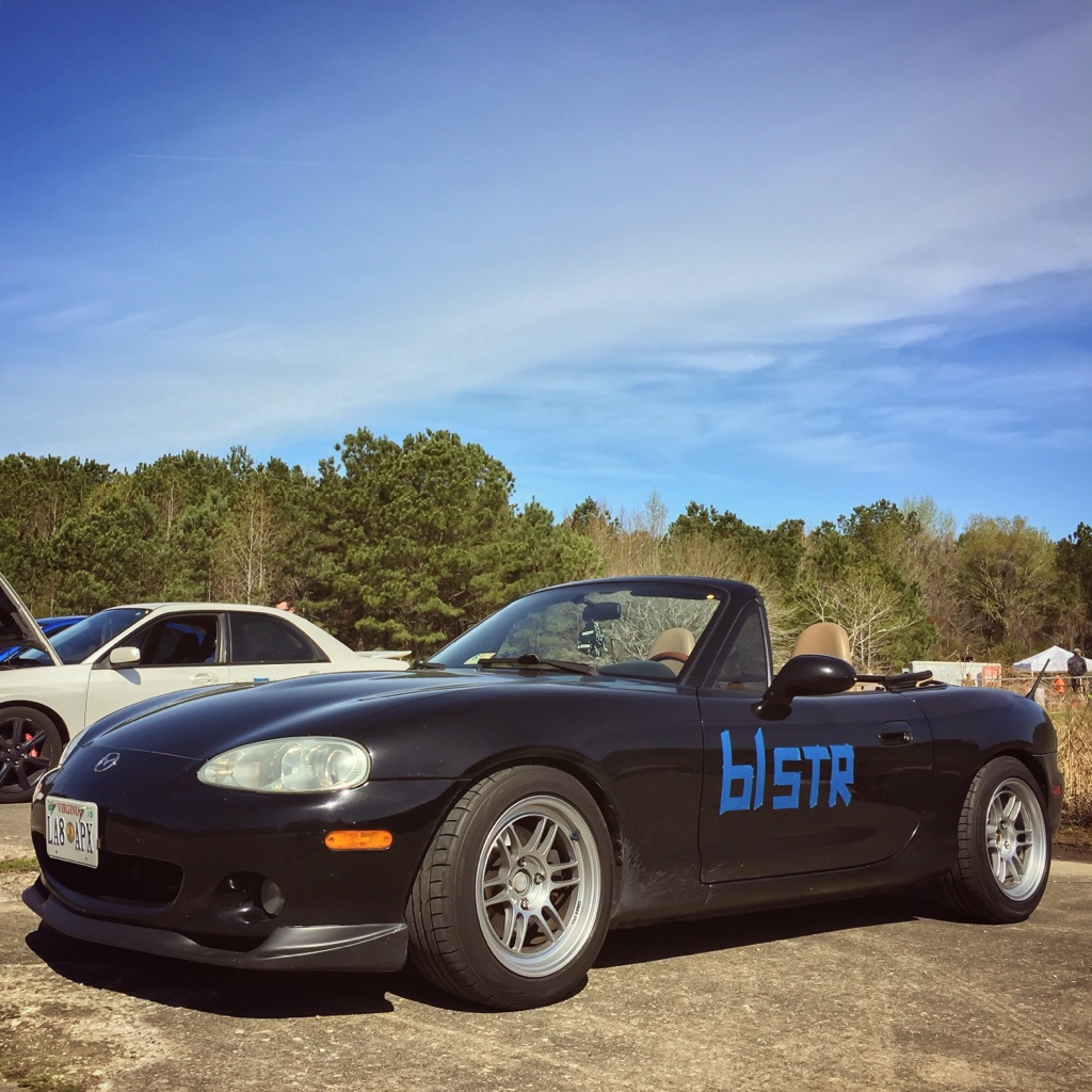

Below is a vid from my first event in the nb2. I was pretty happy with the car could be a little bit more aggressive on the brakes, but I rubbed down to steel braids on one of my front brake lines, zip tied it away a few weeks ago doesn't seem to leak. Feels like I have some air in the system which makes the brakes feel sketchy. Found out my master cylinder was leaking, topped it off and kept trucking. Got a new master and slave sitting at home, waiting to get a clutch to replace those along with an SS clutch line. Got some centric standard rotors and stoptech pads from rock auto on the low along with a 949 SS brake line kit waiting to be installed since one of my front calipers are sticking after intense togue runs. Picked up an RB intake on craiglist for 50 bucks figured why not. Got an RB 1.125" FSB coming soon with the mounting blocks and 949 end links. Might try out no rear bar with the RB front bar for next months event.

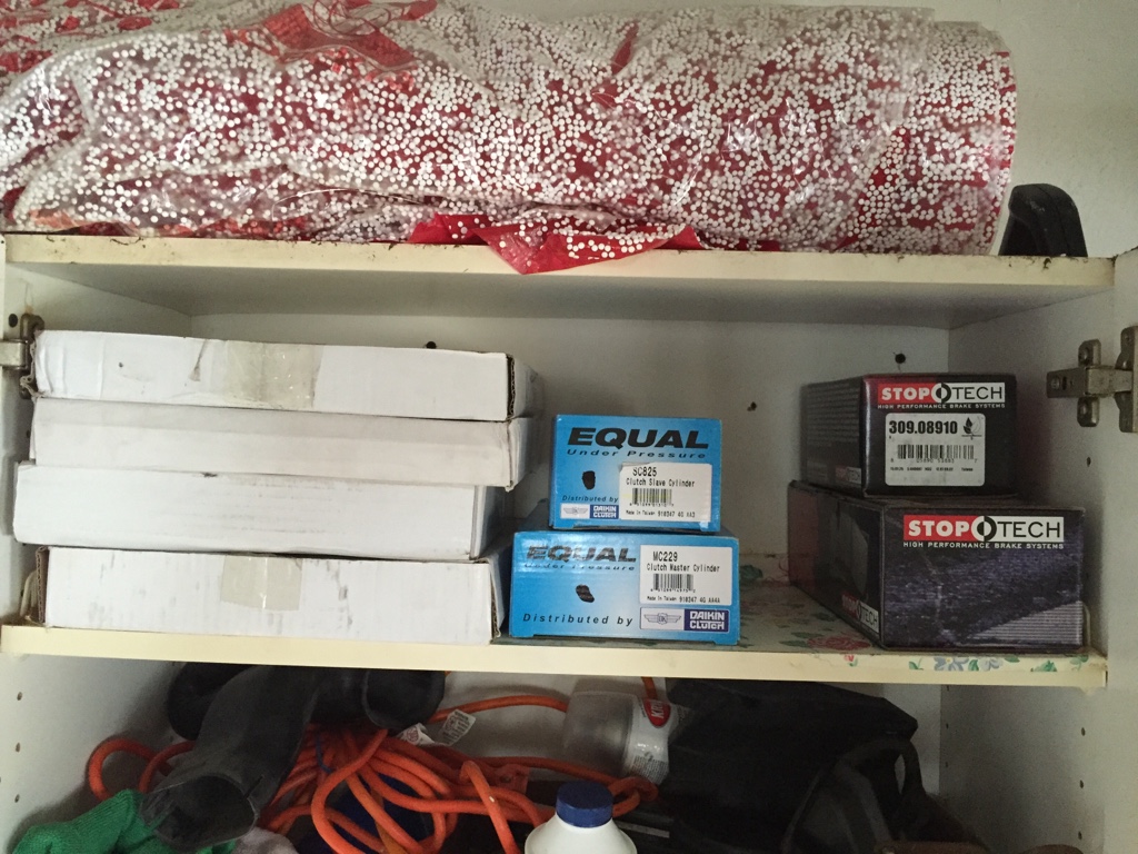

On my way home from the first autox event this month, my clutch pedal went soft like a limp dick. Luckily I had a new slave and master to throw on the car along with an SS clutch line, nice to have fresh clutch hydraulics in the car now. Old pieces were rusted to shit with dry rotted boots. Installed the RB 1.125" FSB with the block kit and 949 endlinks. I need to tighten up the endlinks with the suspension loaded up because I'm getting clunks when going over cracks in the pavement. Gonna try to knock out this brake job now that I have the SS brake lines. I picked up a nail in one of my tires the day before the second event of the month and couldn't get it patched. Luckily I have tirerack roadside assistance so I can get it replaced free of charge but the tire wasn't going to be here in time for yesterday's event. I had to throw the stock wheels with shitty all seasons on the car. Lots of understeer and very little grip.
I'm dropping the car off at the body shop today to get the rocker panel rust fixed. I bought a patch panel for the shop to use since the rust was spreading into the door jamb. While I have it in the shop i'm going to have my small tupperware side skirts from my old miata painted and installed along with my front lip which is currently plastidipped.
