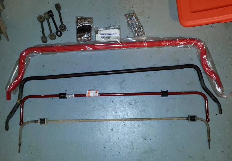

Zerked the Rear Upper Control Arms, bringing the total number of zerks installed to 12, with 10 remaining to do.
New swaybars came in last week, so out with the old and in with the new....

Long time no update. Spent quite a bit of time on the car this weekend, which is good since I have not touched it since mid December. Still no xidas, but people that ordered around the same time as I did have started received their kits so hopefully I will see mine soon as well.
With help from @kevdog; I completed the steering rack conversion, new boots and all the lines looped. For future reference, I used 1/4" fuel line for the smaller two loops and 3/8" fuel line for the larger one. Rack is now ready to go back in.
Removed the differential which was an adventure with help from @kevdog; and @Cheapspeed; I really should have read a how to first. The key is to remove the bushing from the bottom of the structural arm that holds the differential. Then things got really interesting taking the bushings out. We all took turns with a 4lb deadblow with @El Beaner; pitching in as well and basically pounded it out of there by bending one piece enough so that you can get it out. Also used a heat gun to help make things more bendy.
With the diff out I spun the stub axles about and thought it felt like a Viscous LSD, which I confirmed after browsing this website by the shape of the stub axle flanges: Differential Spotters Guide If I was serious about doing anything powerwise with the 1.6 I might care, but as is, meh. Better than open diff I suppose.
Also did final bushing/zerk assembly on all of the upper arms and one of the lower. took entirely too long to do it, but in addition to the yunegling I brought back from WV, I also brought back some caramel moonshine which I broke open today.
Lastly, found an Amazon warehouse deal on a Momo Drift 330mm Steering wheel. It has a 3.5" deep dish on it, so hopefully it will bring the wheel out enough for me. I dont want to have to run a spacer. Wheel should be here tuesday.
