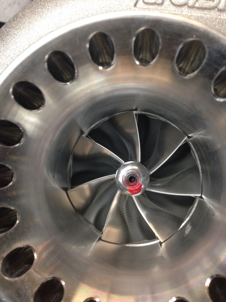

 Old 03-13-2014, 03:40 PM   #88
Misfit_S3's Avatar
Location: El Paso, TX
Posts: 168   (View Stats)
Misfit_S3 is the leader of the worldMisfit_S3 is the leader of the worldMisfit_S3 is the leader of the worldMisfit_S3 is the leader of the worldMisfit_S3 is the leader of the worldMisfit_S3 is the leader of the worldMisfit_S3 is the leader of the worldMisfit_S3 is the leader of the worldMisfit_S3 is the leader of the worldMisfit_S3 is the leader of the worldMisfit_S3 is the leader of the world
Thanks: 60
Thanked 136 Times in 68 Posts
Let the teardown BEGIN!!!!
Precision 5858 Kit / CP-e FMIC / HKS SSQV / JBR RMM / JRB Trans Mount / JBR EGR Blockoff / JBR OCC / NGK's / Ultimate Racing CBE / Swift Springs / 18x8.5 Enkei Raijin with 245/40/18 NT05

5858 vs K04

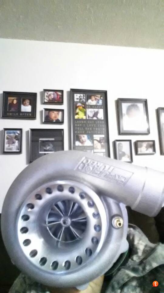

You guys post as many pics of the kits installed as you want! Show those bad boys off!
