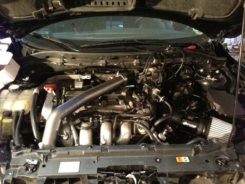

So after starting my purchases for my turbo swap all the way in October of 2012, I'm about to get everything installed this upcoming weekend. Main reason I went with the BNR is due to it's stock fitment and provides more than enough go for a daily driver/commuter.
I've already checked my parts list with @S-hendrix, who has installed practically all the same mods I've bought. You can say his car was my inspiration to go through with the entire build. Anywho, below is a list of all the items I've purchased over the past 5 months. Please let me know if you think I should consider something else before we get this ball rolling.
BNR S3
SURE Full 3in SRI
SURE Return Tube
COBB FMIC
COBB XLE BPV
Ultimate Racing Metal Catted DP
Ultimate Racing Resonated TP
Manifold-Turbo OEM Gasket
Turbo-DP OEM Gasket
SSP Oil Feed Line
BOSCH 3 Bar MAP
Ebay MAP Plug n Play Connector
Grimmspeed EBCS
Autotech Internals (to replace my KMD v2.1)
Gaurdian Angel
CP-E Safe Seals /w studs, nuts, and washers
JBarone OCC
JBarone EGR Delete
JBarone TIGs
Intake Valve cleaning crap
10 ft of 4mm silicone hose for EBCS
New set of Denso Iridium ITV22
Perm Tune - @atvfreek
I'm sure I'm forgetting something. I'll try snap some pictures of all the parts soon enough.
Update: Just a few pictures from the install. Everything turned out really well.

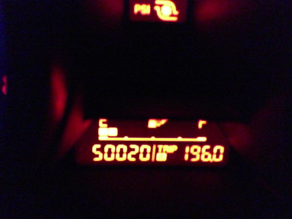

just rolled over 50k... Eeek!

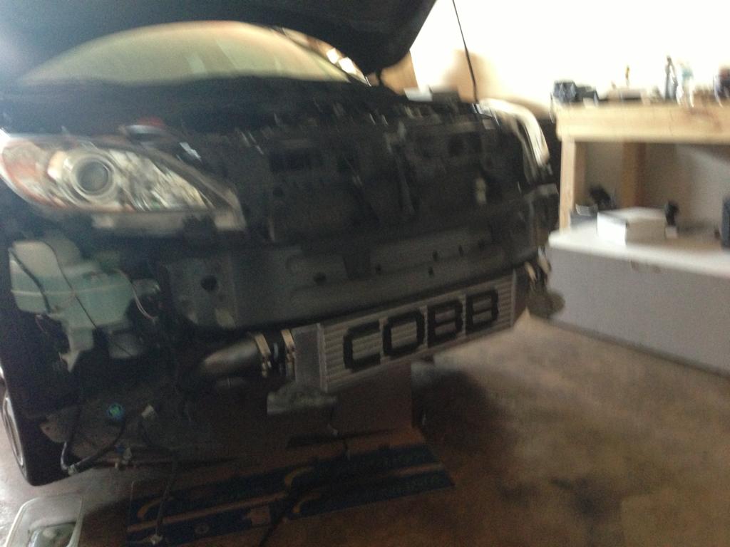

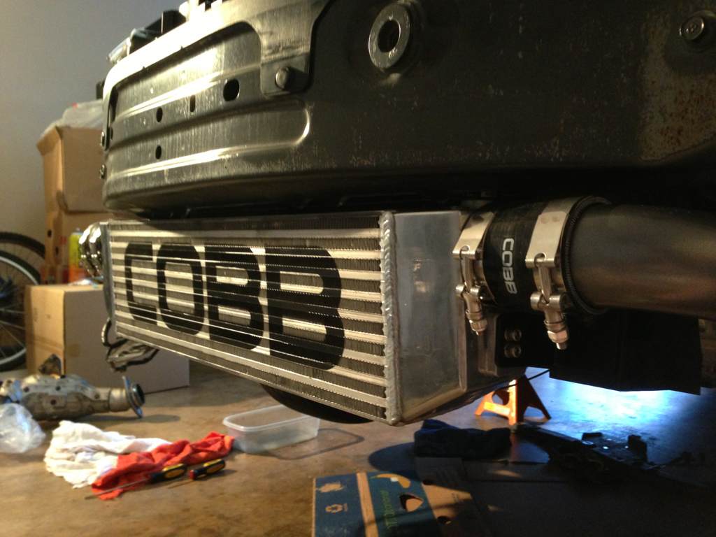

FMIC looks good. Looks like you guys are getting there! Keep on rockin it!

Alright guys, here everything got in there. Here is the first start video:
Austin's BNR S3 First Start-Up - YouTube
Enjoy

As Randy said, everything is on and running well. No major hiccups during the install. FREEK base map is spot on. I'm so excited to see what kind of power ill see.

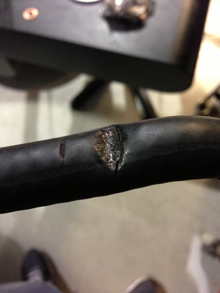

Only issue with the entire install was the coolant hose rubbing against the exhaust manifold and leaking coolant.
After sitting at the Kozmic Motorsports (formerly SSP) for 6 or 7 hours, we also figured out that the banjo fitting that BNR sent me was one size too small and that the crush washers are getting crushed unevenly. I believe that either means the threads are drilled at an angle or the fitting is not right. We did not over tighten the banjo bolt or strip the threads. So now I'm waiting on BNR to send me another banjo fitting and new crush washers to see if it will fix it. Anybody have some thoughts or any experience with this sort of issue?
