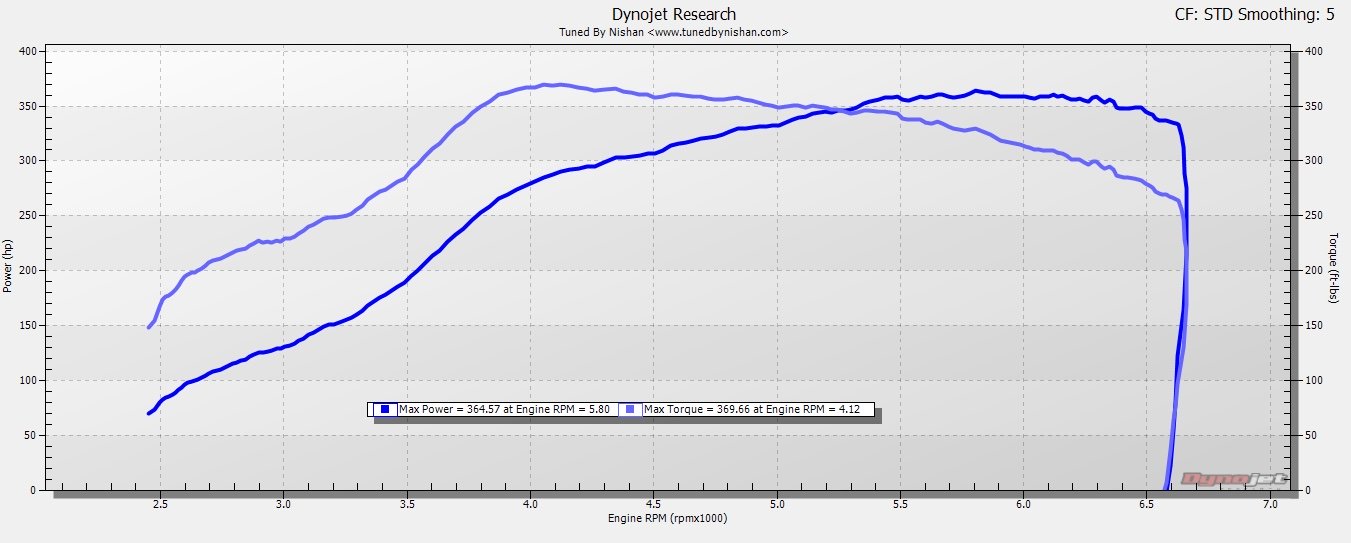

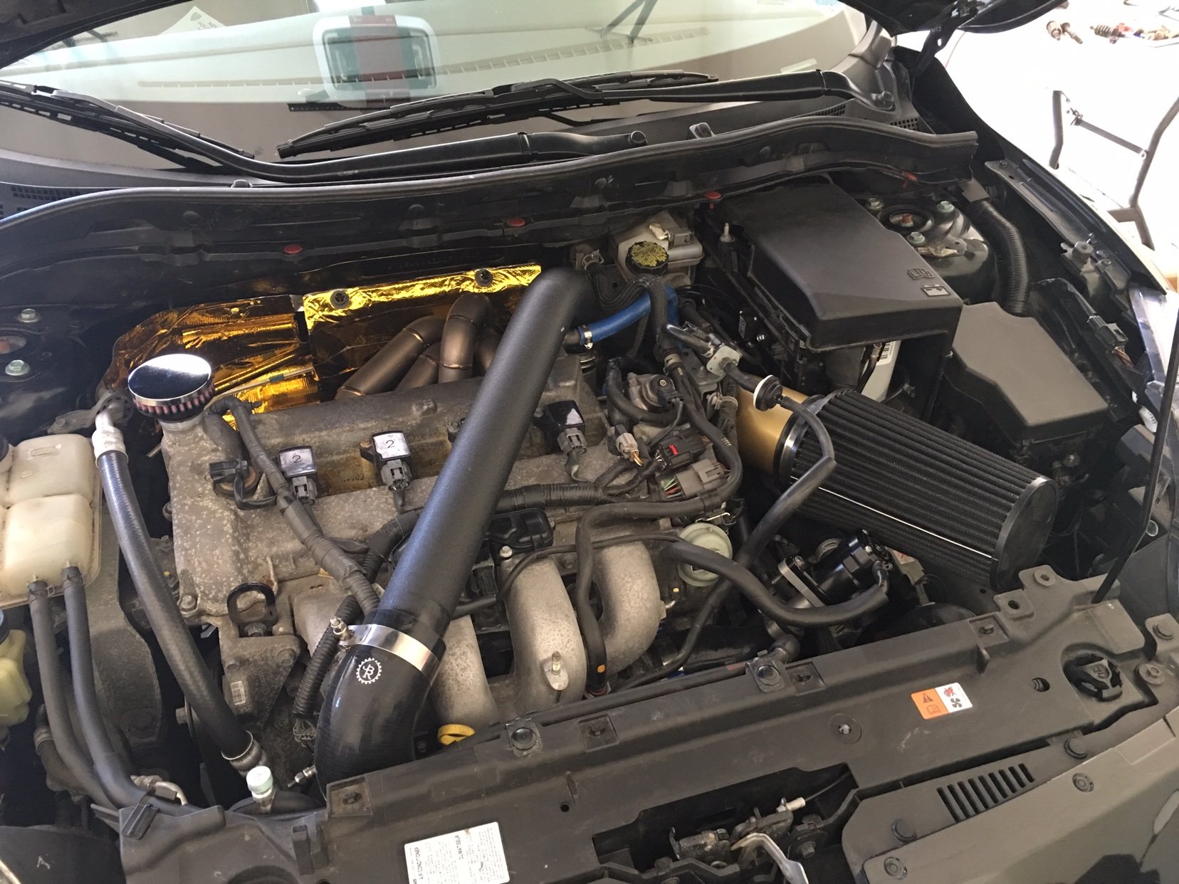

I joined the forums a few years ago and haven't posted to often but I just completed my BNR turbo build so I'm deciding to share . Been gathering parts over the last year and half and decided to just do it all at once. Anddd here's the list...
BNR S4v2
Xs power v3 mani
eBay downpipe
3 inch catless single exit exhaust
4 inch intake
Tr8L front mount w/ JBR piping
GFB bpv
3.5 bar map
Grimmspeed ebcs
On 93 oct..
The good stuff

What r the numbers..?

Would you mind sharing details of the tune? Ie. Boost, AFR, and ignition timing These are the numbers I want but feel I'm limited by my Cnt catted dp and stock catback.

Must have pretty large goals in mind using a 4" intake. Come on...spill the beans.
Must be planning on adding a procharger in the future to twincharge this monster.
In all srsnss this build is pretty dope. Once I get to the point of bigger turbo I'll be doing at least an s4, 4 inch intake and turbo + intake mani. A man can dream... A man can dream....

@ 21 psi. #tunedbynishan
Haha all good. 4 inch because you never know what comes next? 🤷🏻—♂️Meth for sure...

Where did you purchase that intake? Also those are some awesome numbers for pump gas!!
Thanx broski

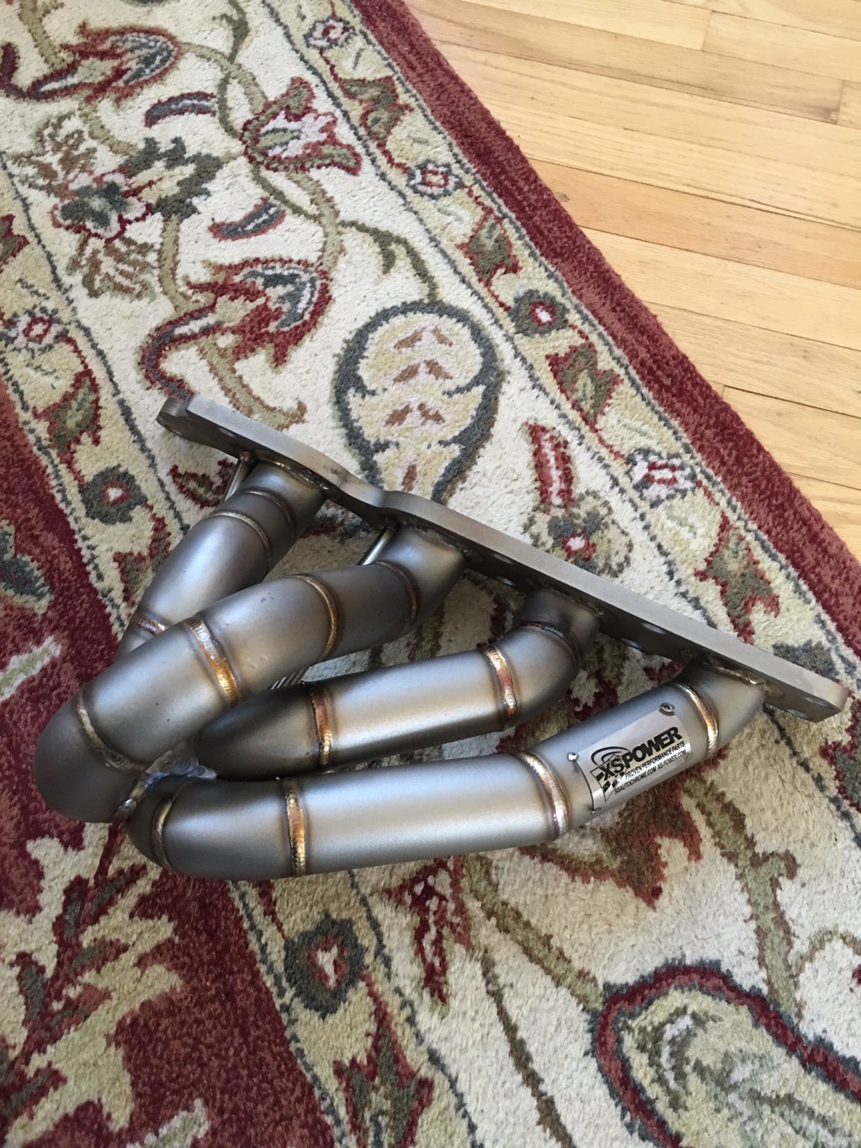

How much you make on your set up? How's the ex mani holding up?

And its working great, Before i put it in, i had an Wastegate brace welded on to strengthen it.
Ex mani by the ewg are known to crack? Definitely interested to see the final tune
