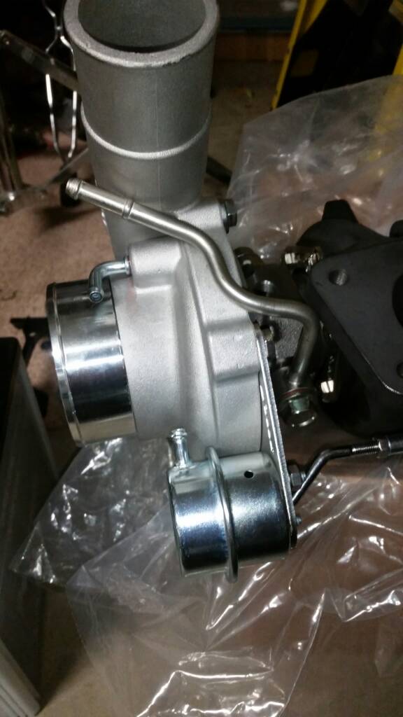

BT acquired! Can't wait to get it all installed!
Now off to search for some install tutorials.

This feed line look too short...almost like it's for the S3.
