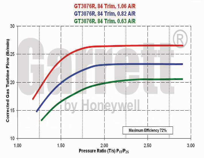

As far as I know, 28 frame wheels are somewhat more efficient than the 29 frame, but flow less.
Gt28 - 68% max efficiency & ~20lb/min corrected turbine flow for the large a/r housing (0.84)
Gt30 - 72% max efficiency & 20-26lb/min corrected turbine flow for the 0.63-1.02 housings.
But- gt29 - 64% max efficiency & 20-24 lb/min corrected turbine flow with the 0.63-0.84 housings
So, yeah, the 29 frame flows similar to a 30 frame, but is less efficient than either the 28 or 30 frame. I don't see how it would out preform a small housing (0.63) 30 frame, given the drop in efficient flow.
Then again Honeywell/Garrett engineers are smarter than I am, I'm just not seeing their intentions here.
